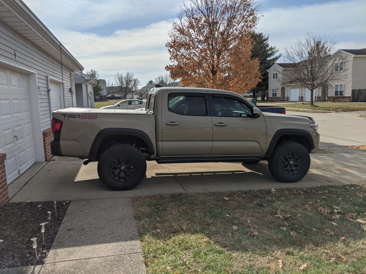

    Like mentioned already, it's really up to you. There's lots of pics around here you can look at. Hard to answer for you what the perfect size is.
    Personally, I lifted my truck about 1.5" all around. Then I added 255/85/16s so I'm right around 3" overall. To me, the tires look perfect even with a small lift like that. I've also added 1.25" wheel spacers just to push them out a bit... No issues with rubbing or anything yet.

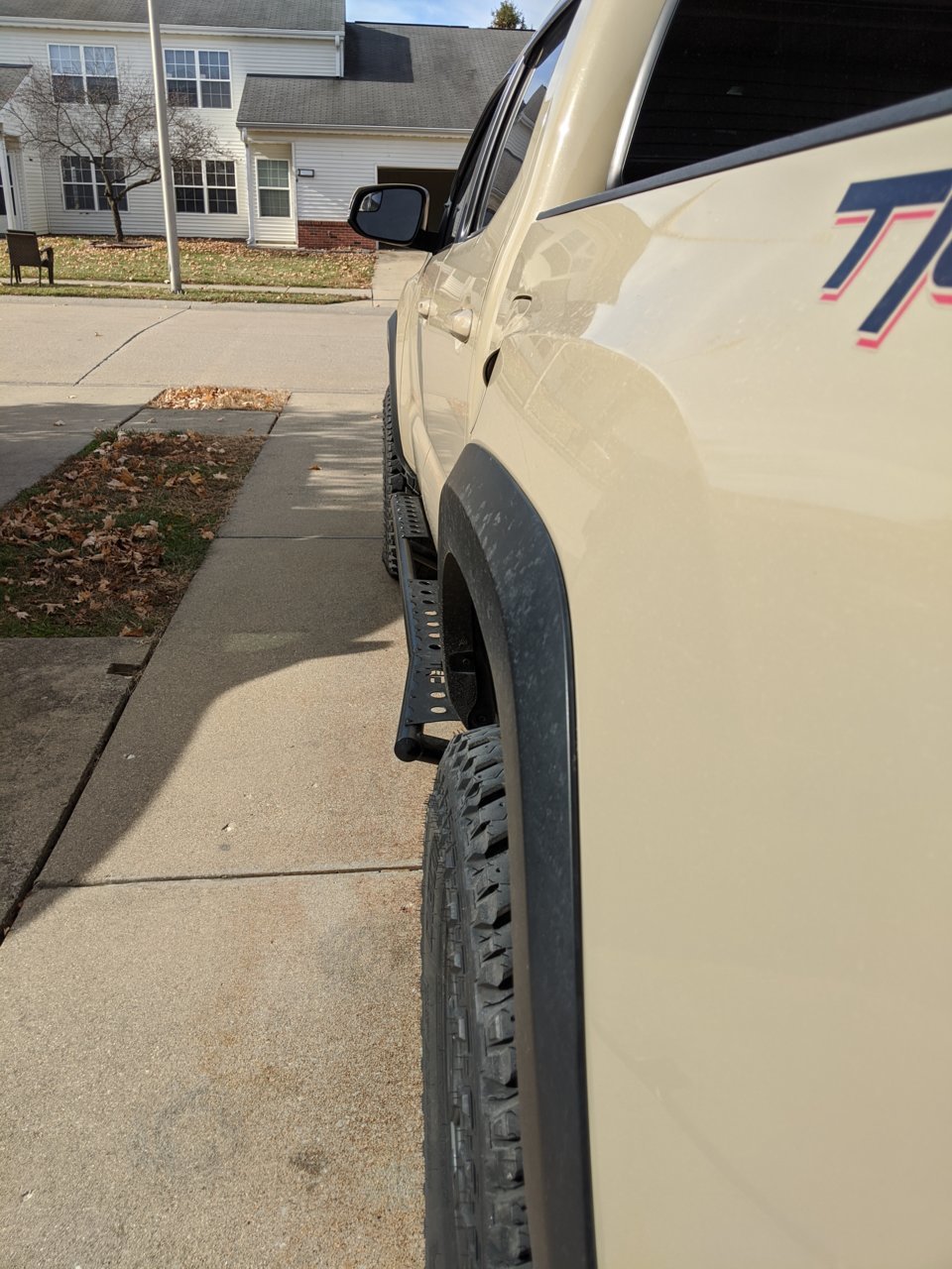

    What did you go with for your lift ? Got any pictures ? Thank you !

    May 12, 2018
    #253303
    214
    David
    Scott AFB, IL
    2018 Tacoma TRD Off Road
  11. Dec 5, 2019 at 11:31 AM

    robie_0n3
    robie_0n3 Well-Known Member
    May 12, 2018
    #253303
    214
    David
    Scott AFB, IL
    This is what I'm using.
