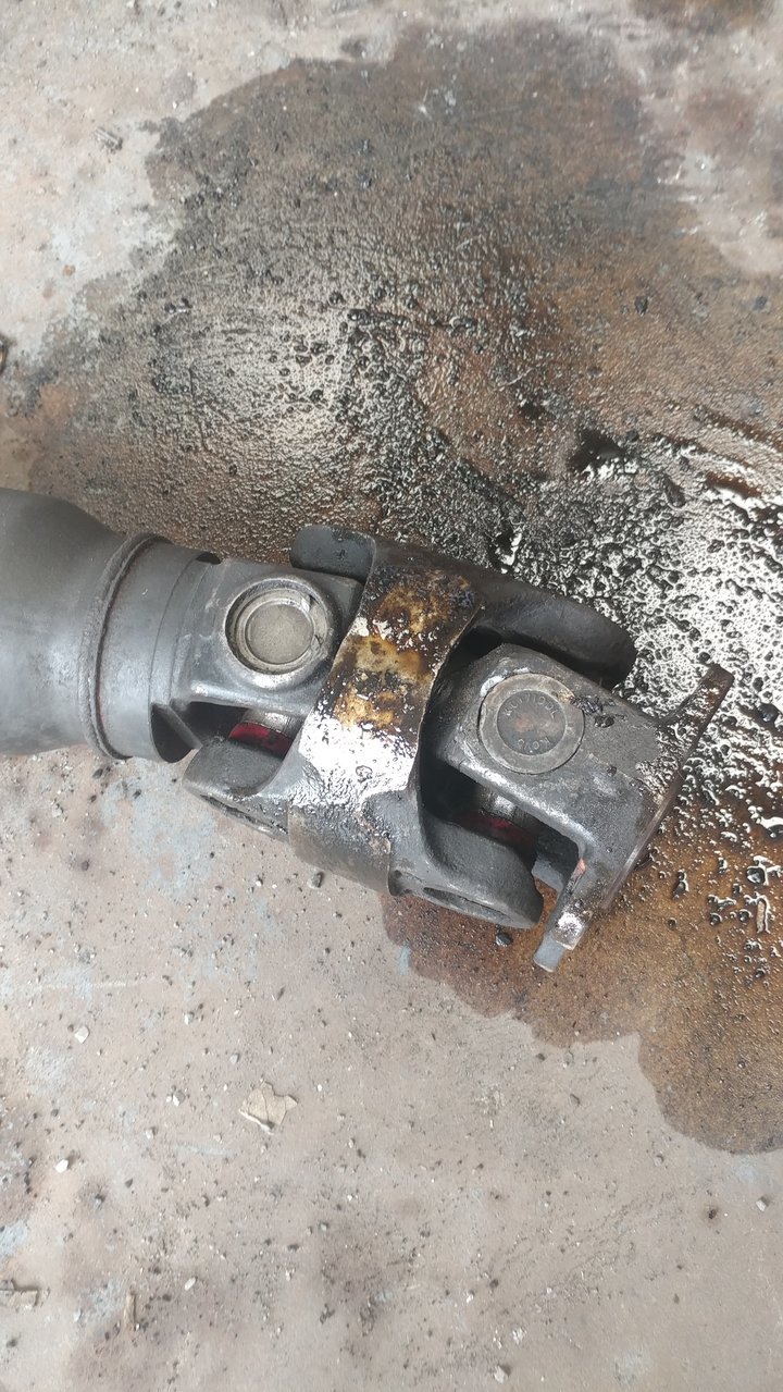

  9. Nov 21, 2017 at 6:43 AM

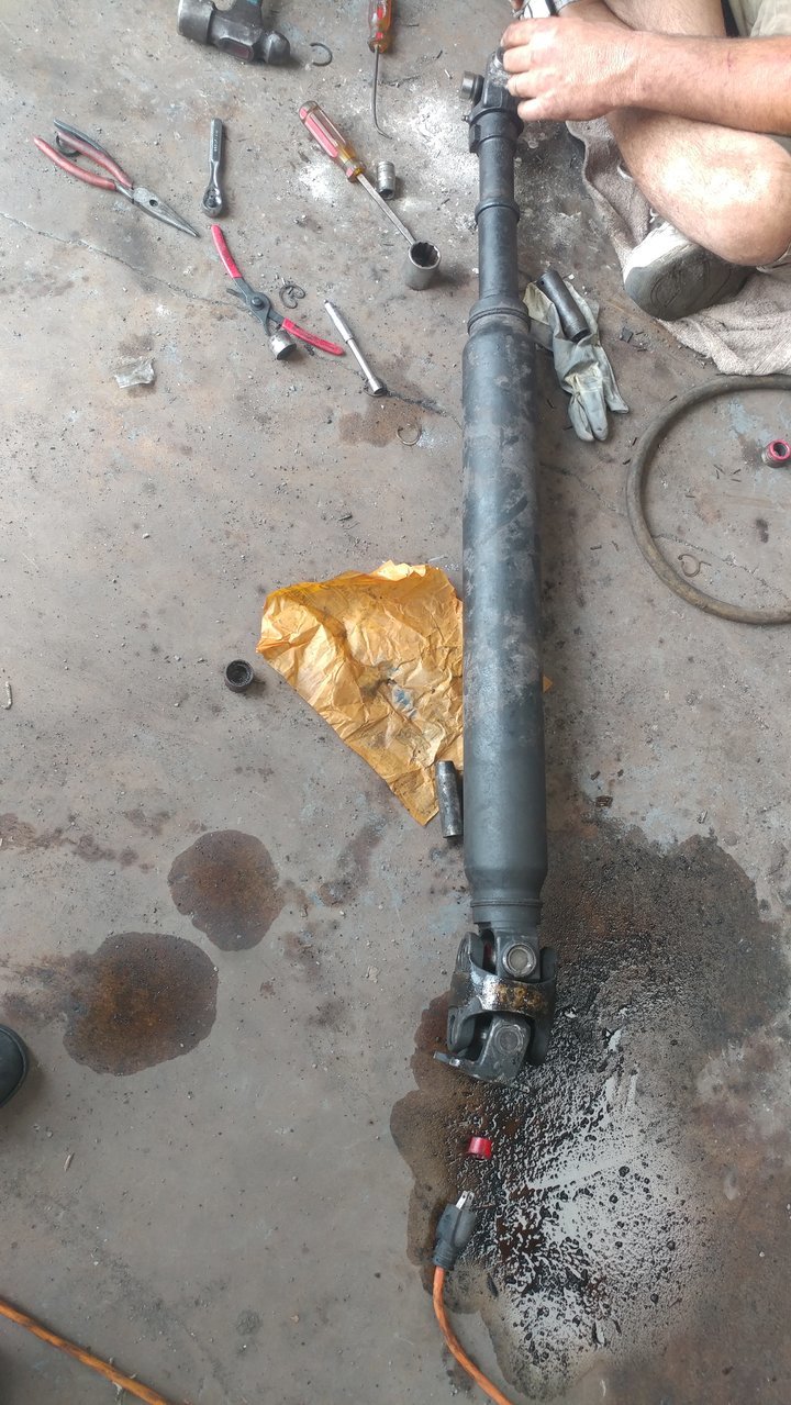

    yup has a carrier bearing, and doesn't look like there were any markings to put it back in the exact same position.

    Yes the top picture is of a double cardan joint, there are two u joints in it as well as a centering ball. Unless you are absolutely sure one of those components is bad, I wouldn't start taking it apart.
    There is a writeup on here about replacing those components, I will see if I can find it.
    The rear u joint that you have apart is a common size, it is the same as the front u joint at the transfer case and both u joints in the front driveshaft (if you're 4x4).
    You said you're a single cab right? I was under the impression that all single cabs had a one piece driveshaft with no double cardan joint, perhaps I am mistaken.
    Edit: read through this thread, lots of good info:
    https://www.tacomaworld.com/threads/double-cardan-joint.273119/

    Is that a shop? Or some guy's garage?
    Either way, it'd be a good start to not disassemble those parts on a dirty/oily floor. Maybe get that electrical cord out of the oil, too..

    Yeah your mechanic's shop looks a little sketchy.
    If it is just a problem with the rear joint, he might have just got a bad one. Hopefully replacing that will take care of it. I really hope he didn't screw up the double cardan joint.

    he probably didn't realize they were different. I was told that the front and rear u-joints were the same and the 2 near the carrier bearing are the same. You can verify that by the way they were installed and the location of the c-clips.

    What? That’s not a carrier bearing lol

    it attaches to one, the shaft he has in his hand bolts to the carrier bearing and to the rear diff.

    On a single cab? Single cabs don’t have carrier bearings

    That’s def not the correct shaft for the truck. Looks like some hack made to fit the truck

    That's what I thought too, not positive though. That looks exactly like the rear half of a two piece driveshaft. I suppose the DC could bolt right to the transfer case output flange. Maybe its single cab 2wd's that have the solid DS?

    If the single cab didn't come with this particular axle than something ain't right unless this isn't a single cab but that shaft thats in his hand looks exactly like what I took off of my double cab.
