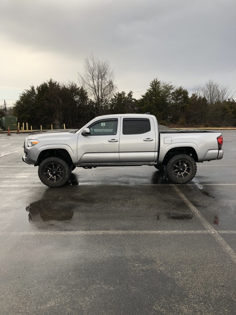

    63122740239__8921446E-15CB-43ED-8E3B-DF0F1DBEA4E6.jpg Here’s my 3rd gen. 2020 SR5 2.5 lift. I’m wanting to get looking like this on the new one

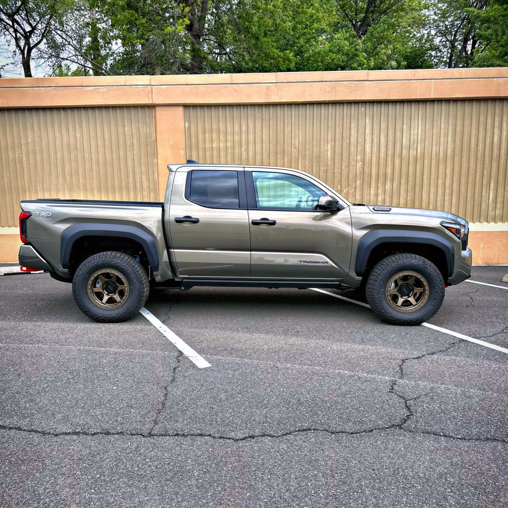

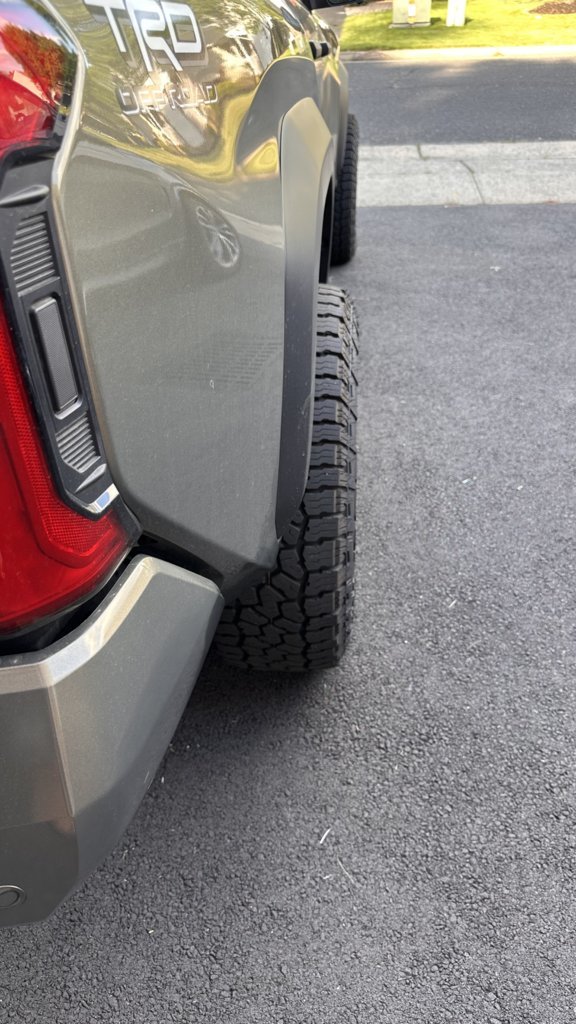

    How much poke are you looking to achieve? 285/70/17 tire size on my zero offset wheels pokes about 2 and a quarter inches.

    That’s about what I’m looking for. I’d ideally like one tread band out past the fender flare.
    what wheel and offset do you have.

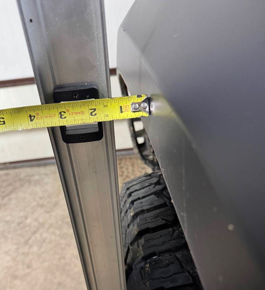

    Here is +25 with 285/70R17
    Taco Ji and DavesTaco68 like this.

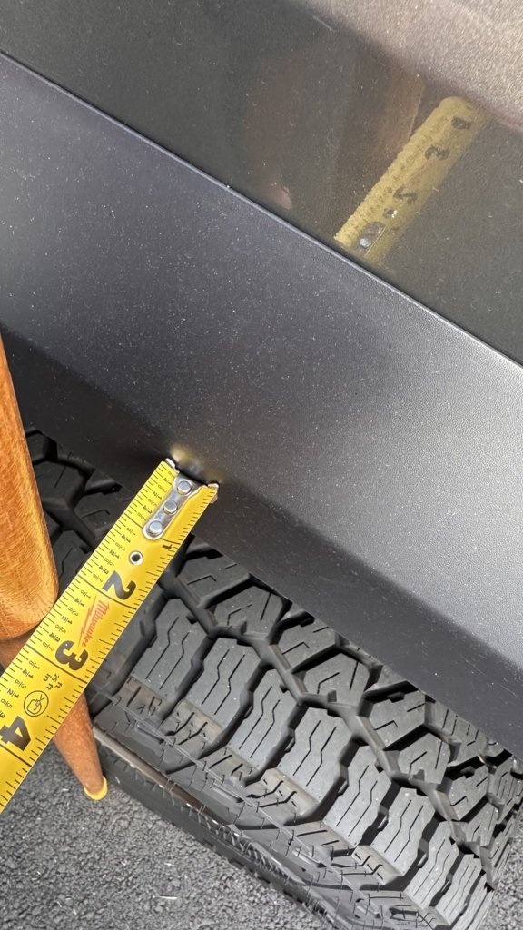

    Here's bunch of pictures showing +25 offset wheels...
    Stringburner likes this.

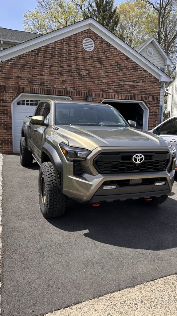

    Your guess is correct. No issues with 17” wheels. I wanted beefier tires so I went with 17” instead of 18”. Also finding tires with 17” is easier.

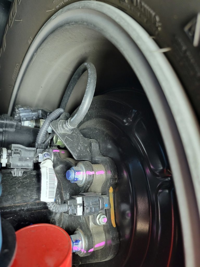

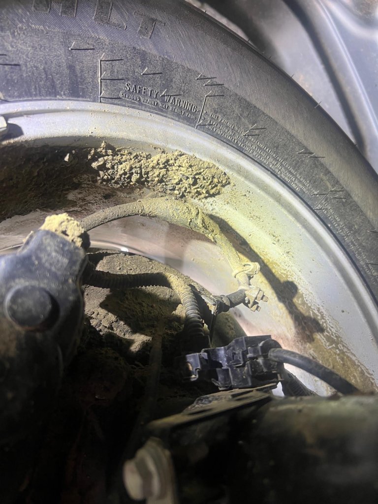

    I thought i saw an issue with 17's collecting mud inside the wheel and shredding the rear brake hose?

    I think those were 2024 models. Mine is a 2025

    I see they issued a recall on it now should post a picture of how yours looks id be curious on the redesign as that initial set up was a joke.

    I’ve been in some ugly stuff a couple times and the brake line survived. TSB say it MAY happen. New brake lines should be available this summer?
