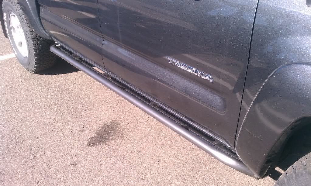

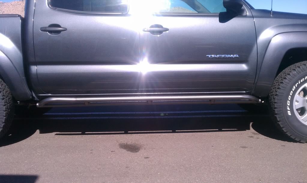

    Rock Sliders Front Light Bar +1.5" Front Arms with Ext. Kings
    All Terrain Fabrication in Yucca Valley did mine. Mark does great work. They will run you about $500. He will build them however you want.

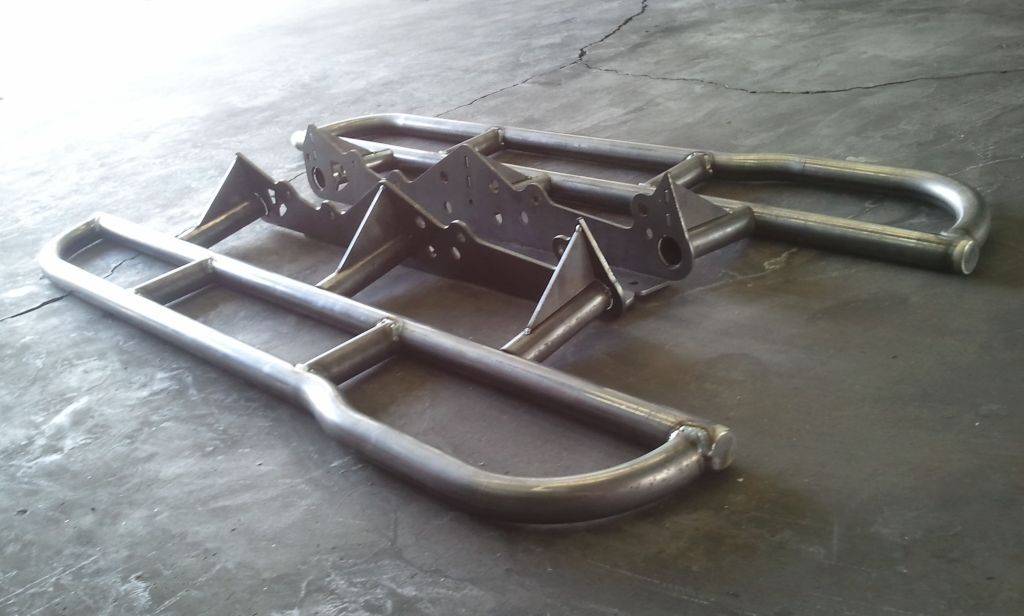

    Check out trail gear sliders cheap for the bolt on ones and are so heavy Dudy. Btw I bolted mine on just for the lower holes and welded the tops because drilling 6 holes per leg is not desirable . You can't get bolt on sliders with out having to drill several holes and eat bits. Just buy the weld on ones and find a shop to weld them.

    The All-Pro sliders require the least amount of drilling. However, as a byproduct, the bolt holes are not in the most optimal locations, requiring the large doubler plate. The All-Pro sliders are therefore slightly heavier than CBI, Beefed Taco, etc.
    Bolt-on sliders can be more secure than weld-on sliders, because the 2nd-gen frame is double-walled. Welding would stress only the outer wall, whereas bolt-on spreads the load more evenly across both walls.

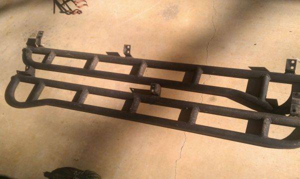

    4x innovations make a real good set. Just make sure you order the right size lol. I was caught up in the jubilations of buying tacoma stuff and orderd the wrong size, as you can see here we had a little work before mounting.
