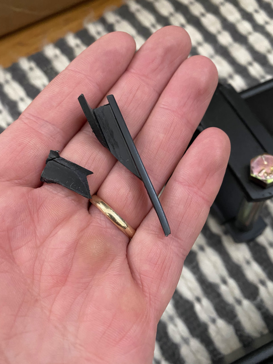

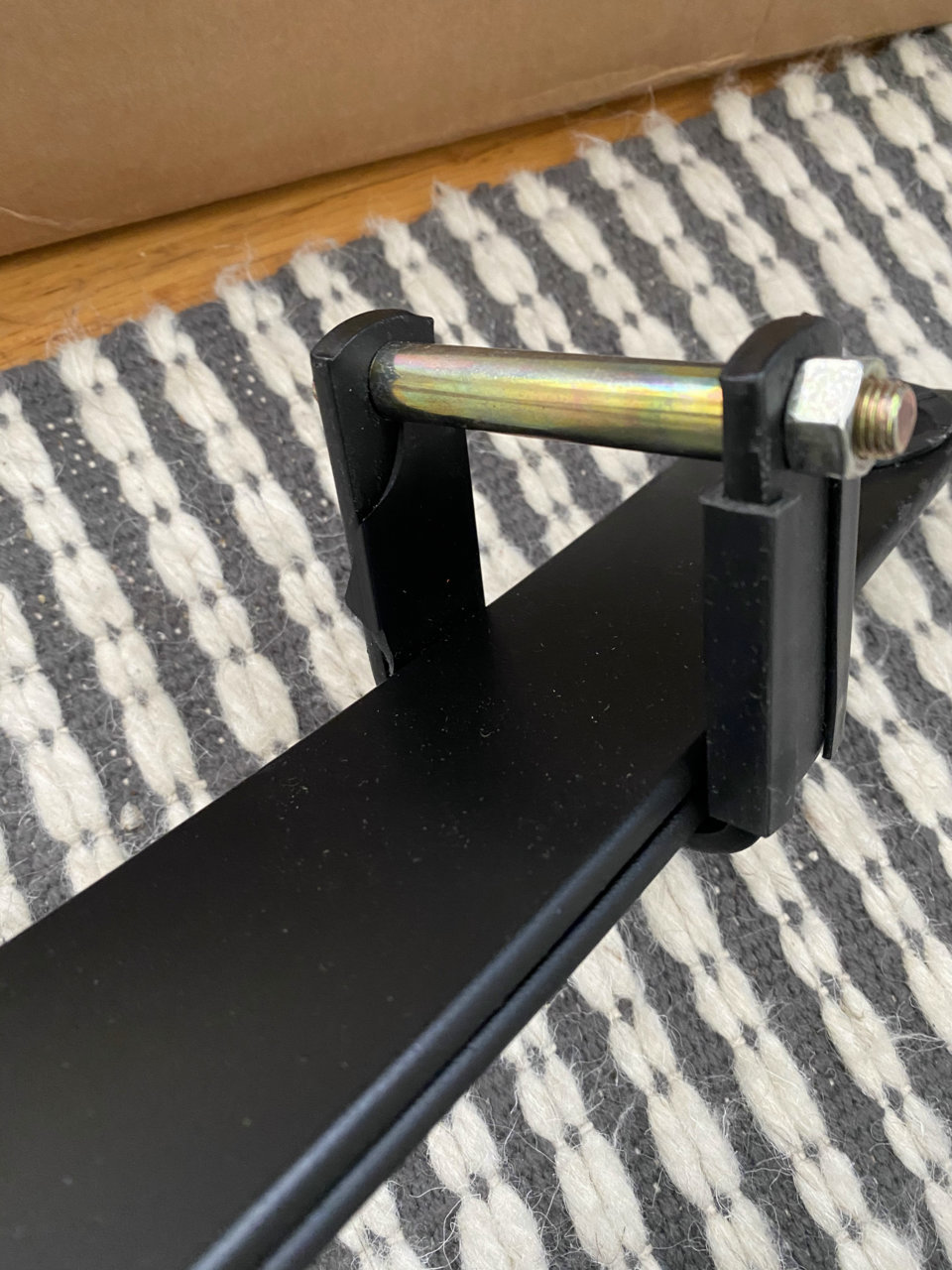

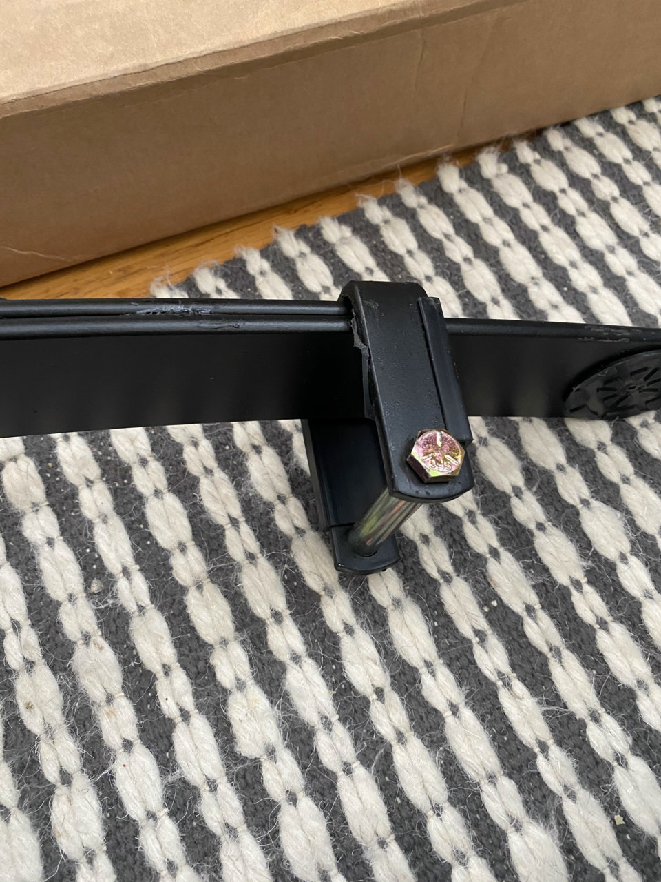

    I also just upgraded to 255/85/16s and while they're great on my stock SR5, i'll be going with Bilstein 6112s and 5160s as my next upgrade. 1.5" lift in the front and 1.5" add a leaf in rear and OME UCAs. Quick question for you. I was unboxing my add-a-leaf kit and one of the plastic guards was partially cracked off. You think this is a big deal or not?
