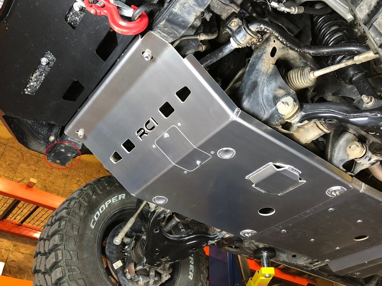

    Hi all, I'm new to the forum. I just purchased a 2020 OR and I'm trying to get a minimal amount of armor to help cover me since I'm such a novice. I've ordered RCI sliders and skids and now I want to add a front recovery point (I've already purchased a receiver recovery point). This one looks nice and affordable:
    https://www.bpfabricating.com/products/tacoma-recovery-tow-hook
    My question is... will this work with the RCI engine skid plate here?
    https://rcimetalworks.com/product/2016-tacoma-front-skid-plate/
    From the picture it doesn't really seem like it would but from what I've read that skid doesn't require removing any of the factory tow or tie-down points and I think that's what the BP point uses. Does anyone know?
    If not, do you have other recommendations for front recovery? I'm not interested in a front bumper yet since I think I'd want to wait until I could upgrade my suspension as well and I want to keep it as close to stock as possible until I get really comfortable.

    It looks like those mounts are compatible to me. If I'm looking at it right, the BPF recovery points attach to the three bolt holes shown in the RCI pic below (where OEM ones are located):
    However, the pic on the BPF site makes them look like they might be mounted more centrally.

    As far as I know, the ARB is the only point that actually has a weight rating and connects directly to the frame. All of the others seem to only connect to the subframe which is nothing but 2/3 weldnuts inside that boxed piece of thin steel. (the OEM OR hook or it's aftermarket replacements)
    Downside to the ARB is the installation isn't super easy, weight, and it reduces your front approach angle a bit.
    https://www.tacomaworld.com/threads/arb-rated-recovery-point.493245/page-7#post-20453144
