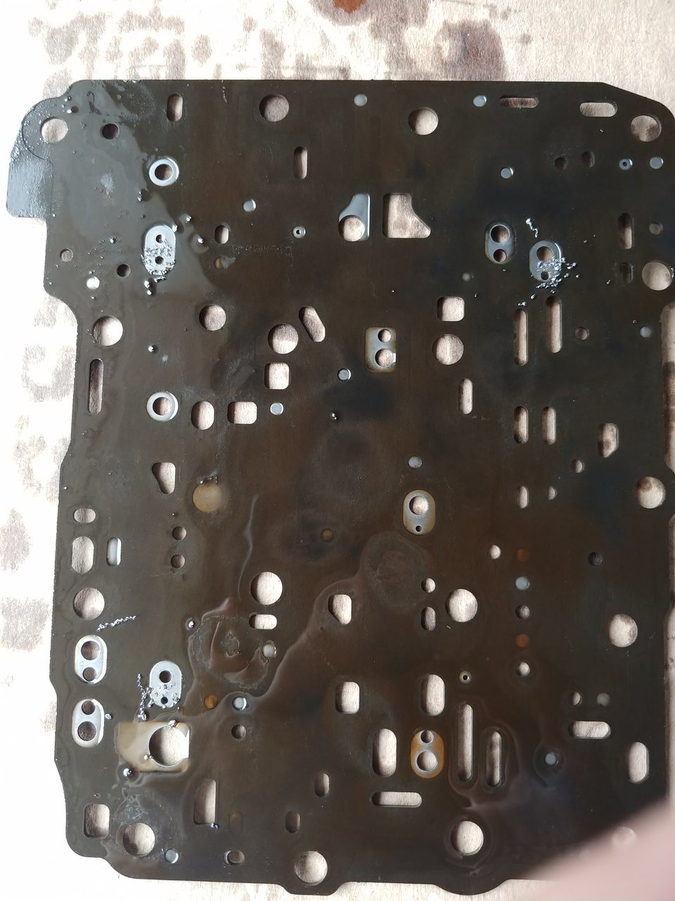

    @gearcruncher you know more about these transmissions than probably anyone else on this site. I feel you would be the best person to give them a call and pick there brain on it. I would get lost in the technical banter.
    jojotoo likes this.

    Original post updated to include picture of actual top plate that is drilled out.
    gearcruncher and jojotoo like this.

    you mind taking the whole thing apart and videoing you putting it back together? :boink:

    If I ever get a spare valve body to work on, I'll try to accommodate your request.

    I would be able to do that. I was working on my spare valve body today.
    I had a spare transmission that I thought the clutch packs were going bad cuz it was slipping. So I use the valve body out of that one and when I installed it today took it for a test drive and it was slipping and 2nd gear I would have to manually move it to 3rd gear so it would shift then I put it in 4th gear and then back to drive. On the highway it doesn't want to shift past third gear. So tomorrow morning I will be tearing it apart and removing the plates from the bad valve body back to the one I took out today that I know works. I'm thinking the solenoids on the valve body that I had modified are bad.
