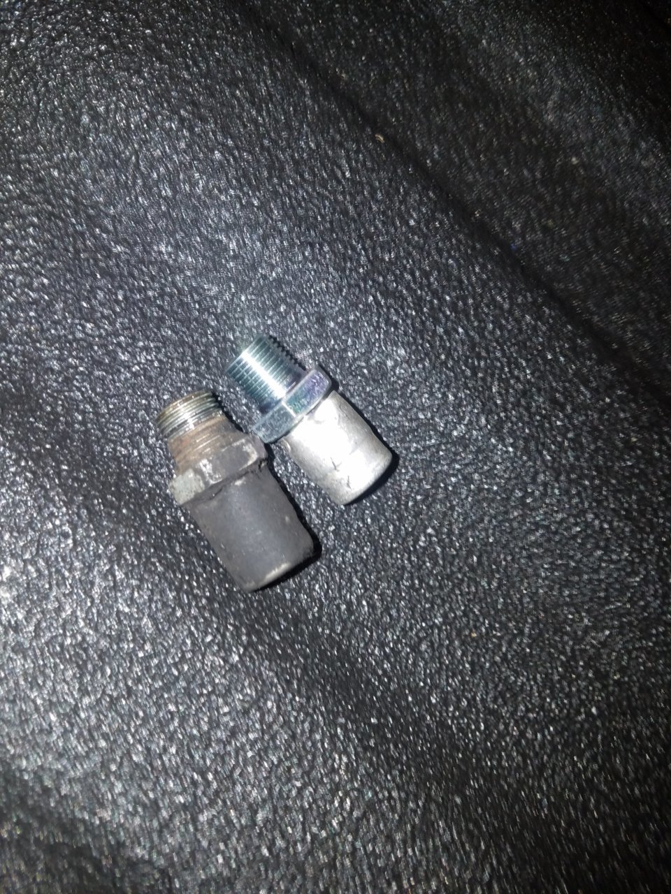

    The rear differential release pressure valve is an item that can get stuck closed from dirt, mud or rust.
    If this happens you have a great chance of having your rear axles seals getting blown out from heat pressure.
    And that means new seals and bearing running 1000.00 or so if the dealer does it.
    My valve was stuck shut from dirt and my rear axle seal blew out.
    Had I taken the time to check it and or replace it at the cost of 12.00 I could have
    saved myself a lot of money and headaches
    Take a few minutes to see if your diff valve is working or just get a new one for 12.00 if
    you have a lot of 4x4, mud or dirt miles or rust on your truck.
    It’s takes a minute or two to remove it and clean it.

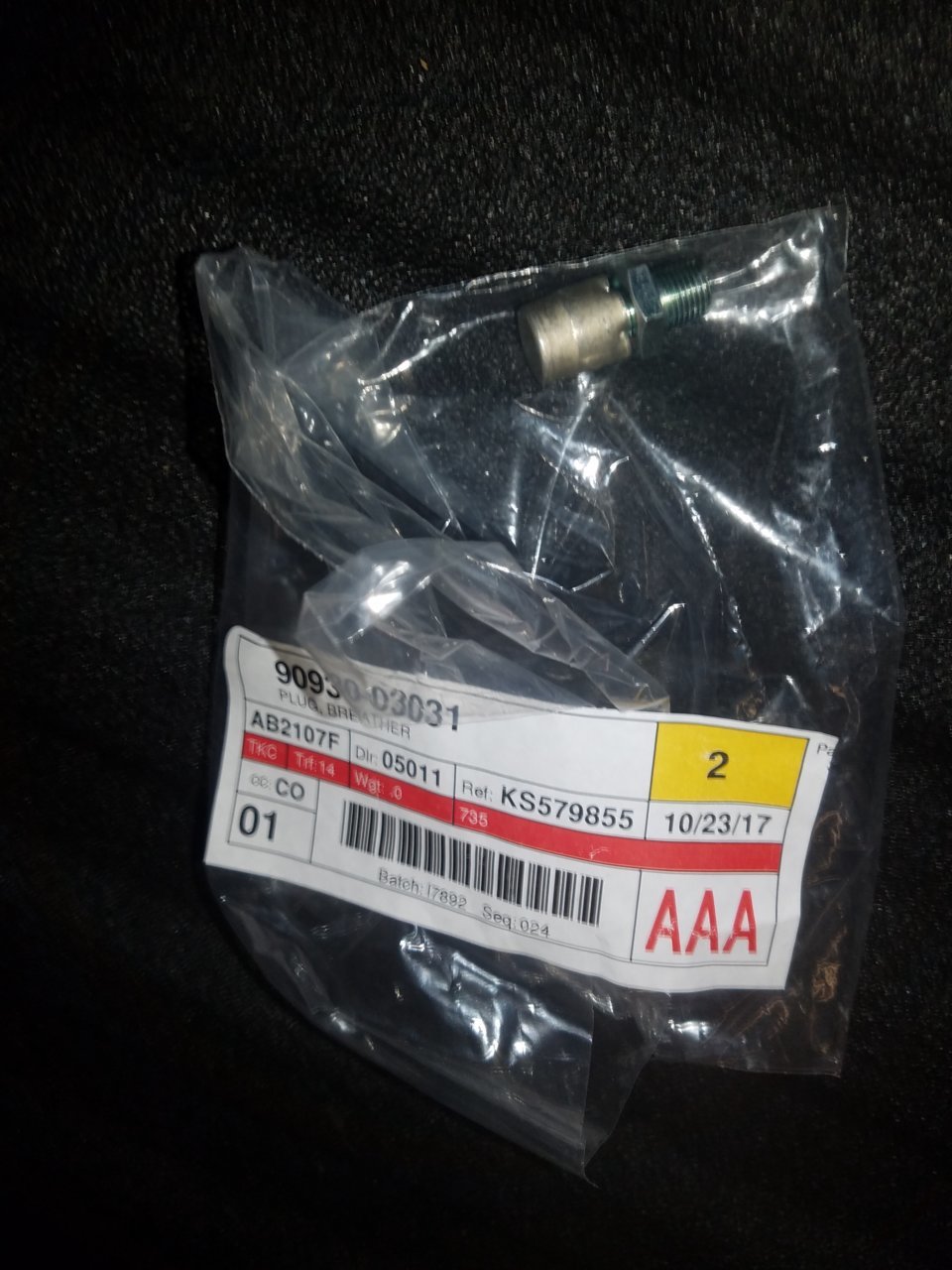

    9093003031 / 90930-03031 - PLUG, BREATHER (FOR REAR AXLE HOUSING) - Toyota OEM

    I searched for that part number on Amazon but it didn’t pull it up

    Just purchased one thanks again

    I would just like to add, to see if it is working, just push down on it with your finger. It should move freely up and down.

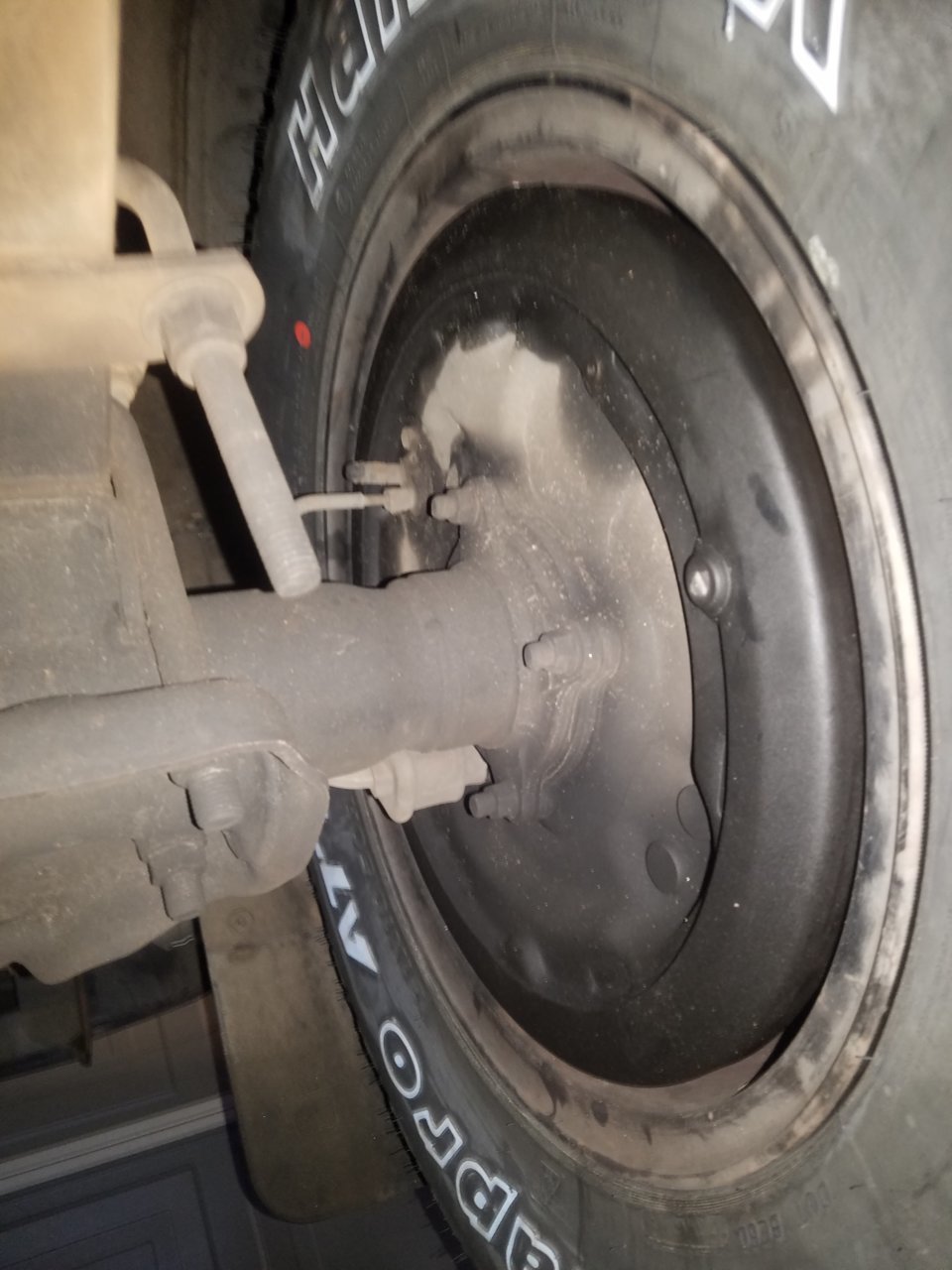

    Some how I got lucky with this rear axle seal leaking.
    I replaced the breather valve and the rear seal stopped leaking!
    So I cleaned the brake drum and shoes and The Whole area
    I must have gotten lucky for now, I’m guessing the pressure was pushing the seal open and then returned
    to it’s original location after the pressure was released.
    Now I get to return 250.00 worth of parts, gaskets, bearing, seals, shoes to toyota now.

    If gear oil was leaking past the axle seal, that means it was also leaking through the sealed wheel bearing and would have displaced the grease inside. Your wheel bearing's days are numbered, I would keep all that stuff as it'll probably start howling soon...
