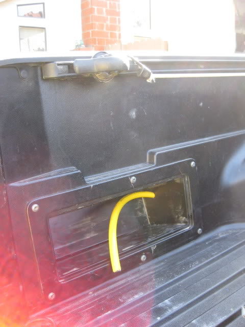

    In my thread on the diff breather mod, I put the real breather in the side compartment of the bed. 5 ft. of hose was enough, I recall... That was 6 years ago, see my thread (link in my sig).
    Edit: Here was where the 6 ft. hose ended, before I cut a foot off of it:
    Kidsndogs[QUOTED] likes this.

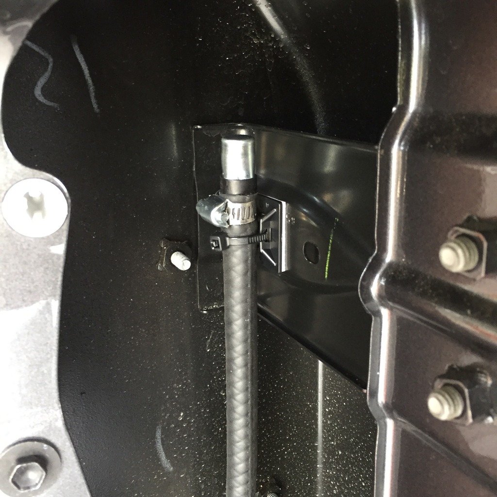

    Couldn't have been easier, maybe took 20 minutes. This was a great thread I'm glad I read it, just need to bolt up with a clamp once i get a bolt and nut instead of using the zip tie.
    DE95D364-F740-46F6-89F1-76D5154087A8_zps_48d25d85c80f8606c9b766006dc7f93d39fa83b1.jpg
    F2FA8591-BBB6-4B5F-9207-C0E7D58ADF1E_zps_6d898cc7e688eab32f65a1316ef142d506d08e39.jpg
