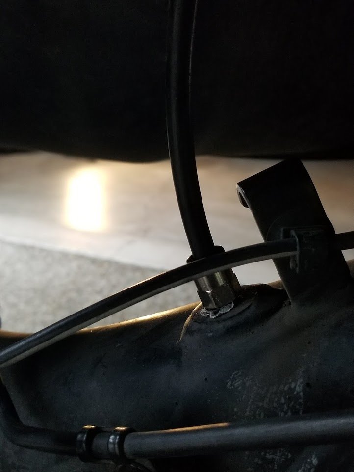

    I know this is an old post, but I did pretty much the same thing w/ letting my hose just droop down from the frame and was wondering if you had any issues down the road w/ that set-up?

    The issue is how much droop and how does it droop? Is there enough slack for when the suspension fully flexes? Will the breather hose catch on anything?

    I am pretty confident that there is enough droop for the suspension to fully extend. I guess I'll just have to watch it to make sure it does not catch on anything. It ended up a lot like this one:

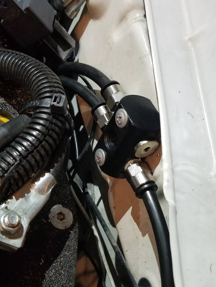

    i used 6' of tube when i had mine and it never had an issue. recently changed out mine for a arb to consolidate all the breathers.
