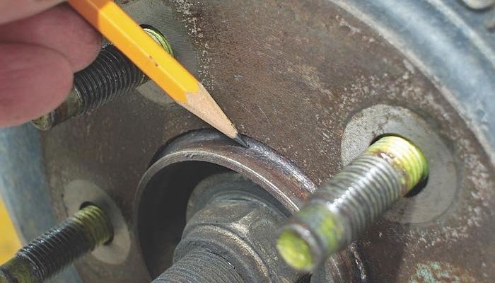

    Your truck is around 5 years old, the drums probably hadn't been off in a while.
    It you pull the drums and do a break inspection/clean up/adjustment annually they will pull off easily enough.
    With the drum removed a tiny bit of high temperature grease applied to the flange area indicated below makes removal next time easier. Again, just a tiny amount, only a extremely light film of grease is required.
