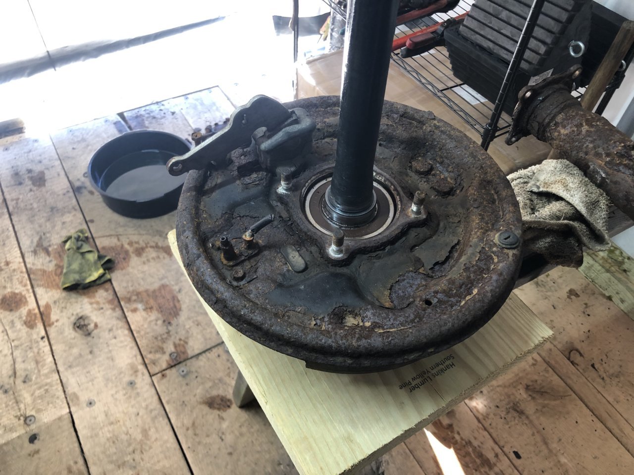

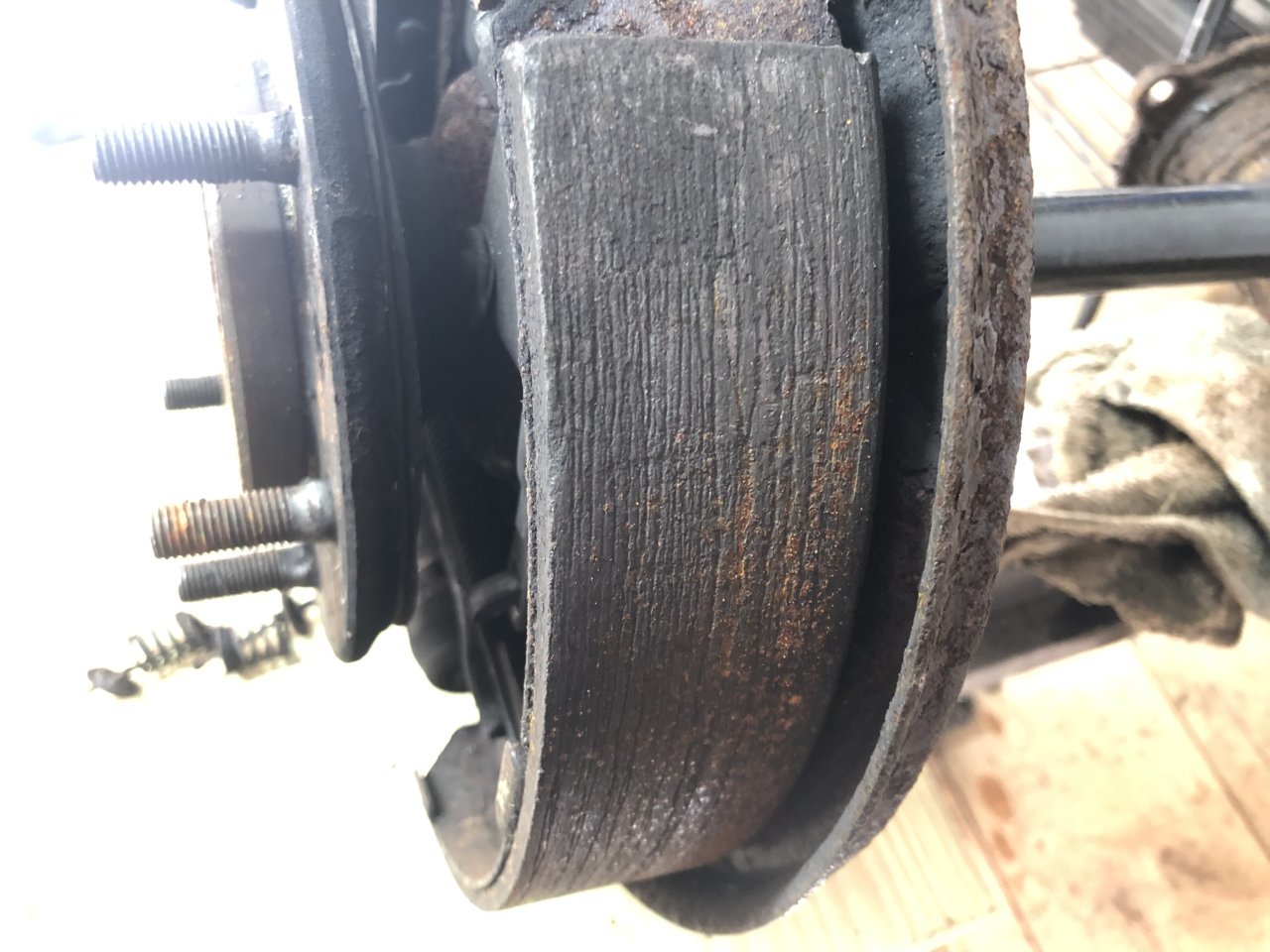

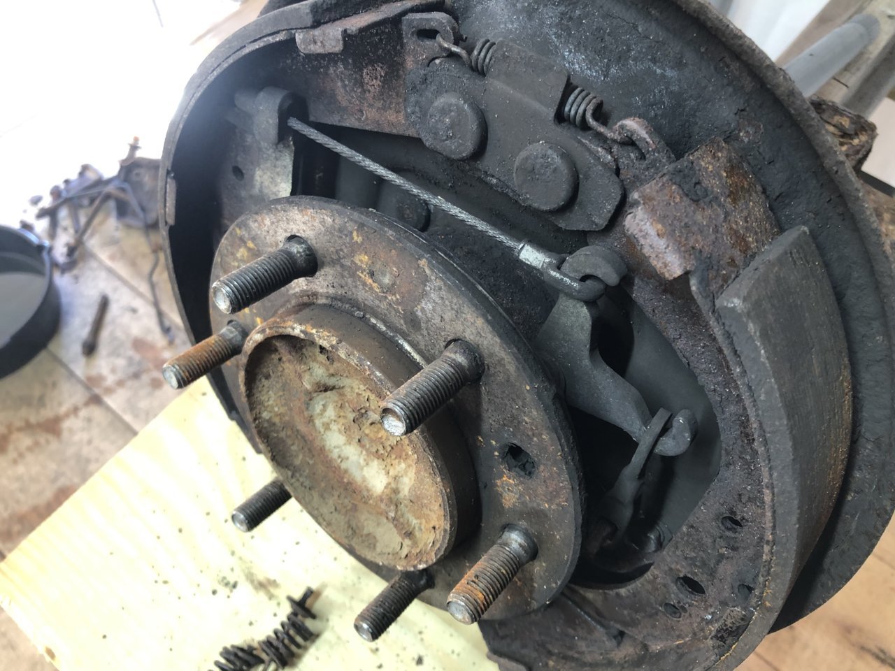

    #1 - What should/do I need to buy for the rear brakes. Both sides need drums atleast due to cracking. Springs fell out of it while taking the drum off so.. Is there a complete kit that comes with all of the insides? Or is the backing plate too far gone in your opinion? 75AB9D13-CEBE-49DD-91F0-9EA874FB533F.jpg 8254AE81-C698-4892-BCB4-3B4714A5C754.jpg

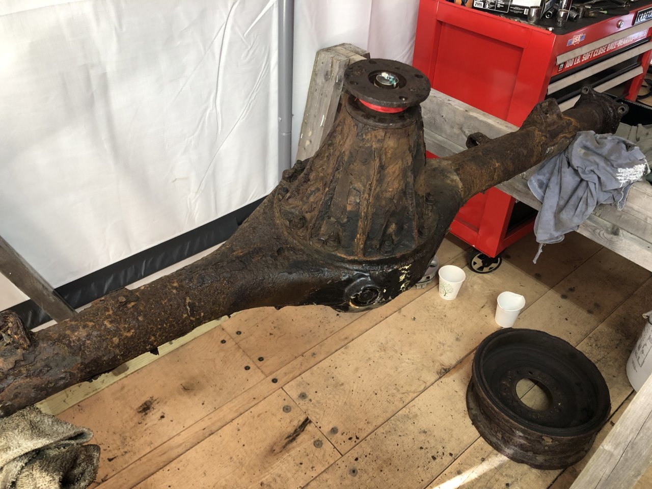

    #2 - I have not looked but I am hoping there is a guide to swapping internal differentials/replacing that I can use for what I need to do. But, is there anything I need to know before I do the job? I don’t know how it comes apart but I hope easily. Should I order any seals for the rear differential. 1CBBC98E-3F6F-4CF2-93B5-CF6354B3CC38.jpg E9E2D4EE-D8F5-4A90-B4D8-DFCC3FA1FA89.jpgI heard people say stuff like keeping the position of something the same before and after or it will not drive good anymore.. which part 1CBBC98E-3F6F-4CF2-93B5-CF6354B3CC38.jpg

    A lot of that looks beyond restoration.

    It's the driveshafts that should be marked before removal.

    Nothing is impossible, with time and money (Plus good input) from the fine folks on these boards you should be just fine. I would honestly start by stripping the Frame completely, cleaning it up and replacing the crossmembers. Gives you a nice blank slate to further your vision in restoring the vehicle.
    RockAuto is pretty good starting point for stuff, Amazon is not bad to get parts as well. Good luck should you pursue this all the way....dont forget to keep us posted as well.
    https://www.amazon.com/Toyota-47043-35180-Brake-Backing-Plate/dp/B00KTH5Z3Q

    Okay, I know that right now if I were to slide it back together, nothing would be different. So I will mark it more
    https://youtu.be/uRkYhI1afHk

    I just watched this video, and so what two pieces need to be in the same time? Is it only the driveshaft and the little piece that connects it to the differential, or is it the driveshaft AND the differential.

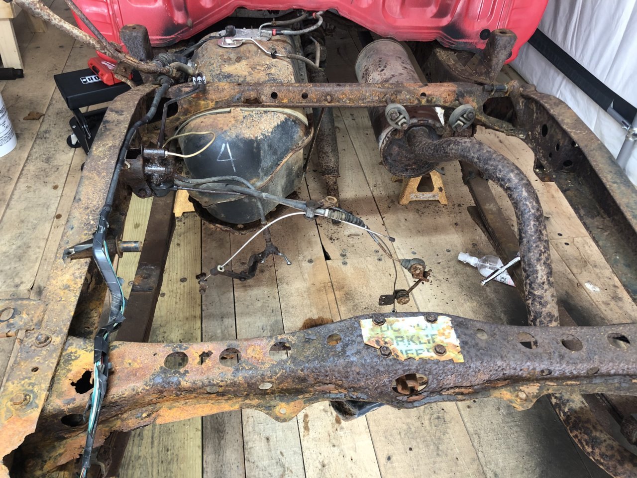

    Good god man, I think you have bigger problems than the brakes. If your rear crossmember looks like that, what does the frame under the cab look like? That looks super unsafe to drive.

    I’m in a rust zone, definitely needs cross members, maybe more. My gas tank had a hole in the top, it looked 90% perfect, only rusted under 1 strap on top. Yours I would clean off, sandblast, look for holes, and pressure test. If ok, epoxy prime or POR-15.
    Another frame may be the way to go if you can find one for a reasonable cost, that one is probably very weak from all that rust on the rails. Sandblast the whole thing and see what it looks like after.
