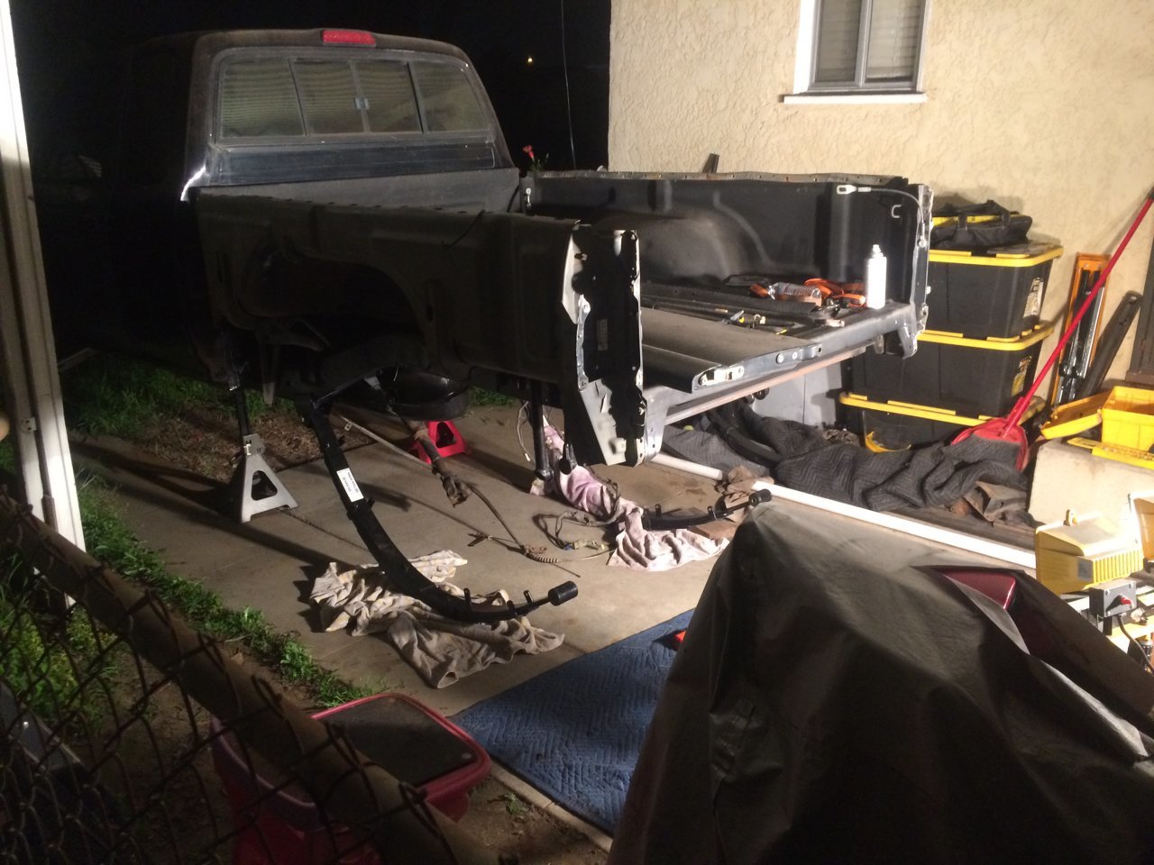

    Finishing up the front w/ shock / co hoops and then I'll move to the back.

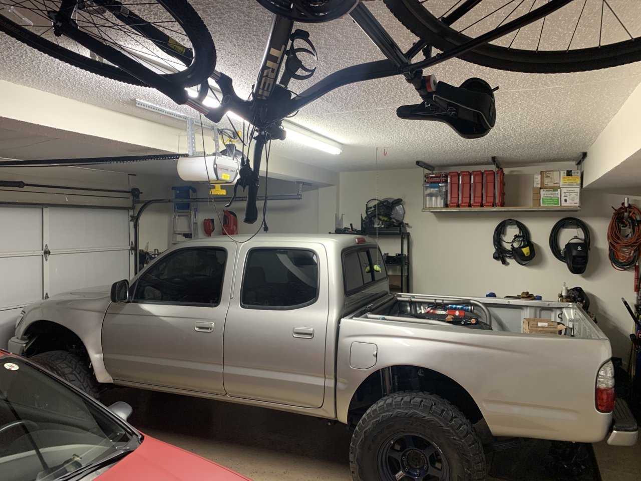

    @94jdmeg6civic
    Hey, man. Do you have any update pictures of the rear set up? I have a DC too and I’m curious what the truck would look like with the tundra axle.
    I’m about to install Total Chaos SUA kit but I’m undecided if I want to swap the stock axle with a tundra.

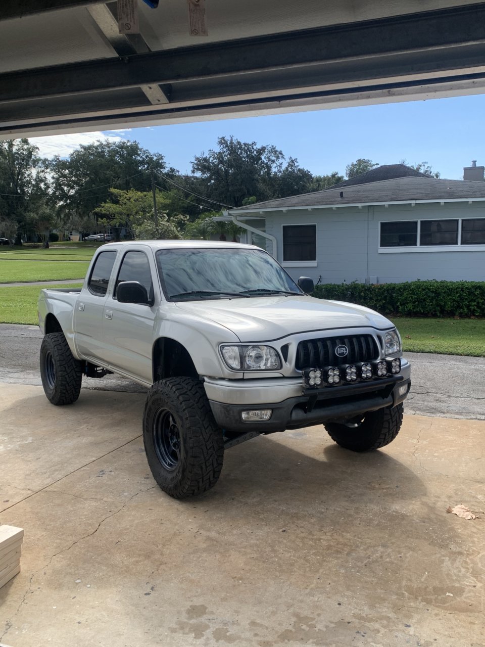

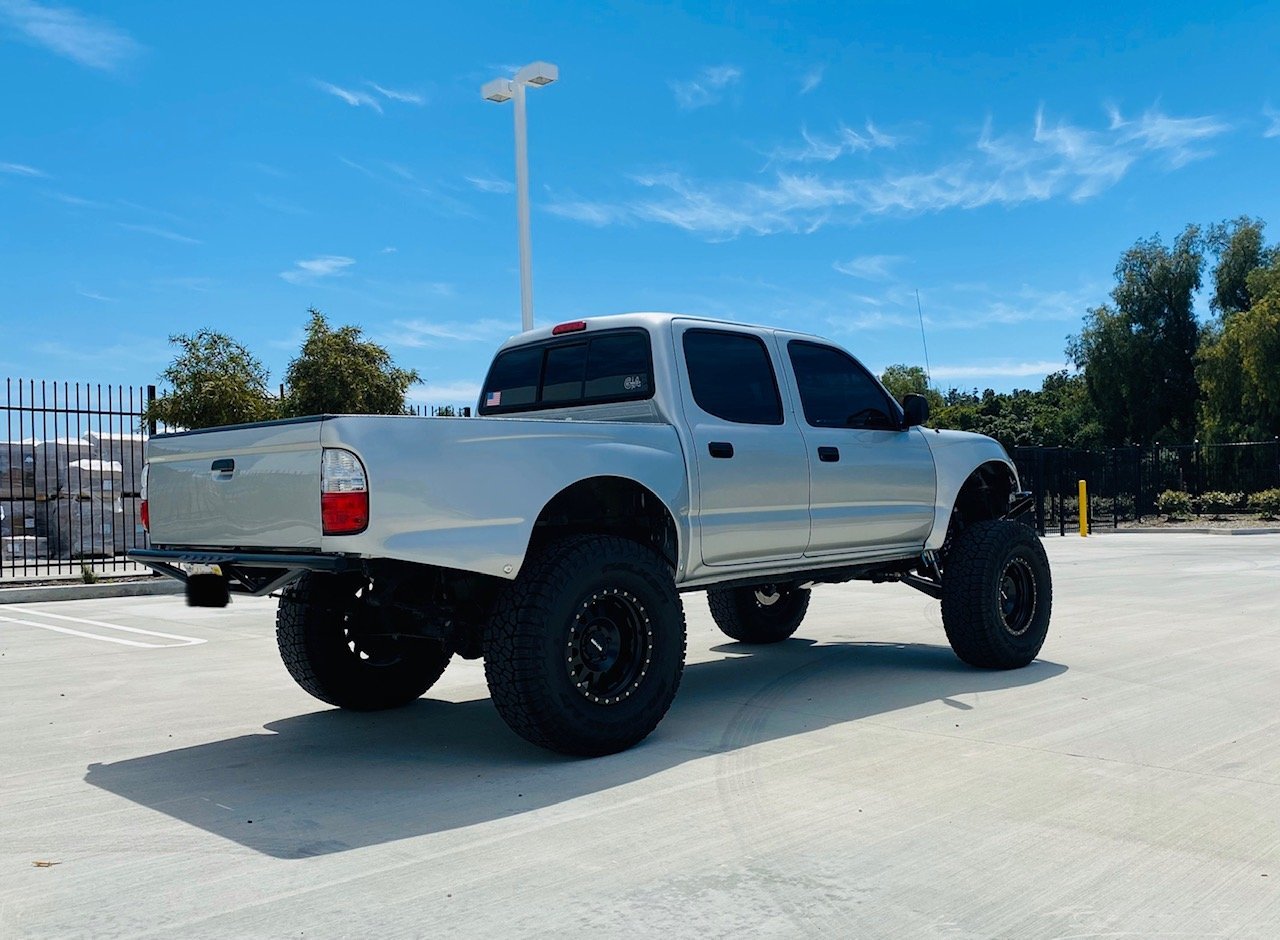

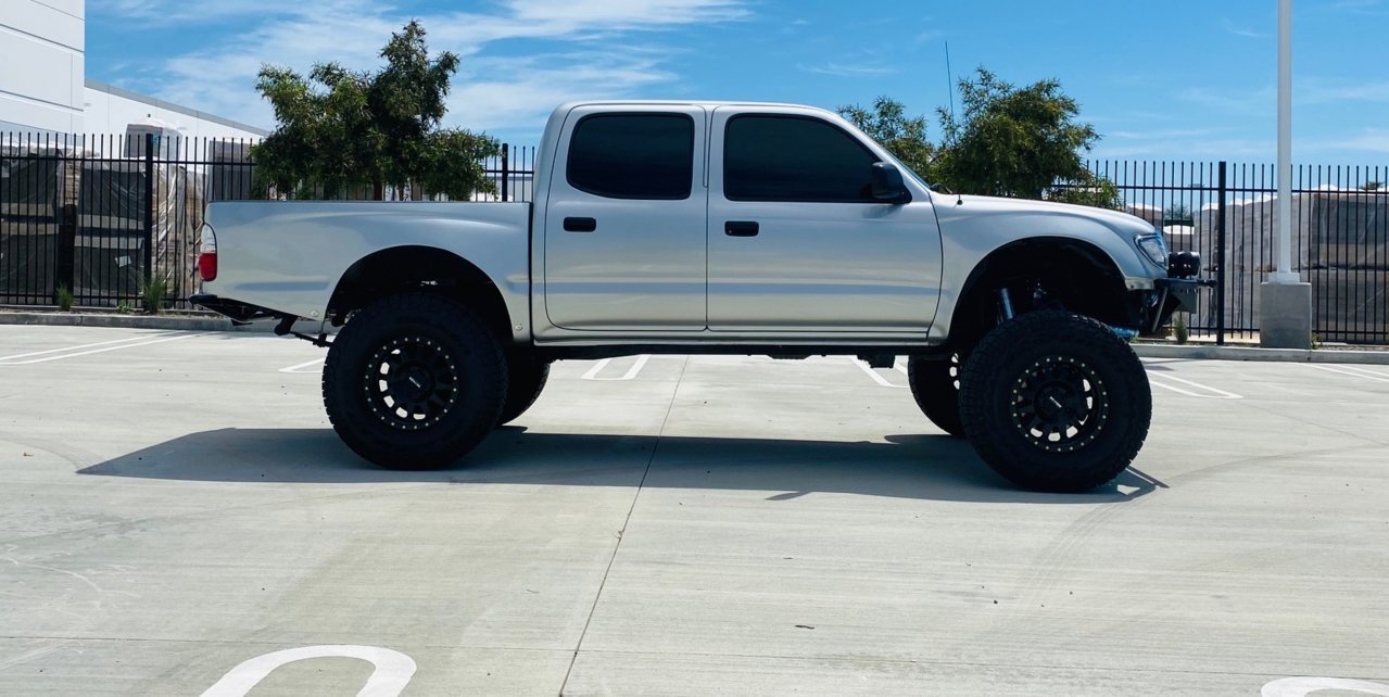

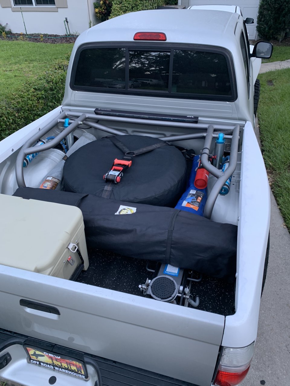

    I have more photos if you need them on the build as I was doing it if you need them also

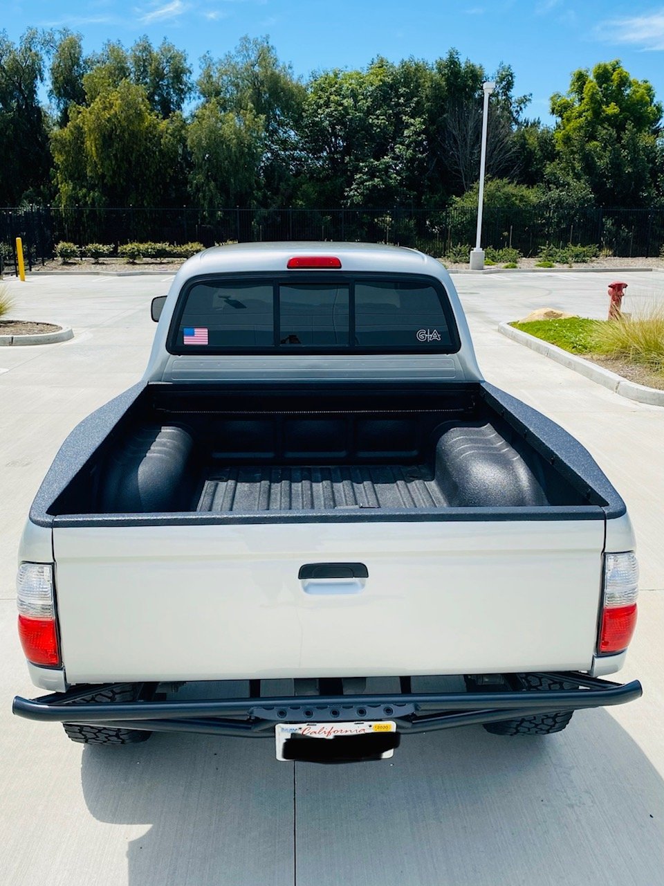

    @Dalandser Thanks, I already have bedsides from Advance. I just wanted to see what it would look like with the Tundra axle.
    @94jdmeg6civic Thanks, the truck looks good. What size tire are you running?

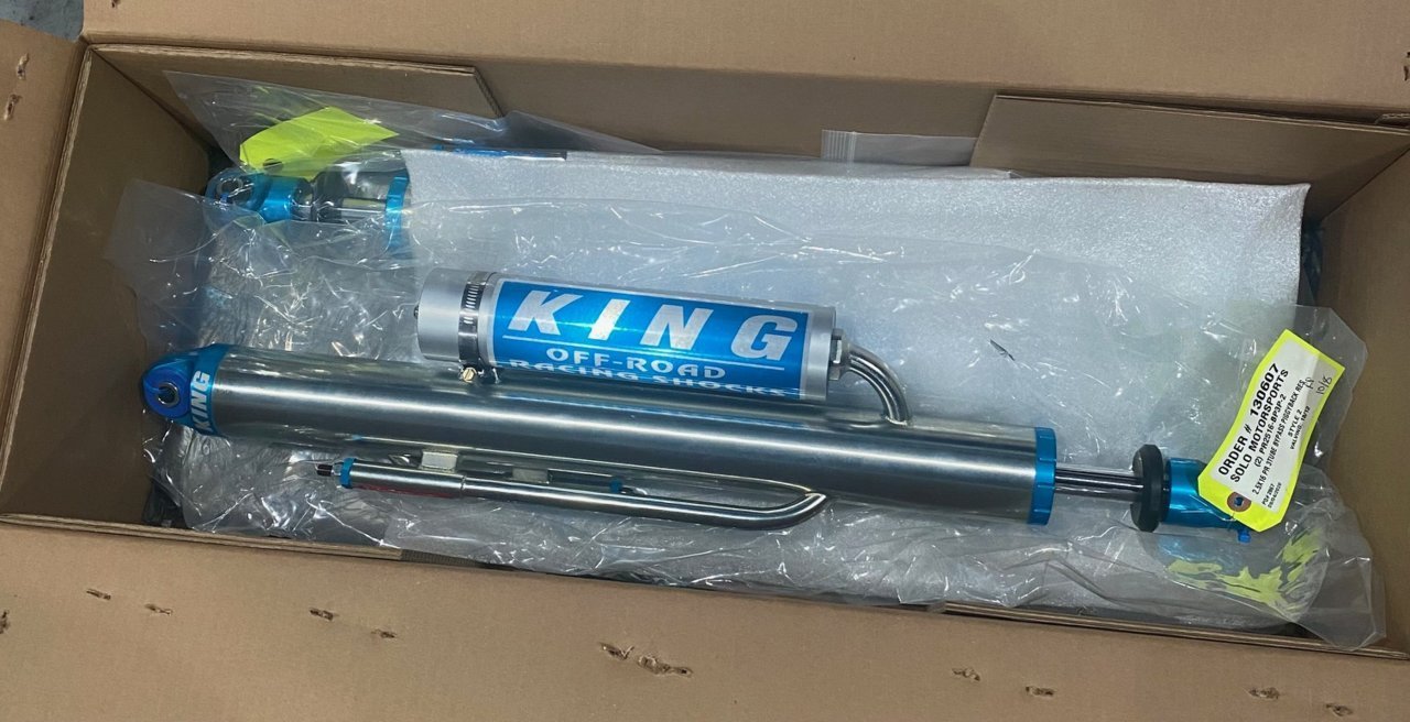

    What shock setup are you running?

    16” triple bypass

    2.5x16 triple bypass and I got bumps too. After seeing OP's pics, I might do the swap and keep the bed unless I convenice myself of ditching the bed. I dont really need the bed, this isn't my daily.
