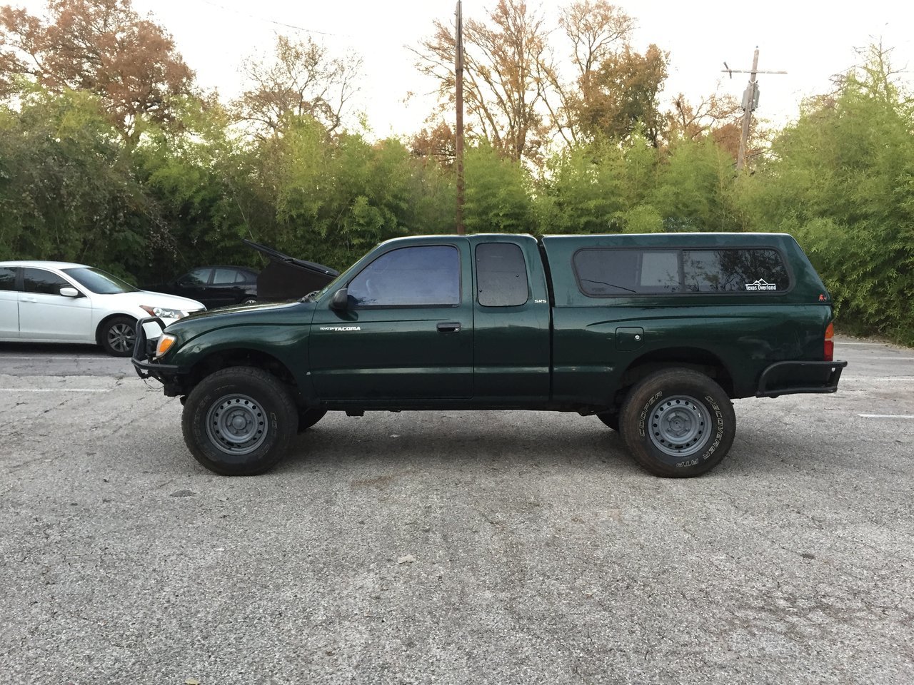

    Hey Everyone!
    I am happy to say that I bought back my old Tacoma! (2000 4x4 2.7 5speed)
    Long story short is I bought a 00 Taco from a friend with 320k miles on it a few years ago, did some work to it, drove the piss out of it for a few years and sold it to a couple at 420k miles who drove it from Texas to Alaska TWICE (neither them nor I have ever had a break down).
    Anyway I bought it back, it has 474k miles on it - and its now a complete project rebuild truck. It has too many memories for me to get a different truck. I partially want to get it to 500k before touching it to say that it ran 500k without an engine or trans rebuild and only 2 clutches, one at 200 and one at 410.
    Funny thing is that it drives the exact same way it did 250k miles ago. Now I have a real job and income to build it into the truck it deserves to be.
    ANYWAY
    Transmission is, well, special :) it has been for the last 200k, reminds me of a land rover gearbox, each gear was in its own special place.
    3rd gear syncro is so worn out so bad the shift lever can move 6 inches in either direction when in gear - no griding and goes right in and out everytime.
    Should I have someone rebuild the trans, or find one out of a totaled truck and throw that in?
