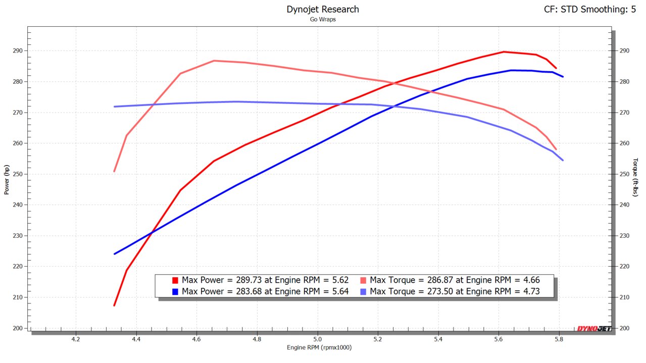

    This is a before and after with just the solenoids installed???

    Yes sir.... with about 25mins in between as I r/r'ed them myself.

    He asked for Dyna on NA engine. That doesn’t look like NA… the graph looks a little weird but those numbers are almost too good to believe from just solenoids unless perhaps your old ones were really clapped out or sticking

    Old original stock vvti solenoids had around 105k miles on them. Weren't sticking and voltage tested them and they seemed fine. Original solenoids were used in previous dyno tests (testing OVT software, etc) and dyno curves never showed a dip or weirdness indicating the stock vvti solenoid was failing.
    The dyno chart above was on my supercharged truck and the two pulls were performed as I mentioned. No secrets, no hidden agenda. I didnt/don't know the dyno shop nor operator so this wasnt a buddy's shop that I went to.
    I'm about $700 of my own $$$ into dyno sessions. Not planning on putting more $ into testing unless its financed by people who want more.

    Same gains as me? I will be the first to tell you no it won't. My testing platform was under pressure (supercharged) while yours is under vaccum (NA). Engine mods can react differently between those two variables.
    But will it make a difference on your truck? It is suppose to in a positive way.
    And that's what I tried to get answered for the community in the last two years while organizing the GB. These vvti solenoids are not new technology but sort of new (~5yrs) for the 1grfe platform . They've been modding these solenoids since the mid 90s...

    Looks like they made absolutely no difference on a stock truck per JustDSM’s dyno sheet, but show some gains on @SUMOTNK (as posted earlier) whose truck is supercharged.
