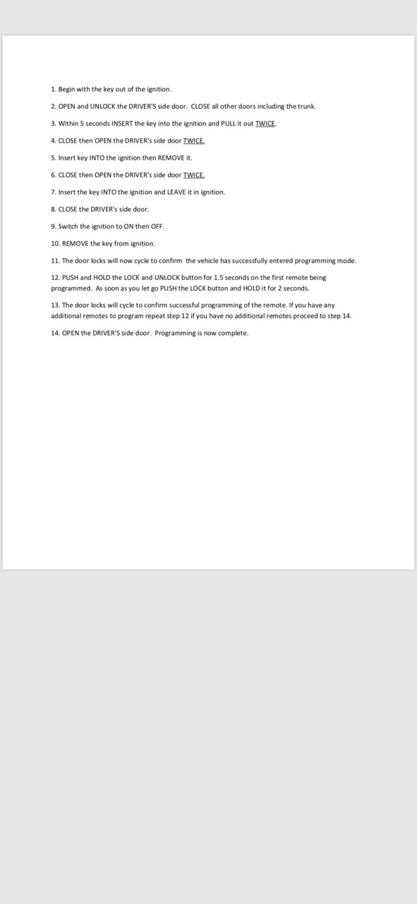

    Along these lines, on my 03, today received a remote online to have as an extra. Truck went through the programming procedure but would not accept the remote program.
    Contacted the company and they asked for a FCC code off original.
    If I could not get it, will have to contact Toyota with VIN for it.
    02 4Runner extra fob worked first time last month.
    Will wait to see if they send me a different one. New to this

    It appears I have the factory install. No sensor by the power ports.
    Used this method to get it into programming mode-
    the locks cycled through but would not accept the remote.

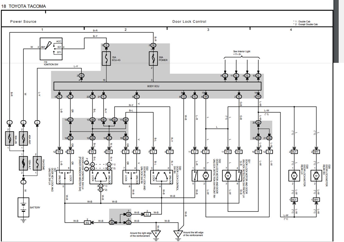

    Thanks, Wisidr1. I've looked through those wiring diagrams in the FSM in the past -- I think you're right on in heading that way. Thing is, I've not been able to find a trigger from the RKE in that diagram. Must be someplace else?
    The circuit as laid out seems to be the one guiding my truck now with no issues. Except no remote!

    Thanks, TWJLee. You're ahead of me, then! I've tried that sequence, and just tried it again twice, carefully. Not a peep from the locks.
    I believe the correct key fob for factory RKE on our late Gen1 trucks is FCC ID: HYQ12BAN. Can't be sure though, 'cause I can't get into remote programming mode!
