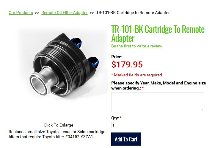

    From BAXTER Performance.
    Remove your OEM oil cartridge and replace with this:
    Run 2 hoses to your new oil filter destination and install this:
    Call them for more info and model/type if needed.

    I just installed this kit the other day. It's awesome, the only thing is i've now got a distinct whirr/whine. It's nothing terrible but deffinitely worth noting that it's audibly changed the sound of my engine. I'm going to try and mount some material between the inverted housing and the radiator support metal where i've got it mounted as well as material where a hose is slightly touching an ac line and see if that helps. I'm running an amsoil EA15K51 Filter with OEM oil currently but will switch to amsoil 0W20 Signature next change.

    Did you ever get rid of that whine? Still using this remote without issues? About to pull the trigger on this as well.
