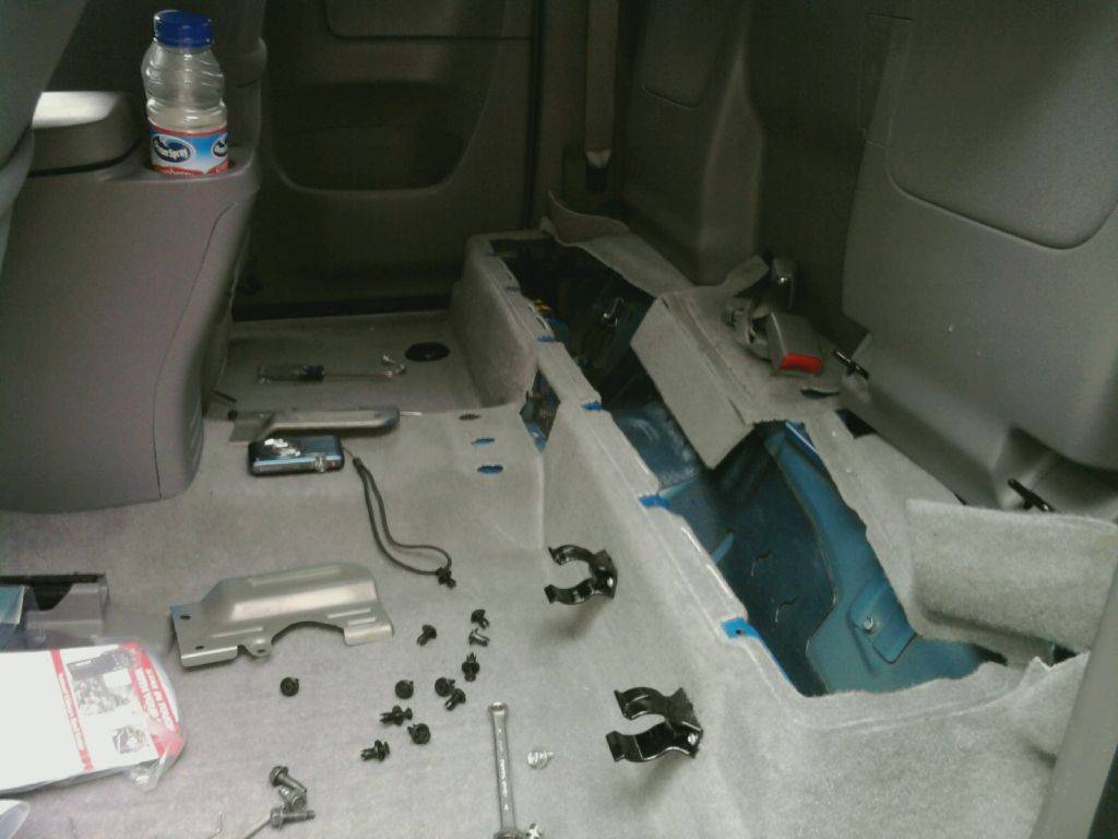

    Yes - I want to completely take the bins out that are under the seats (not just the plastic - all of it, including the jump seats).
    The guy at the install shop where I'm having some audio work done told me that he's removed them from a number of toyotas and said usually they're bolted and somtimes they're spot-welded.
    I have a feeling he's probably never done a 2012 - I read on here where someone said you would have a "hole in the cab" if you removed them. This leads me to believe that possibly the frames for the storage bins are "a part" of the main cab.
    Thanks for any comments!

    The 2012 seats and console are easy enough to remove. The plastic bins come out easy - they are held in place by 10-12 little plastic pegs. Remove the jack and stuff, pull the pegs, and it pops right out.
    I believe this is the same as older years.
    As others mentioned, the thing is that there is a metal frame for the seat supports that the bin fits into. Also, without that bin in place, it is really loud - there is no insulation between them metal floor and the interior of that metal frame.

    Just to note - I not only wanted to remove the plastic storage bins, but also the metal frame that the storage bins are housed in.
    So now I have a medium sized sub box behind the passenger seat, and the sub box is up against (not touching) the rear diagonal metal plate that is attached to the very back of the cab.
    But I only did it on one side. The other side still has the seat & storage bin. I still need to remove the center console, but I have to say..it looks pretty good for now.

    im curiuos to know if you were ever able to remove the metal frame. i have an 09 access cab and i think the setup is the same. i had the same idea of removing the metal frame but i didnt want to have to deal with figuring out what to do with the carpet. so i cut a section of the frame out under the seat and made a sub box that supports the seat, was only able to fit an 8" in there tho.

    For me, I was able to have the audio place that installed my system remove the metal bins. Based on my memory, they told me it was just a few bolts and some spot welds that they had to remove. Pretty sure they had to sawzall only one side - the side that connects to the center console. They gave me back the material they removed and that's what it looked like.
    I love having it removed! As of now it makes room for my sub box, but I'm pretty sure I'm going to do it to the other side too. Those storage boxes just arent an efficient use of space.
