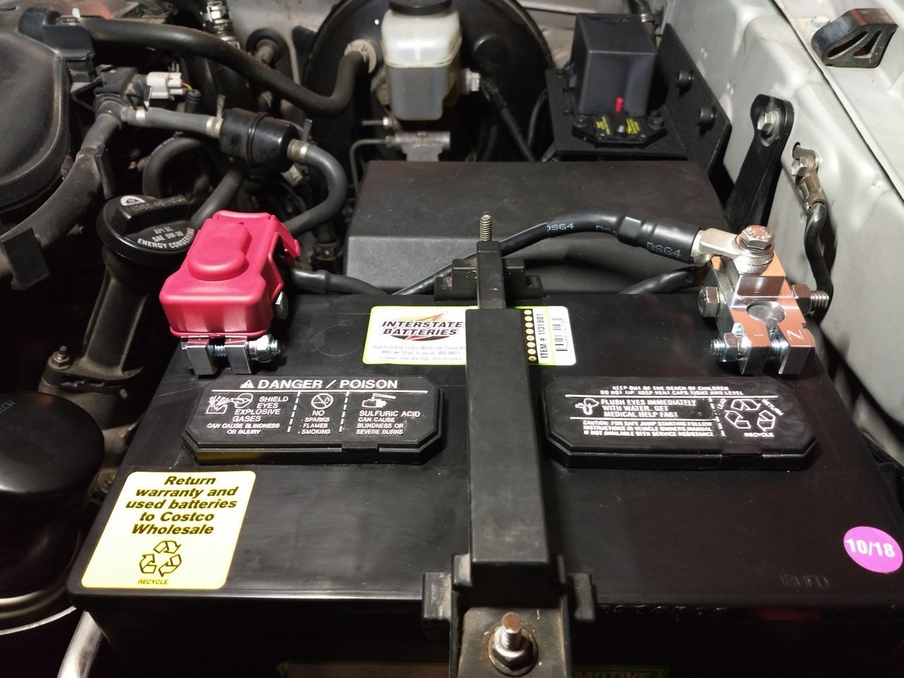

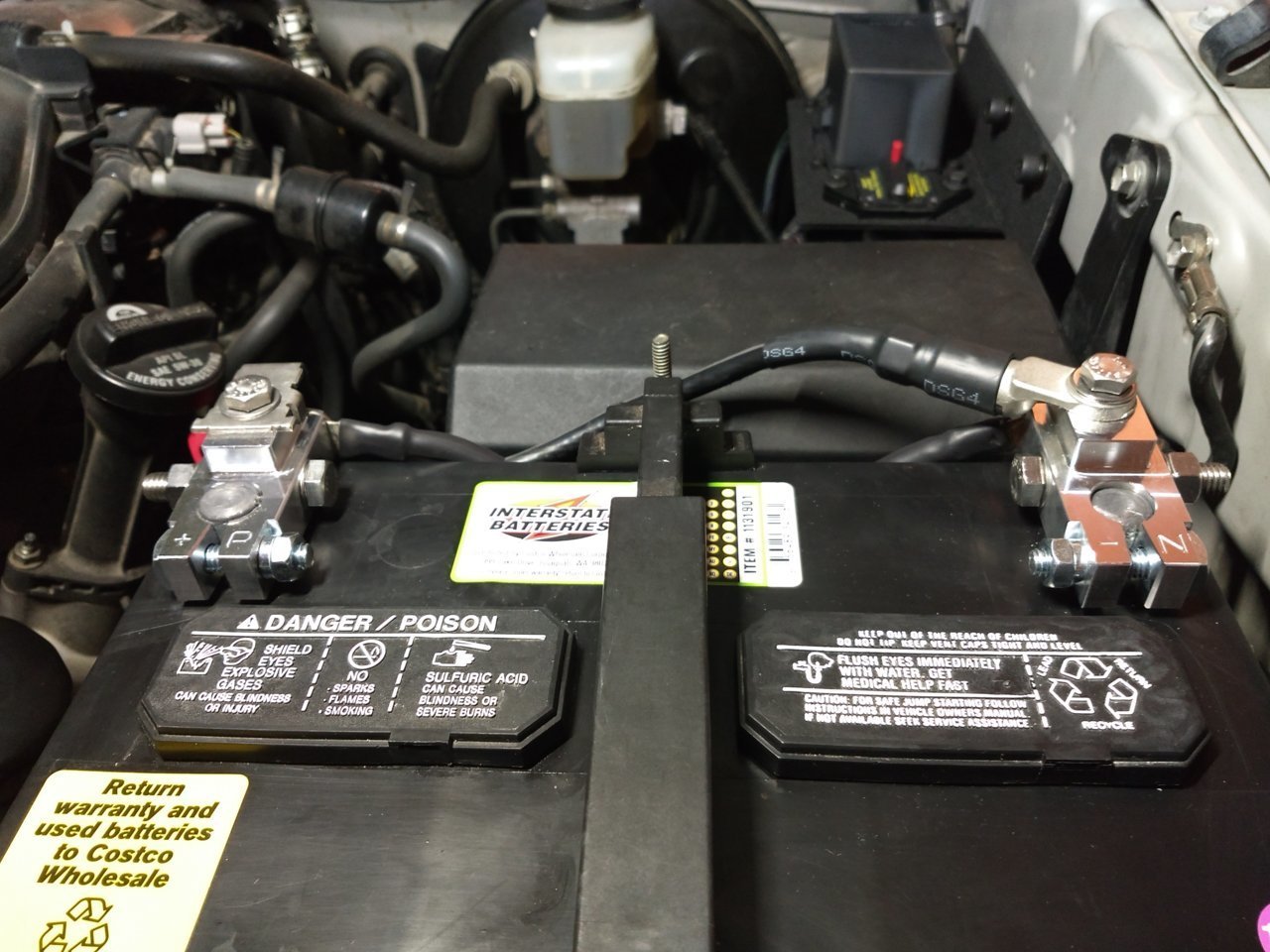

    the previous owner replaced my cable end with a shitty one for some reason.
    possibly to fit the cheapshit weak tiny battery they got.
    That cannot clamp securely and pops off on it's own making the truck not start.
    Had a lot of wins on the truck when buying it. The worn out shift knob that looked like it spent it's life being thrown down the street.
    I guess they couldn't afford $50 on a new knob either. But could afford the truck in the first place when it probably cost them over $20k at the time, not to mentioning taking whatever hit trading it in to that used car dealer for a 3rd gen so they could move on to the next one and fuck that one up too.
    Otherwise maybe would have left it stock (if was stock)
    but at this point in regards to repair, an upgrade looks good
    allowing for more battery-operated attachments to be installed, re: mil-spec cable ends and whatnot
    seems like it may not work on the truck given there is no desk to set it to hammer on
    vs a screw thread type
    one thing if you have it out on a bench to hammer it
    but the battery cable is connected to the truck
    unless the idea is to buy a $40 harbor freight vice and screw it tight on the truck
    the harness goes to the battery?

    I recently added an upgraded headlight harness and aux fuse block. I had too many wires coming in to the battery so I replaced the terminals. Those wire connections are on the backside and are hidden by the terminals.

    Battery to relay, relay to harness

    I read all of the posts here and I'm still a bit confused. The negative terminal on my battery is completely rusted and corroded, and I would just like an OEM replacement. What's the best way to find one?

    Yep mine does the same has for the last 12 years good dose of plain water and a little scrub good for another year. Never seems to corrode under the clamp that's the important part. I'm guessing it is because it's copper plated.
