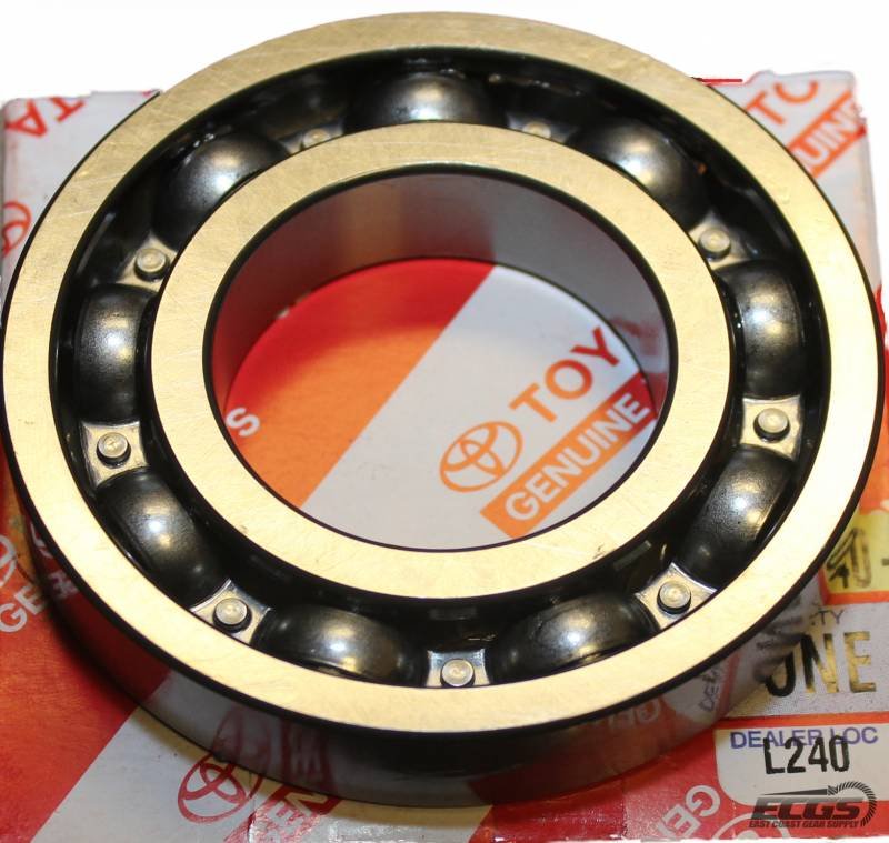

    Is the larger bearing on the passenger side serviceable while diff is installed? I ordered it from ECGS when I got the bushing and install tool for the driver side, but cant find any talk of anyone else replacing it.
    This one:
    Toyota 8" Clamshell Passenger Side Tube Bearing (T8CS-TUBE-BRG)
    I also cant find anyone saying that play in the axles on the passenger side was an issue as it is for me. I have over 1/4in of play in both axles.
    Any information/ how to/ would be appreciated.

    The passenger side actually has the same needle bearing up against the diff as the left and it is even the same part number. The difference is the driver's side has a CV shaft directly entering the bearing, but the passenger has a short stub shaft directly entering it as part of the ADD. I have replaced the passenger side needle bearing with the ECGS bushing on two Tacos.
    On the passenger side the CV shaft enters directly into that ball bearing you show. That bearing is rather robust but has some play within typical of such a bearing. There is no way to adjust the play.
    The ball bearing can certainly be replaced but I have not attempted to do so in situ. Rather I have removed the 4 Torx bolts holding the ADD tube to the side of the differential and put the whole tube in a vice. I have thought later some about whether that bearing can be removed without taking off the ADD tube and I believe so. You may have to get a slide hammer and pull it but again I can't positively affirm.
    Rather, if you have been changing gear oil frequently and the oil is not contaminated and is at the correct level in the diff I do not think I can recommend going after the ball bearing as a preventive maintenance item. But would recommend doing so if there are strange noises, gear oil contamination including metal in the gear oil.
    With the CV shafts installed and the truck sitting on the ground and the drive line unloaded the RH bearing should have a little play and that would be normal. I believe there is a spec. Contrast that with the LH that may have an alarming amount of play present, even when brand new.

    Its kind of a big job getting to the pass side needle bearing. You would have to remove all the same stuff + the ADD tube. I'm just not sure I would be inclined to recommend anyone routinely do the job unless there were some compelling reason. And other than the common issue with the LH needle bearing I do not believe I have ever run across a vibration issue traced to the other parts.

    Well, I remembered why I was taking off the entire ADD tube and putting it in a vise. Its because you have to. A clip has to be removed on the inboard part of the ADD tube to remove the internal shaft and then a press used to remove and reinstall the ball bearing on that shaft. See the illustration on page DF 17 linked here for an exploded view of the ADD tube parts:

    When I replaced mine, I removed the whole tube assembly. You can probably get to it on the truck but would be a total pain. The snap rings are difficult to work with. I wouldn't see any need to replace that bearing as long as you changed the differential oil at the recommended intervals as that bearing sits in the oil bath. Here's a link to some pictures that might be helpful
