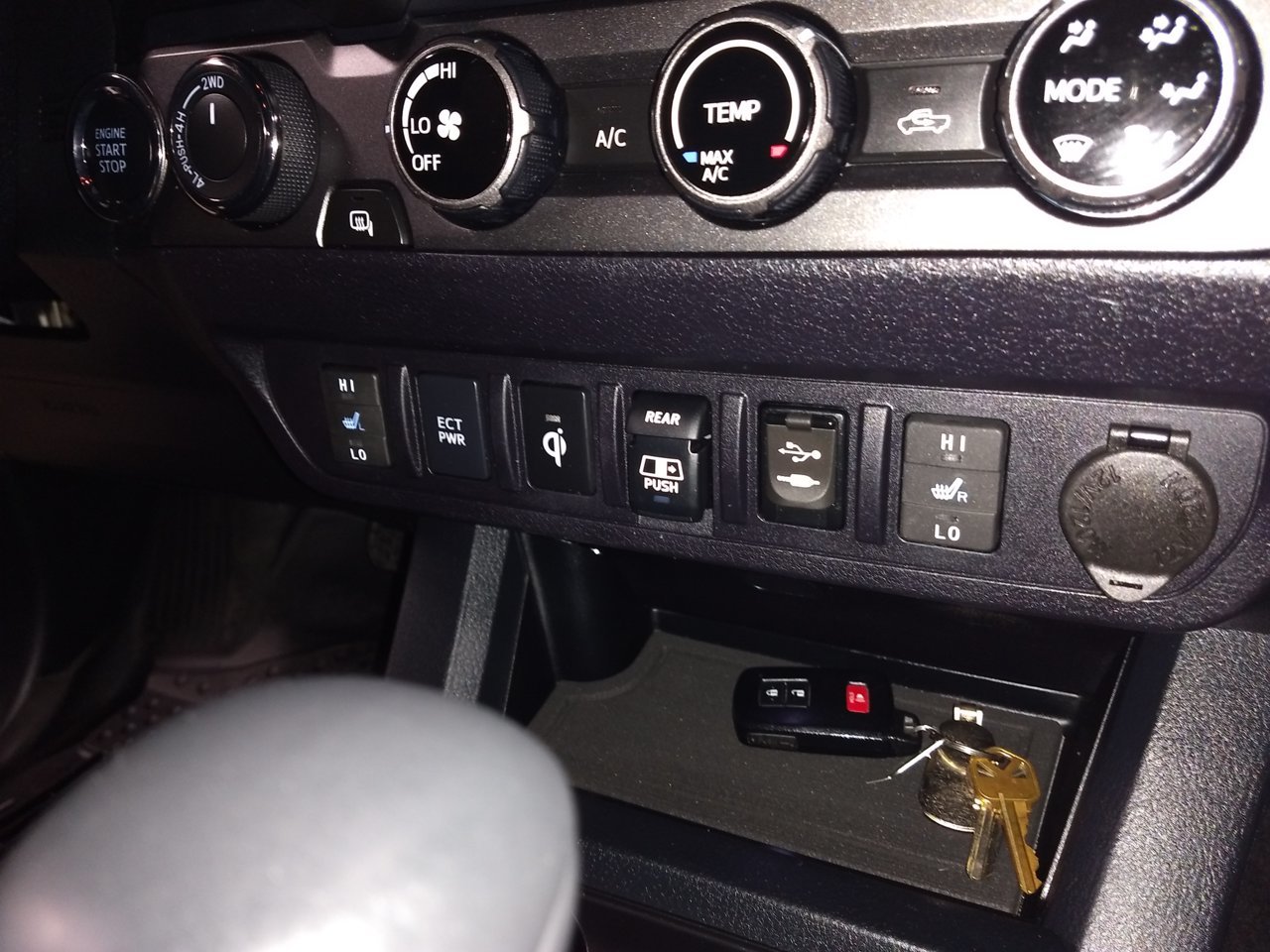

    Also when your wiring harness is under the seat you go under the center console and up into the center of the dash. Very easy and the switches fit like a glove. No need to go wiring under the dash. The blank switches pop right out. Easy to do or put the switches on the side of the seat but then a passenger can also forget to cut it off. The center switch is best imo plus the switches gives a high and low setting with matching dash lights.

    Exterior Mods: TRD Pro SS catback exhaust | TRD Pro Grille | Redline Tuning hood QuickLIFT | OEM Tacoma bedmat | Black running boards | Derped chrome badges | Me-So Gashole | TRD Pro 17x8Alloy wheels Interior Mods: Black Clazzio Napa Leather seat covers |Aluminum stereo knobs Engine Mods: TRD Pro Intake Air Box Up Coming Mods: 265/70R17 Falken Wildpeak tires

    This is the kit I used and works great with only one space left. It also has a blue background light on switch.

    The kit comes with only one box that both heat kits plug into. The box could have two relays in it but not sure. Both heat kits work independent and plug into the one panel switch which controls each seat independently. Also only take one fuse spot as well. I have had mine now for over a year and works great.

    The kit I purchased had two switches and four relays, one for each heater. Unfortunately I'm not familiar with the one you linked. Make sure the kit you chose has relays pre-wired in the wiring harness.
