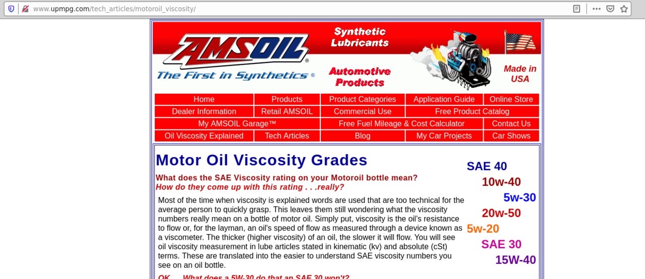

    For the record that page is not Amsoil.com and doesn't even look like an authorized page.

    Is the giant AMSOIL banner not showing on the top for you?

    I suggest getting familiar with how amsoil does sales and marketing. They farm it out to a legion of "dealers" who have their own businesses, and all put up their own websites. Its not as bad now, but 15 years ago you couldn't search for anything oil without landing on an "independent amsoil dealer" page. And, it seemed ilke every forum had an amsoil dealer who would jump into any thread even tangentially related to oil and launch into an amsoil sales pitch. Seized up engine? Should have used amsoil. Bad gas milage? Try Amsoil! Wife left you? AMSOIL!!!
    Yeah, I'm still not a fan of theirs.

    Since I am an Amsoil dealer and have been for 20+ years, I can tell you that is not an Amsoil authorized web site and no way are dealers allowed to make technical proclamations about the products or make promises about MPG or even recommend products beyond what Amsoil recommends. I could have missed it but I do NOT see Amsoil authorized web site anywhere on that page. I understand the bad taste in your mouth. I assure you Al's son and son in law have been cleaning up that high pressure bullpoop. It's never been my way, I can assure you - you can check at bobistheoilguy.com . I just wanted to set the record straight. Yes dealers are allowed to have a page, like mine:
    https://oilslubesandfilters.shopamsoil.com/

    Fair enough. It has gotten better, thankfully.
    As far as their site goes though, no potential customer is going to know if its a real amsoil site or not. It says amsoil on the top and they claim to be amsoil dealers on the contact page (where they also list their 4 other oil selling sites :rolleyes:) Guess the parent company still has some work to do.

    I hear you. They are (now) aware.
