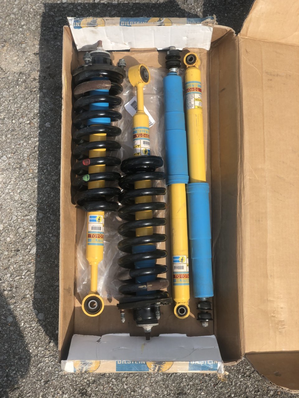

    So got myself a complete 2020 TRD OR setup; front, rear and leafs. Big thanks to the sellers, got them for free. Going to install them soon as I get the chance.
    I plan on adding a Toytec 1.5” progressive or single AAL and will keep the overload leaf.
    And adding 1/4” plate for driver side.
    Since winter is kicking in I will be carrying about 250 lbs in the bed most of the time, and hoping the springs will settle some.
    Will there be any problems with going in this direction? Since there is a possibility of going to 2” of lift in the rear, will I need shock extenders to use OEM rear shocks?
    Any tips or other advice doing install or buying to have shop do it will be greatly appreciated.

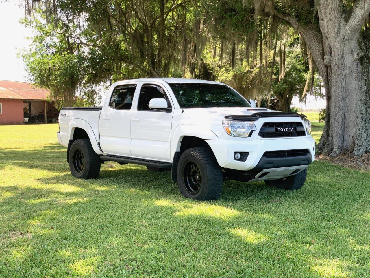

  10. Nov 2, 2020 at 6:21 AM
    #370
    bigfoote13
    bigfoote13 Well-Known Member
    Aug 5, 2015
    #161099
    5,383
    Joe
    South Florida
    15 TRD SPORT
    2016 Sport suspension 1/2 spacer up front and aal in rear SCS Stealth 6 17 inch wheels Wildpeak AT3 265 70 17
    I suggest going with 1/2 spacers in the front on both sides. (I have a single AAL in the rear). Pretty close to factory rake.
    I had 15 bags of mulch it still had a slight rake. When your empty you will be very nose down without the spacers.
    A buddy has 3/4 inch spacers up from with Progressive AAL out back and I like the way his looks.
    Bodyguard89[QUOTED] likes this.

    I was just in a similar situation but came across a local set of 2020 TRD OR front and rears for $80 with only 9200 miles. Haven’t installed yet, but will be soon. I’m a 100% pavement pounder and am thinking about slapping a 1” spacer up front and a block in the rear for a small little boost in height....
