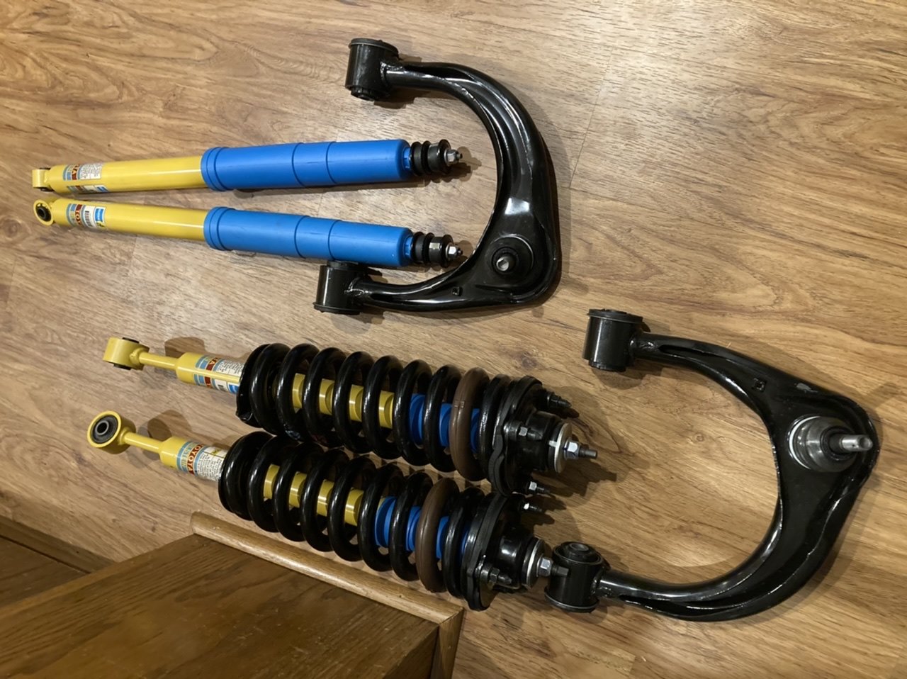

    Success! Bought all of this for $175! Kid got his first big boy job and went straight to buy a 2021 TRD OR....then straight down the road to have a full King reservoir suspension, Ray 10’s, and 33’s. Everything looks like it just came out of the box!

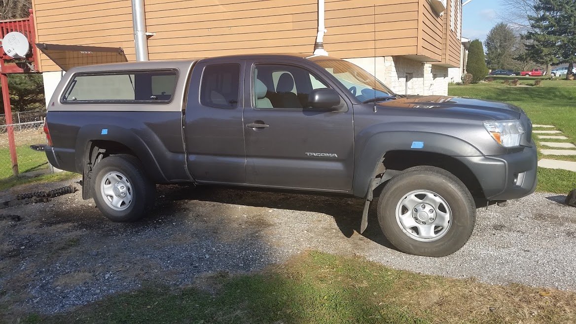

    On mine, the rear came up about 3/4", the fronts were around 1 1/2". My Taco is an AC, base 4cyl. As far as donors, they would all be V6 trucks, the 4 cyl rigs are usually base models and a few w/ SR5 trim, none will have the TRD OR package. On my truck, the ride became very smooth and controlled. The best example that I can give is on a RR crossing on my daily commute- the stock suspension transferred every jolt into the cab and through the steering wheel regardless of how slow or fast I went over the crossing. After the swap, the same RR crossing makes it seem like you're inside of a sedan, not a small truck.. I don't notice any nose dive under hard braking and body roll doesn't seem any worse. I have my stock sway bar still attached.
    n6mHfCnSElbvOk_b3VfPwe33FPr_EyIGxCBC4MYt_c86a6fe682e8fcee6433644a441f4163784ed2f0.jpg
    Here it is, right after finishing the swap. It took me about 8 hrs total using hand tools and my battery powered impact gun

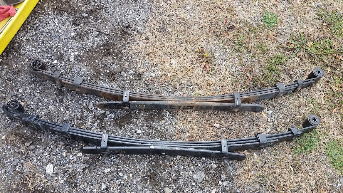

    Here's a comparison between the stock springs ( top) and the OR springs. Both have 3 plies plus an overload, the plie thickness seems to be the same ( just eyeballing, I didn't measure) The interesting thing is look at the 3rd plie- on the OR spring there's a break then a super short piece close to the eye where the stock spring has a full length 3rd plie.

    Interesting. I have no idea what that little stub of leaf could do besides take up space. Are both of these 3rd gen, or is the top 2nd gen?

    Top is from my '15 base model 4cyl truck, bottom is from a '18 or '19, I don't recall what year the parts came from.
