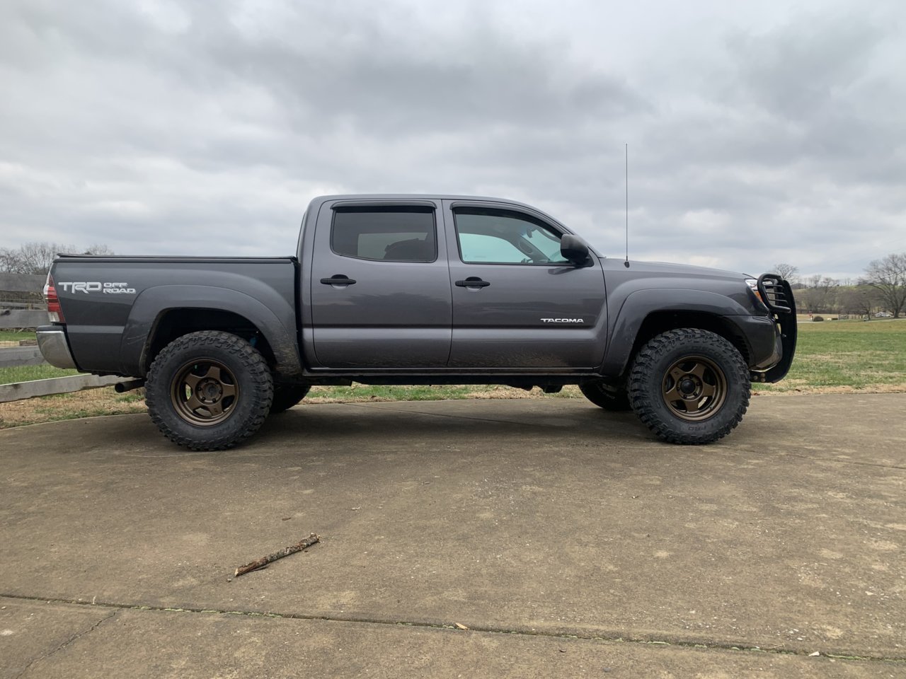

    Just finished my suspension swap myself. I’ve got 2018 trd off-road coils 7k miles on them. Rides like an brand new truck

    Looks bad ass! Whats your tire size and wheel spec?

    Thankyou! I’ve got 265/75/16 cooper stt pros and 16x8 -25 stealth custom series f5’s

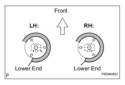

    I looked at the color dots and the clocking/orientation of the spring, just so happened the red and green dot ended up on the drivers side. This image helped:

    #457
    BlkDakDave
    BlkDakDave Well-Known Member
    Oct 20, 2012
    #89422
    1,120
    David
    CC TX
    07 AC PreRunner TRD/Off Road
    And that's the point, the dots don't mean squat. It's how the end of the spring (coil) is orientated to the rear of the vehicle.
