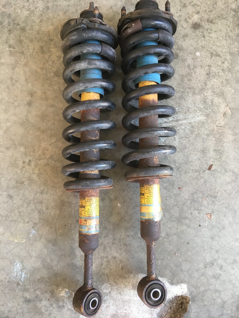

  20. Oct 12, 2018 at 9:28 PM
    #100
    Dlakerguy13
    Dlakerguy13 Well-Known Member
    Jul 7, 2018
    #258637
    204
    On another note: Are these coils worth anything to sell? Obviously those struts are trash! IMG_4825.jpg
