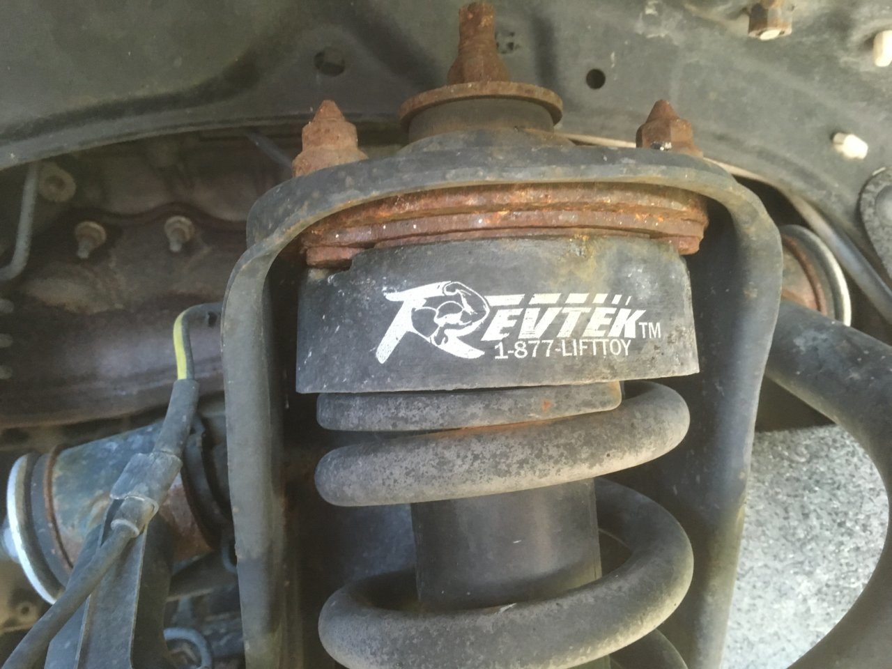

  20. Nov 27, 2020 at 5:44 PM
    #20
    Greybeard3019
    Greybeard3019 New Member
    Nov 22, 2020
    #347512
    2
    Wyatt
    2010 4.0 Manual 4x4 TRD
    I have a revtek spacer lift that was on the truck when I bought it, trying to figure out what kit it is exactly, does anyone know? Also, in the distant future I hope to upgrade it. Any other advice on what to get/explainations for why this is a good or bad option would be helpful. The ride seems pretty stiff, but is that a problem other than comfort? What are the advantages of the blistein 5100's and springs vs what I have now vs a fox or rough country coil over? I like the size of tire I have now, but they rub a bit sometimes and would not mind lifting more or changing tire size a bit if needed next time around.
