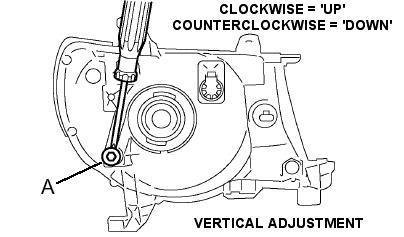

    The next thing you need to do is aim the headlights. What you want to do is find a flat place to park (parking garage is ideal).
    • Place your truck 25ft from a wall.
    • Measure the height of the center of the projector from the ground, 42” for me.
    • Use masking tape to mark this same height on the wall.
    • Adjust your headlights to be even with or below this line, below is best to avoid blinding oncoming drivers.
    Before:
    This 8mm hex head is how the height is adjusted.
    Passenger side up, you can see how tilted it was.
    Finished, here is how your cutoff should look by the end of the aiming process.
