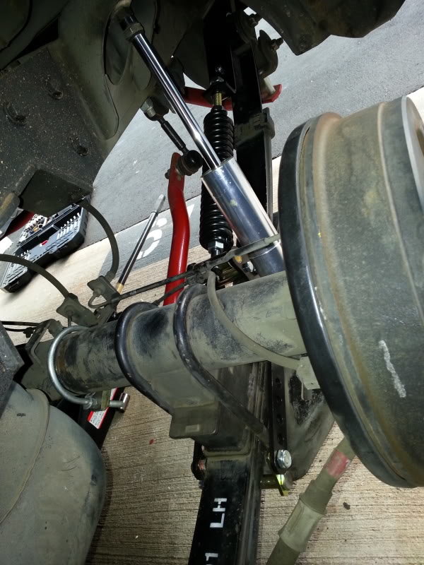

    The photo below shows my final attempt to get the kit to fit, but even after adjusting the front mounting bolts to shift the mounting bracket as far forward as possible, the bracket still touched my shock and chipped all the paint off. As neat as the kit is, I wasn't going to keep a kit that could potentially rub a hole in my shock!
    I contacted Roadmaster support via their web site. They suggested that I use their older generation mounting bracket which they'd send me for the cost of shipping. Below is a comparison of the new bracket design that doesn't work (top) versus the old (bottom):
    The older bracket design certainly involved more work to install. I had to remove the u-bolts, replace the centering pin with a longer pin, and then do all the remaining installation steps. Despite the extra work, I think this is how Roadmaster should sell the Tacoma kit. The install looks much cleaner now w/o the extra bracketing and there is a ton of room next to the shock.

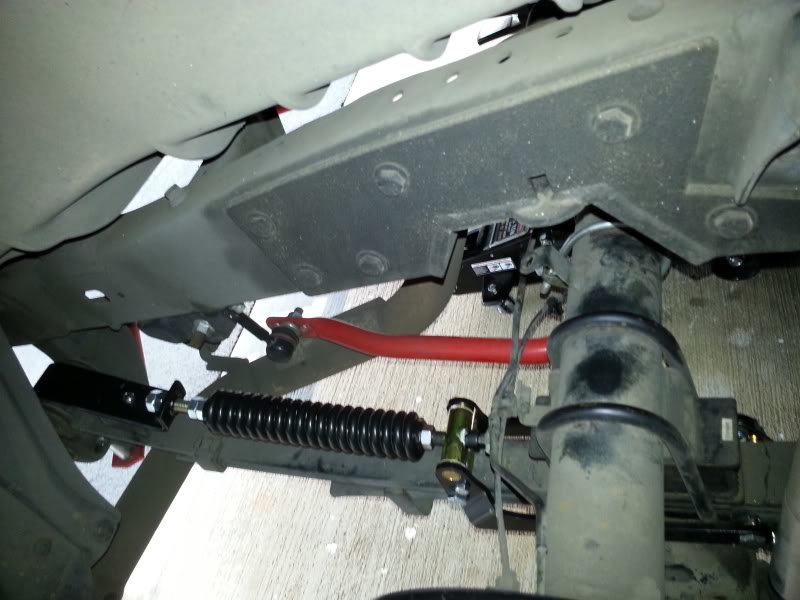

    Some X-Runner owners wondered if this kit would work for their trucks or if it would interfere with the rear swaybar end-links. jmarquez808 has the X-Runner swaybar and the Roadmaster kit on his truck, so I can only assume that the two will work together.

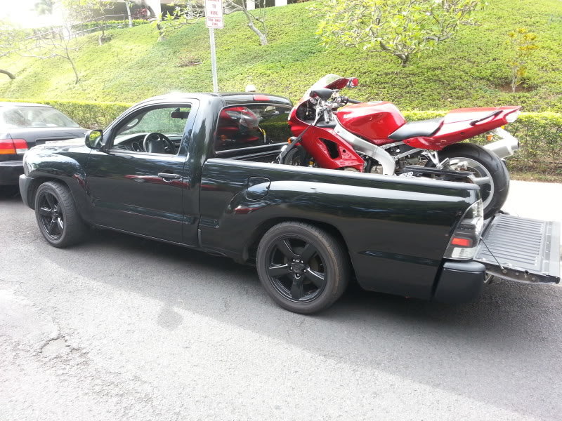

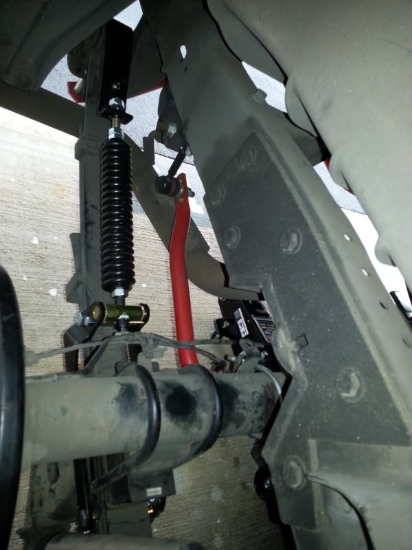

    The sway bar is fine with this kit. Doesn't even come close. It does not protrude past the leaf springs so its good. As for hauling my street bike it's almost Impossible without it. It still sags a little and rubs the e brake lines for me. Before installing this when I'd haul my yz250f I'd rub the ebrake lines a lot, really bad but now It handles well and doesn't rub at all with that. The other bike is around 400lbs so yah it rubs the lines a little but nothing serious. Without this I couldn't haul it at all. I need to do some more testing of it also I'd like to get the older style kit like hot taco cuz my shit is rubbing the qa1 and if it damages it there will be many tears for me. Lol

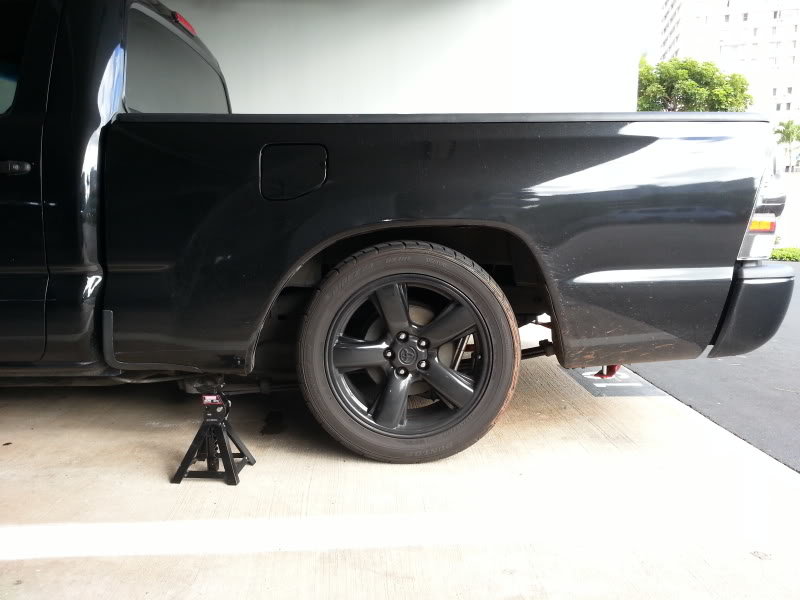

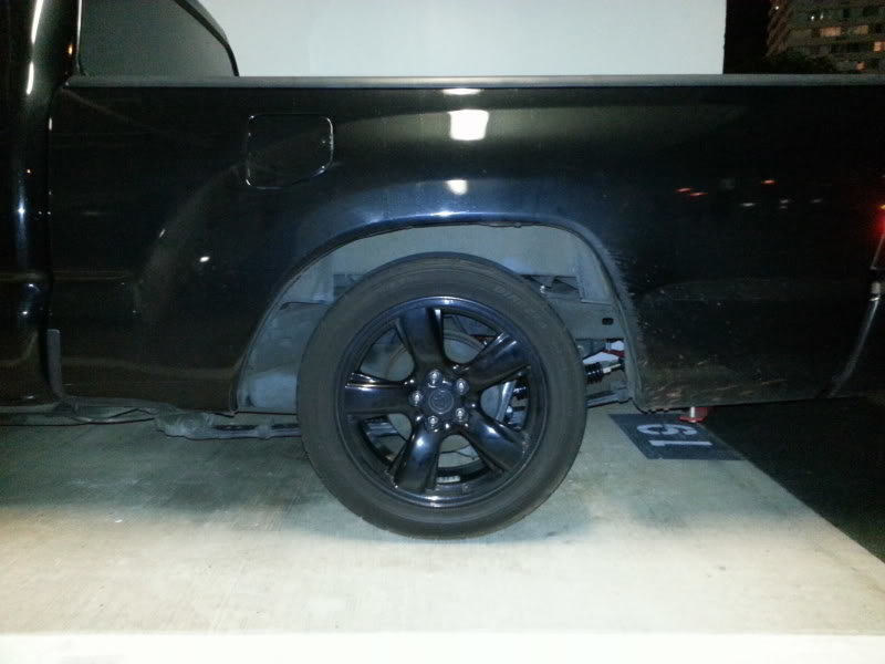

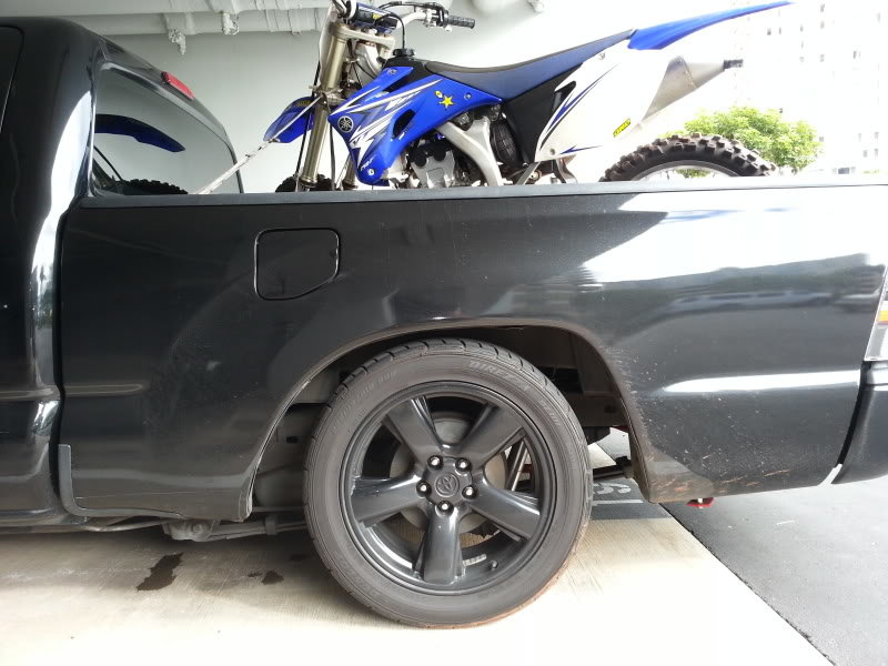

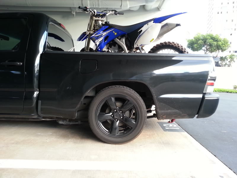

    Without kit
    With kit

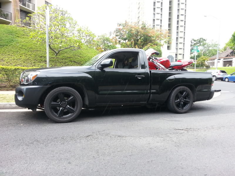

    Hauling my friends bike impossible with 3 inch blocks before the kit was in. It raises me an inch but drops back down about 3/4 inch instead of like 2-1/2 inches without the kit.

    Another black single 2nd mini, I like. I loaded welder, welder generator, and tools in the back of mine on Qs without issue... I'm 4.5/5.5 drop. Just had to hump them up to support the weight. What's the ride with the helper spring like?
