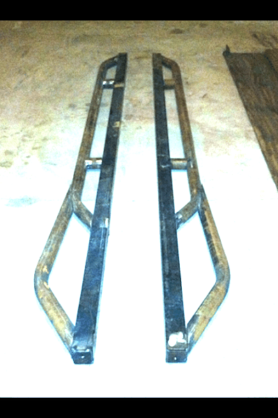

    I've been wanting rock sliders for sometime now, And finally got around to building some for my 04 Tacoma. I went with 2x2 square tubing and 1.75" tubing. I've seen a lot of nice sets of sliders on the market. So I went with this design.
    Here they are so fresh so clean!!
    IM MAKING THESE FOR TACO'S. JEEPS AND 4RUNNERS
    single cab/4Runner 58" long. without the kickout $160+S&H, with $180S&H
    Extra cabs/doublecabs 78" long. without the kickout $200+S&H, with $220+S&H
    The kickout comes flush to the outside of the rear fender. To make ease for the kids to climb in and out also to keep that low profile look. I have been a welder/fitter for 10 yrs. Going to school to be a structural engineer I've learned that sometimes less is more lol.

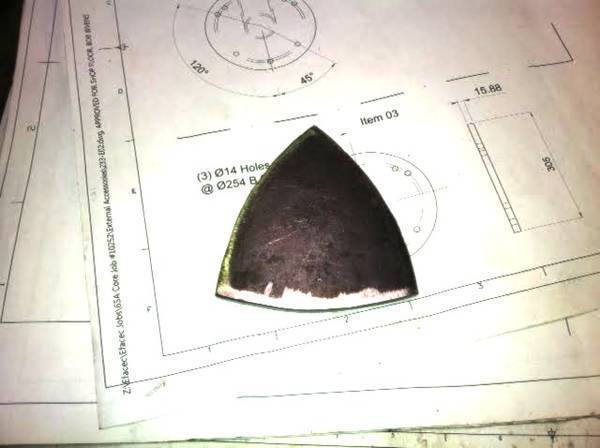

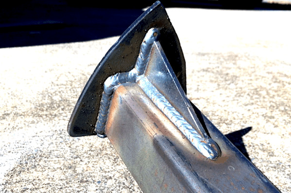

    These will be welded on. My mounting plate is a triangle since it's the strongest shape. By it's self it was BLAH so I threw on some curves. you know you like curves!!! :D with little gussets on top. More to come of weld out/install

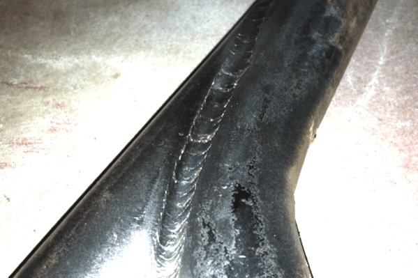

    Kickout weld joint

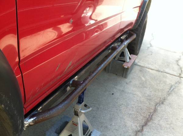

    The test fit
    Repping Charleston, SC

  14. Nov 24, 2013 at 6:08 PM
    SOS CONCEPTS
    SOS CONCEPTS [OP] Bumper builder
    Sep 9, 2013
    #112175
    15,689
    SOS
    Laurens SC
    17 sos buggy, 09 taco(in pieces), 14ram 3500
    Rock bouncer
    Good looking out! I did bring them in closer on my second set

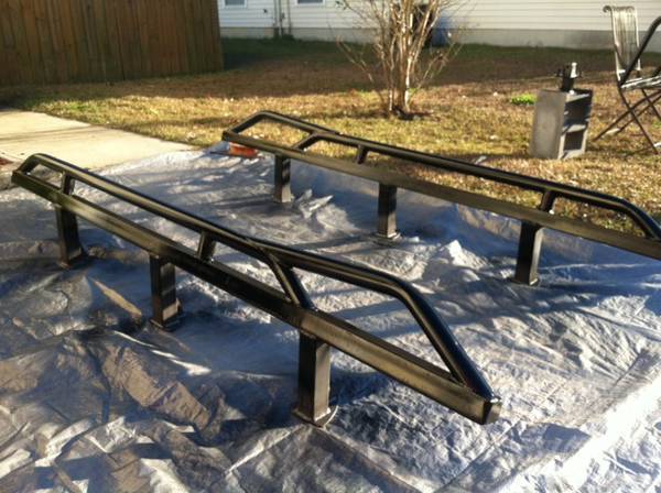

    Got my mounts welded out!
    Primed and getting shipping quotes tomorrow!

    X2 on the welds sliders look solid
