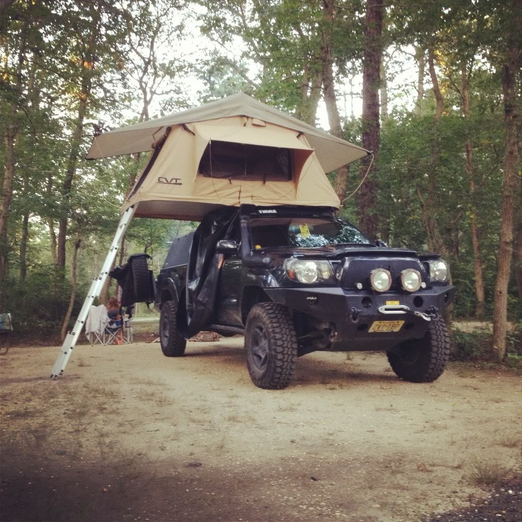

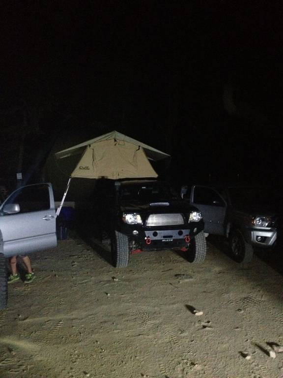

    Too bad Craig's truck and my truck are two different trucks and are both double cabs...
    Craig's is mounted on his bed cap, and is the top picture in the dark.
    My truck is the bottom picture. It is a double cab and mounted on Thule roof racks.
    I don't think either one of those situations helps the OP any, because his situation is an access cab, which finding roof racks for can be a problem.
    You need to find a roof rack option for an access cab and that is it.
