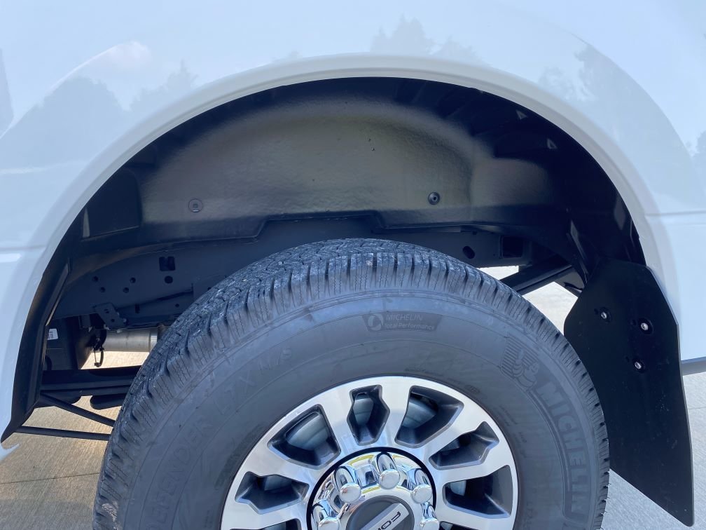

    New member here, shopping for a used Tacoma for my 16yo son and joined to learn about them.

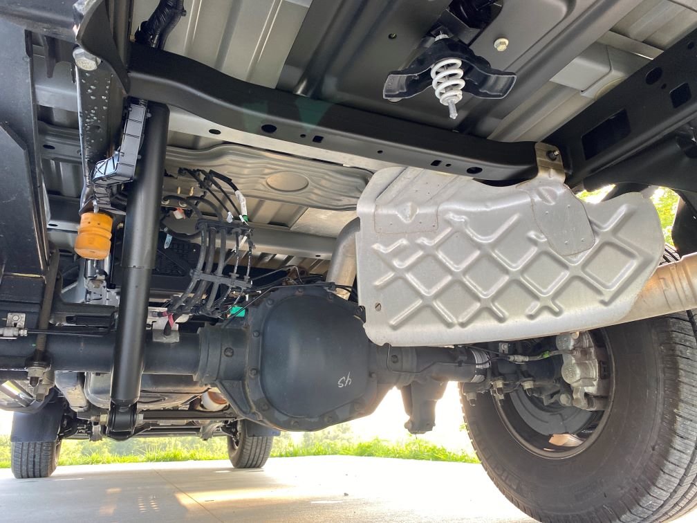

    I've got a '22 F-250 (1yr old with 12k miles) and decided to treat with CRC 6026 after reading reviews on here and other sites. I started spraying yesterday evening and so far have only sprayed the inner facing side of the frame rails, cross members, front axle and steering components. When I first applied the product it had an OD green to bronze looking tint. It seems to have lost some of that tint from drying overnight.
    Since the F-250 sits tall and displays a lot of the undercarriage, I was very hesitant to spray the outer facing sides of the frame rail and rear axle. Last thing I want is a white truck with an OD green or bronze looking frame showing. The RP-342 BLACK peaks my interest for those areas, and I may get a can or two of it to try yet.
    Additionally, since so much of the frame and undercarriage is visable from just walking around the truck, when I wash my truck I spray the frame, undercarrige and fender wells with Simple Green and pressure wash it off, even use a wash sponge on the plastic fender well liners and mudflaps (OCD). I like the underside to be as clean as the body.

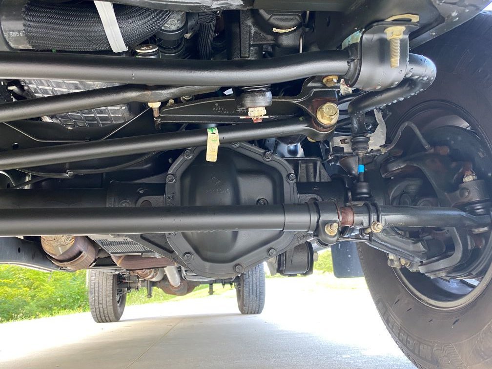

    All the black parts you can see in this pic were sprayed - except the radius arms and outer facing side of the frame rails.
    The drips on the sway bar are water, from washing the truck about 30min before the pic.
    The shocks, crossmembers, spare tire plate, and iner facing side of frame rails were sprayed. I've not sprayed the rear axle yet.
    The drips on the bottom of the frame rail are water, from washing the truck about 30min before the pic.
    I've decided to drive the truck a couple weeks and see how much dust / dirt / grime the sparyed parts collect, and how easily they wash clean before spraying parts that are noticable from walking around the truck.

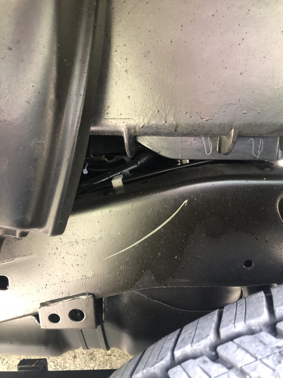

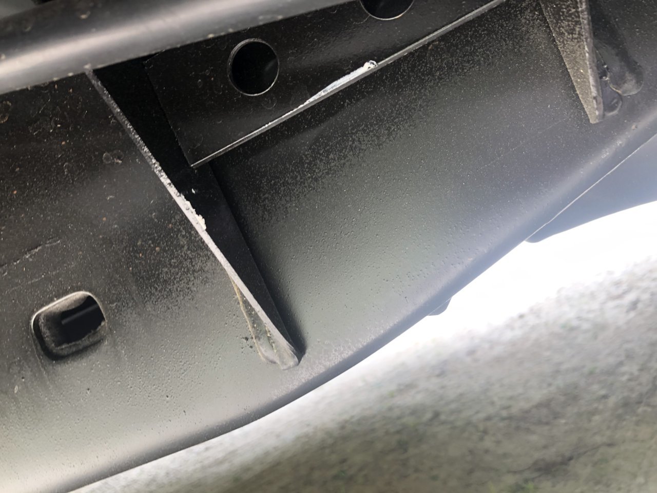

    Pics I think are right after I was hitting with second coat. It will flow around and even itself out and fill some voids. I’d follow suggestions in that thread. Only thing I will say is do it in a well ventilated area, wear a mask and safety glasses. Maybe gloves. And let it sit a couple hours. It was a perfect June for me to do it outside. No wind at all and warm. It will drip but I have a stone driveway. I didn’t get that messy. In second pic you can actually still see a factory mark on the frame. On anything silver it will turn it clear brassy color. And I have a white truck and didn’t notice any overspray on the paint anywhere. It’s not that tacky once dry. I haven’t looked lately to see any dust or dirt 29E3DD94-2887-4866-9621-8E4211FAF624.jpgF320A3AE-34C3-470A-B91D-66101E5E56EE.jpg
