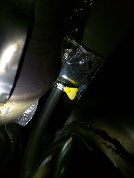

  3. Aug 13, 2016 at 10:59 AM
    #63
    Pisan1
    Pisan1 Well-Known Member
    Aug 13, 2016
    #194461
    61
    2016 Black Tacoma TRD Sport DCSB 4x4 MT
    Hey folks, new here and this is my first post. Just got my Taco, back in February. I've been lurking for quite some time now. Saw this mod and wanted to give it a try today. Went to the auto parts store and got all the pieces for around $10. Found these great hose clamps with a key, that allow you to tighten without any tools. You can do it one handed and it helps because there is not a lot of room to move in there. I didn't remove anything on the truck, just ran my arms up there and went to work. Like someone else mentioned, let the truck cool down for an hour or two or you will burn your hands/arms. Thanks for the great tips TW!
