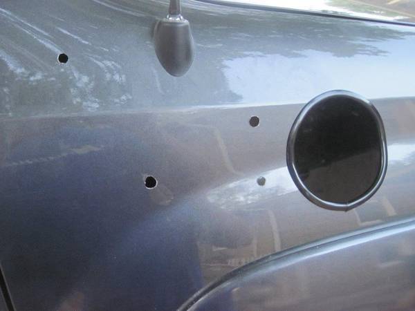

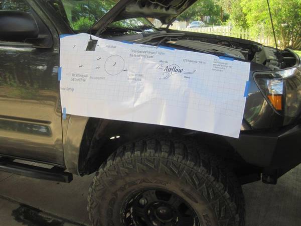

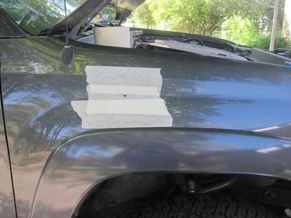

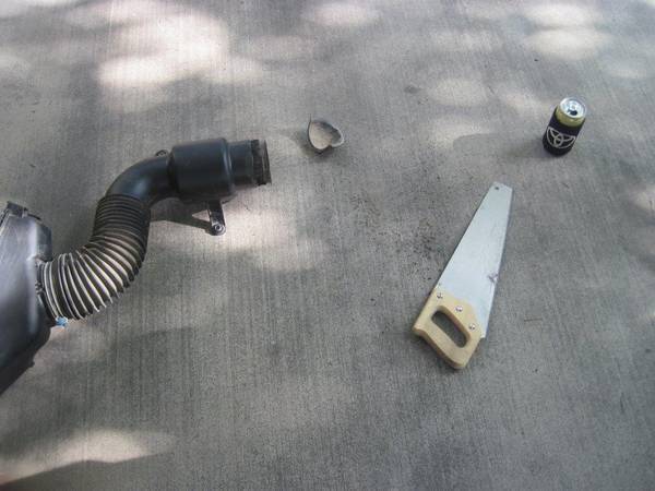

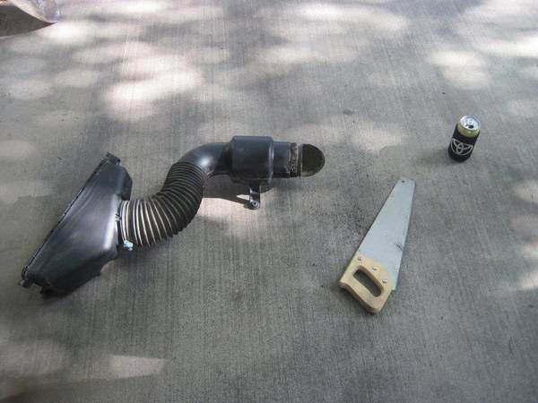

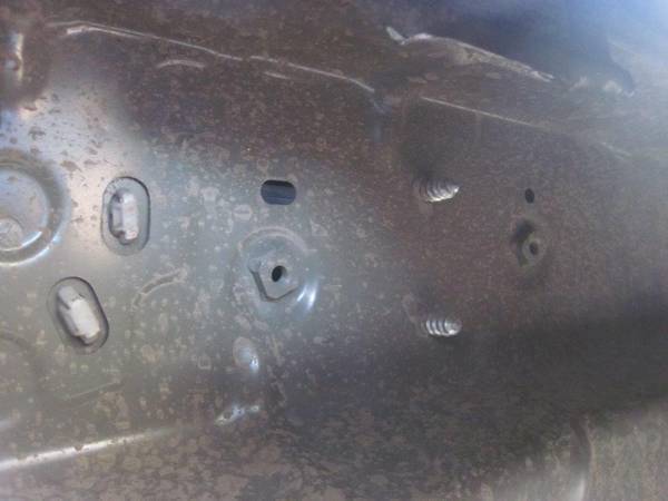

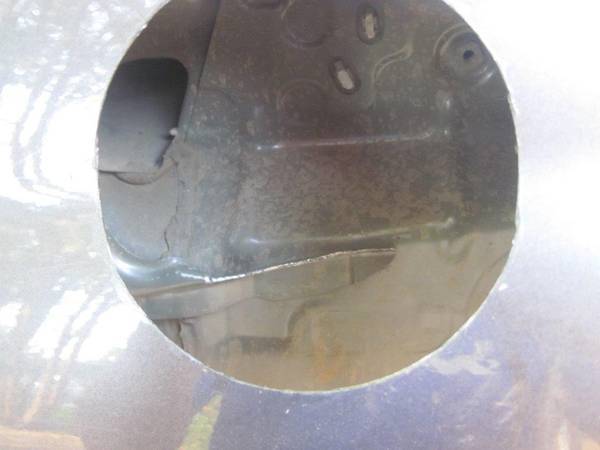

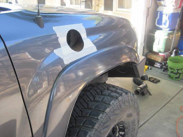

    Forgot that I never posted my experience with installing so here is a copy and paste from my build thread:
    Finished my snorkel install so I thought I would post a few pictures. Here are a couple threads I read prior to the install and used as reference.
    The first is Bob's write up on tacomamag.com
    And the second is Jamie's when he did his
    Aligning the template to the truck. This part was the most tedious due to it not aligning perfectly and since you're going to be following it the rest of the time, if you F it up you might be screwed.
    Here is with the intake out. About to cut off the 'scoop' at the end. Intentional liquid courage placement in the pic.
    And just like that, its gone.
    Next I taped up where I was going to drill and went to work.
    These two shots show where I cut the fender pillar to allow for the plumbing to fit.
    After I put some paint on the drill areas, I finished the large hole with some door trim. Stole the idea from Spoonman.
    After that I did all the plumbing and tightened it all up. You have to do some crazy contourtioning to get the top washer and nut up under the fender. It took me like 15 minutes just to get it threaded. Finally got it all put together.
    Last thing I'm waiting on is a black oxidized hose clamp for the top instead of the plain metal one that is shipped with it. Once I get it, I'm going to cut the hat down a bit so its sits a tad bit lower.
    I'm pretty stoked on the addition. The air intake is now safe, up and out of the way and the truck seems to be happier when I push on the gas.
