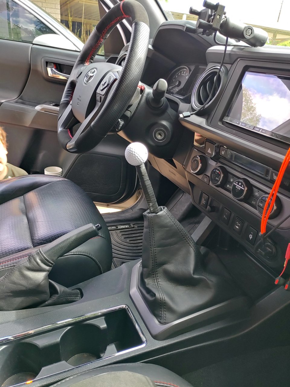

    Purchased a Joying head unit from a member here. Came with Metra mounting brackets and GPS adapter.
    9" screen looks incredible and a factory finish.

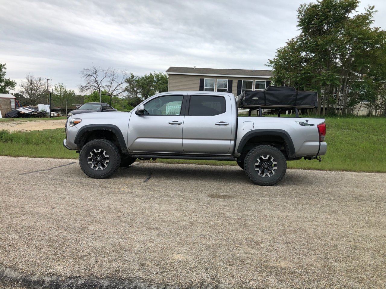

    Quarantine allowed me to finally install the lift I purchased months ago.
    Bilstein 5100 on 2nd notch
    OME 887 coils
    SPC UCA
    ECGS Bushing
    Dakar mediums
    Spidertrax Spacers

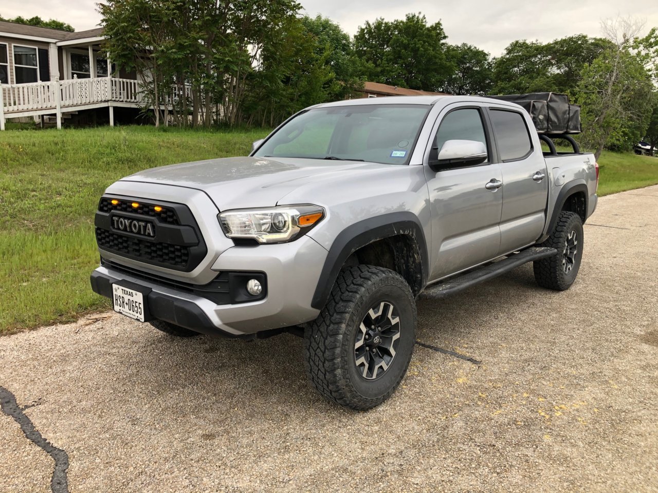

    The Smittybilt tent was purchased used and put the tube bender to work building bed bars for mounting. Picked up the angle iron for $5 at the local scrap yard and the 2" tubing was left over from the building the sliders. Total cost was maybe $20 with the t-slot nuts and the angle iron.
    Kitchen counter turned out to be the perfect height

    you know, i saw those and had to post this. ;)
    golf, anyone?
