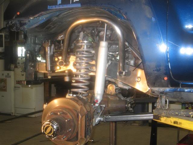

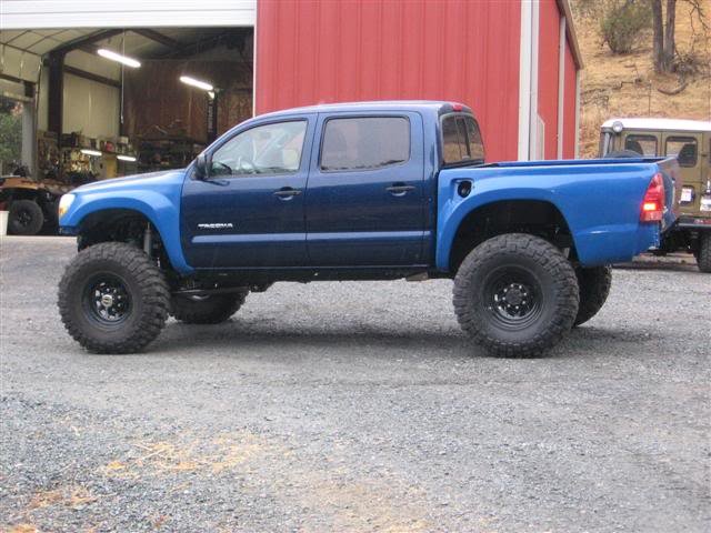

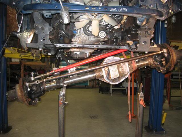

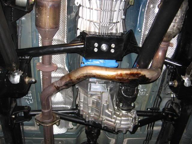

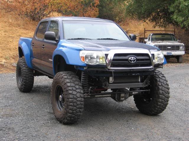

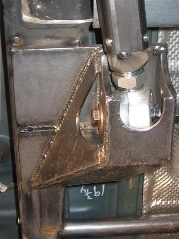

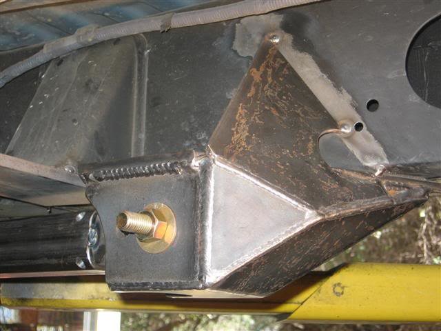

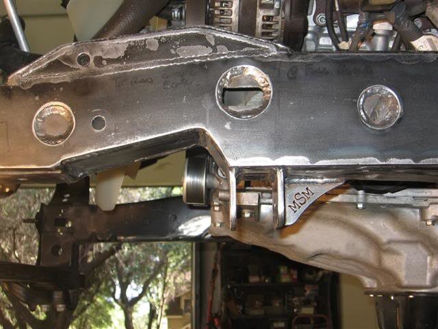

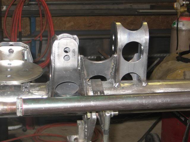

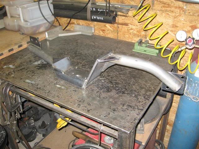

    Pics of the Double Cab truck with the Fored Dana 60 (69 3/4" wide). The toughest parts of this build were getting all the links to clear and setting up the steering box. I have learned an easier way to do it since.

    oh god, that sas 2nd gen is beautiful:drool:

    Absolutely beautiful truck!
    If I win the lotto I will be seeking out this builder lol
