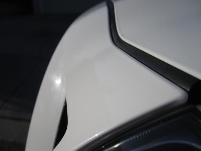

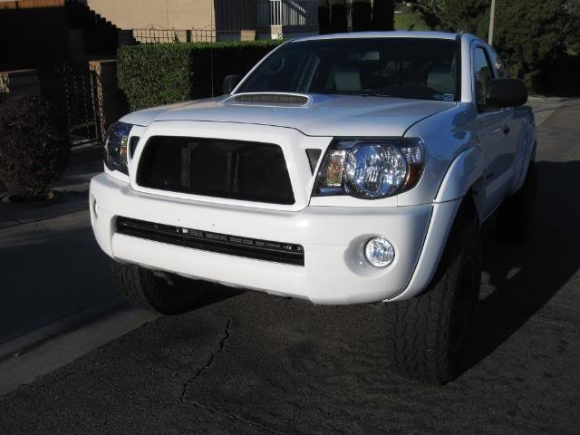

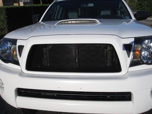

    Sooo after hours of relentless sanding, cutting the 'puzzle' piece to fit the "W" shape that was left over, a bunch of lock tight glue, bongo, sand x 1,000,000, then sand x 1,000,000 times again. Keep in mind gentlemen, this is NOT a sport, so I sanded a lot more than you did-that is to say if your grill was bling chrome.
    For whatever reason I couldn't get the "puzzle" piece to fit exactly, so I made sure that all gaps were filled with the lock tight glue, and although there was some minimal over flow it didn't matter after some hardcore sanding for hours on end. I started out by hand and surrendered the job to the jitter bug as my hands started creating waves. If you are considering this project, I HIGHLY recommend a sanding machine like so...
    I attempted to color match and taped everything off, bought a 040 color matched 12oz can from ebay (iMatch). Started off by priming, sanding, priming, basecoat, then clear coat. Well, it didn't turn out so hot as the color was slightly yellow, and I couldn't seem to get a smooth glossy finish. I then realized like a retard that I shoulda used an adhesive prior to laying down the primer... so I sanded ALL my work off and gave it to a shop to paint.
    Thanks Klip for the write up, lol you made it look easy!! Man, I thought it really was going to be smooth sailing, just glad I didn't give up. Perseverance!

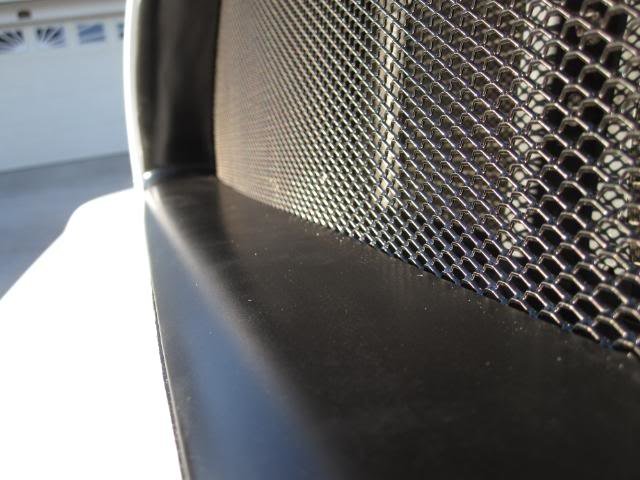

    I am doing mine right now. Just did the epoxy. Sprayed the "cage" low gloss black. I got enough left over to do the bumper and side triangles too.
    As soon as I git er done I'll post a photo. :D

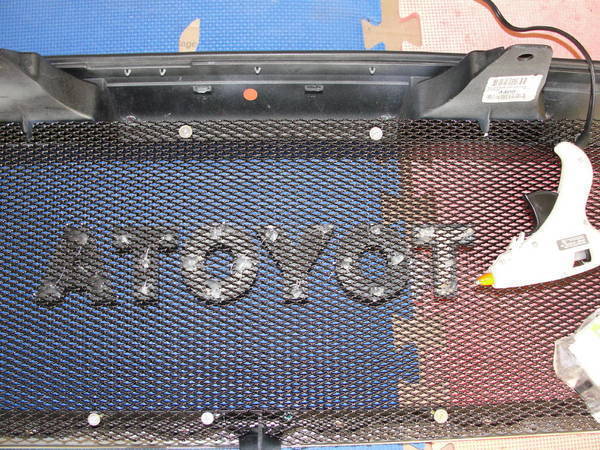

    Thanks to this thread I am able to completed Satoshi mod on my truck.
    For mounting I used plastic wall anchors, #6 3/4 in wood screws and plastic Epoxy to glue the anchors. All items bought from home depot.
    And used glue gun to mount the TOYOTA emblem:
