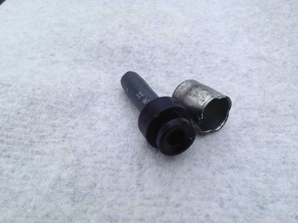

    Here's a question. Has anyone tested the breather on the tansfer case and transmission to see if it's actually a one-way valve? I'm in the middle of my breather relocation and put the new line in for the transfer/transmission last night. I checked to see if the oem valve was still working properly and discovered that it was a two-way valve. It looks just like the valve on the rear diff, except that there isn't a ball bearing in it.
    So is this a bad part, or is it intended to be an open line?
