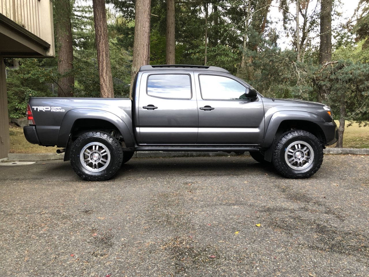

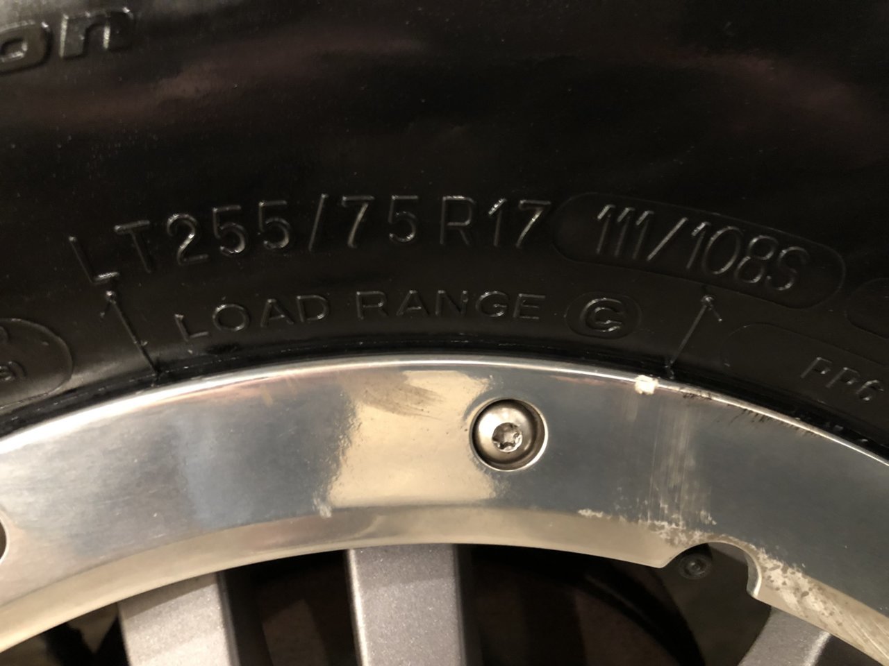

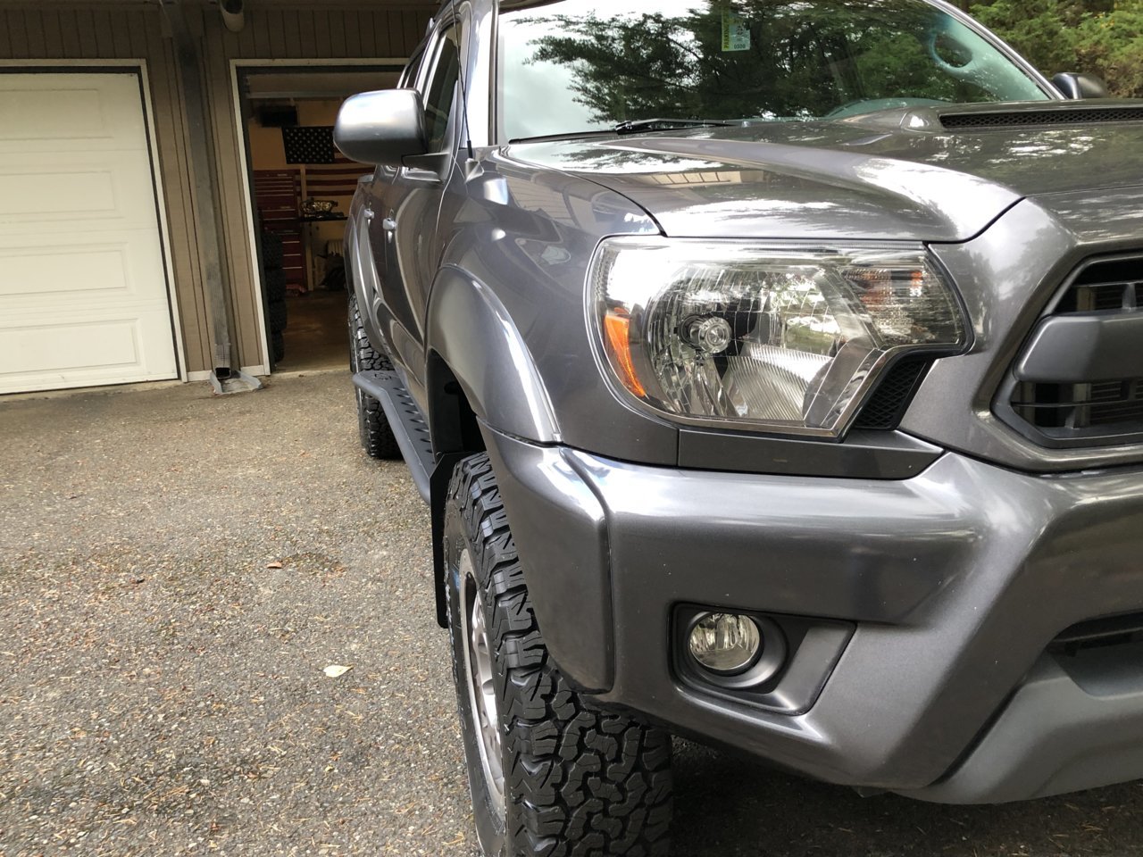

    On my last outing I needed a bit more ground clearance, and now new skids... While I wanted to add more ground clearance, I still wanted the truck to be a balanced build without adding performance robbing heavier tires.
    I reinstalled the overloads, added 1/4" top plate spacer to the passenger side for ~1/2" more lift and despite Toyotas efforts to counter the Taco lean in the Baja kit, it is still there. So I added a 1/2" top plate spacer to the driver side to resolve the Taco lean once and for all.
    1/2"+ rear lift gain
    ~1/2" passenger side lift
    ~1" driver side lift - now level!!!
    Then I bumped the tire side from 265/70R17 C-load to 255/75/R17 C-load. Diameter increases from 31.5 to 32, or about the same as running 275s (32.2) while inflicting only a ~1lb weight gain over 265s compared to over 8lbs gain for 275s. And they will hopefully avoiding rubbing issues by running the slightly skinnier tire with my increased offset TRD wheels and low profile Rokblokz flaps. The 10mm width difference is only 5mm per side, meaning a virtually unnoticeable change of 3/16" in reduction in how far the tire sticks out.
    To keep alignment precisely dialed in, I added SPC light racing UCAs. These have the most adjustability of all the UCAs, retain a nearly maintenance free moog ball joints with extended operating range, unlike maintenance heavy exposed uniballs that end up needing rebuilds. The SPC UCAs also have a unique rubber-in-polly bushings that allow stock like rubber maintenance free quietness of operation with improved polly performance over stock.
    To remount the overloads with the AAL I did have to remove the rear overload U-brackets. Drill out the center pin, flip the overload over on the concrete co it is resting on the U-bracket and give it the overload BFH treatment till the bracket pops off.
    Net ground clearance gain is a little over 3/4" or more (due to leveling).
    Baja Pro + 1" larger tire over stock = 2.25" more ground clearance than stock.
    Current setup = 3"+ more ground clearance than stock.

    Looks good except now your KO2s are on backwards. :boink::boink::boink:

    Unfortunately the 255/75/R17 in C-load is only available in BSW. Disappointing, as I really like the white letters. But function over form.

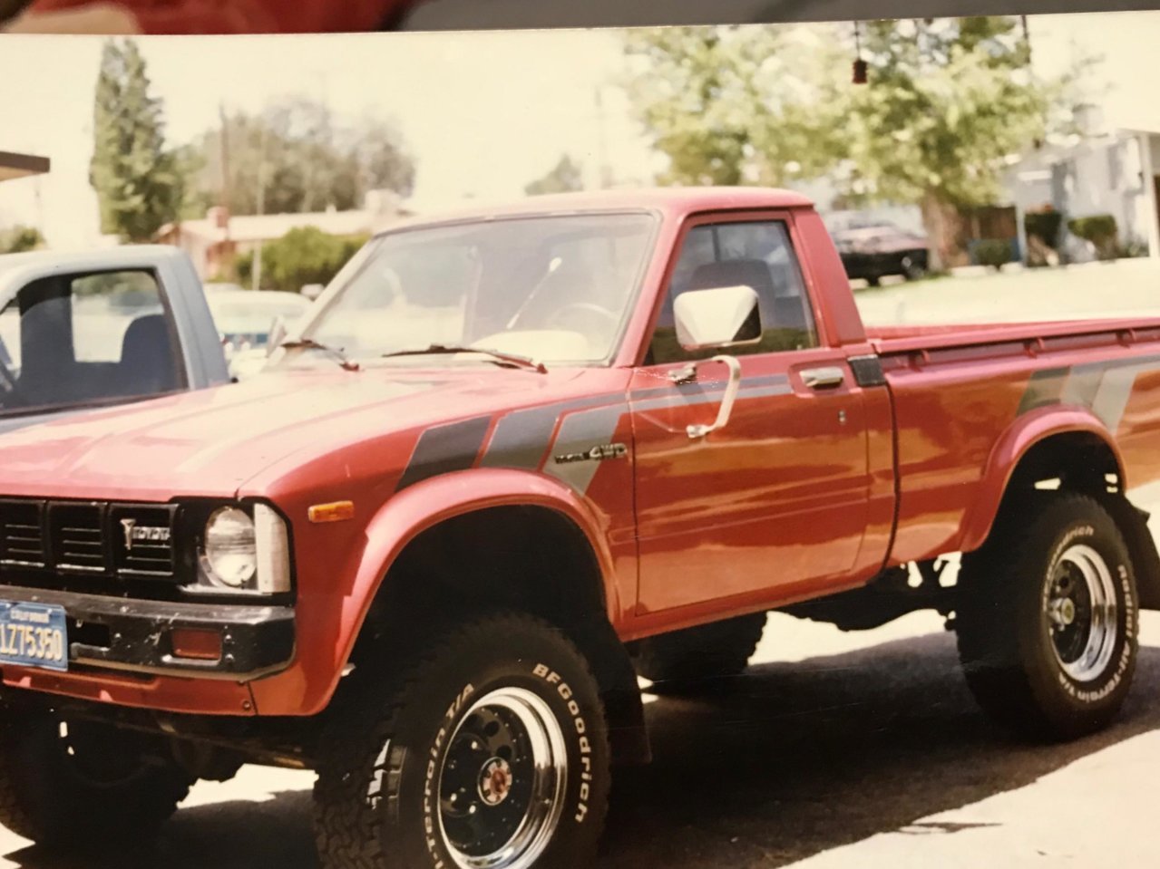

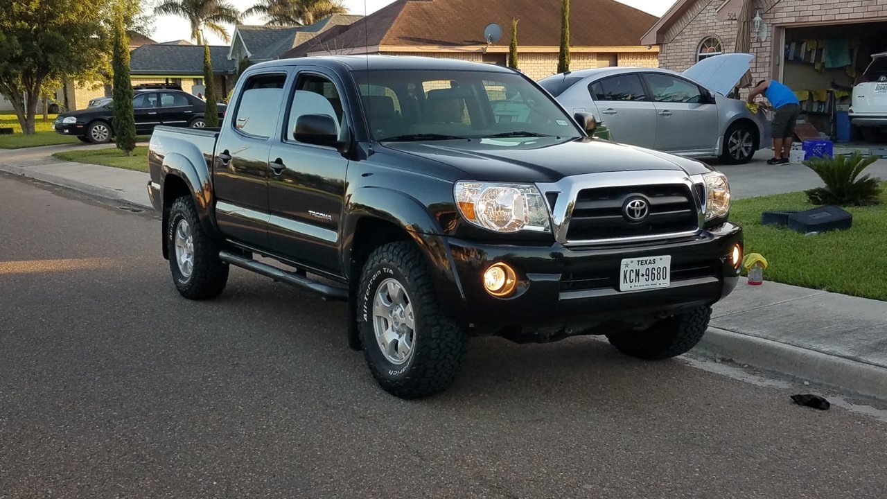

    BFGoodrich has used the KO2 tread pattern for more than 30 years! My dads tires in 1983:
    My tires bought 35 years later:
    I love these tires. Mine are 265/75/16 E-Load, and I didn't experience much difference in my MPG's. The only change I noticed was a slightly heavier steering wheel.

    Beautiful classic Toyota!
    The tires tread pattern is similar looking on the surface, but it is definitely not the same. The KO2s have larger voids and many other enhancements:
    https://youtu.be/Kp5dVUol778
    ALI3N_123[QUOTED] likes this.

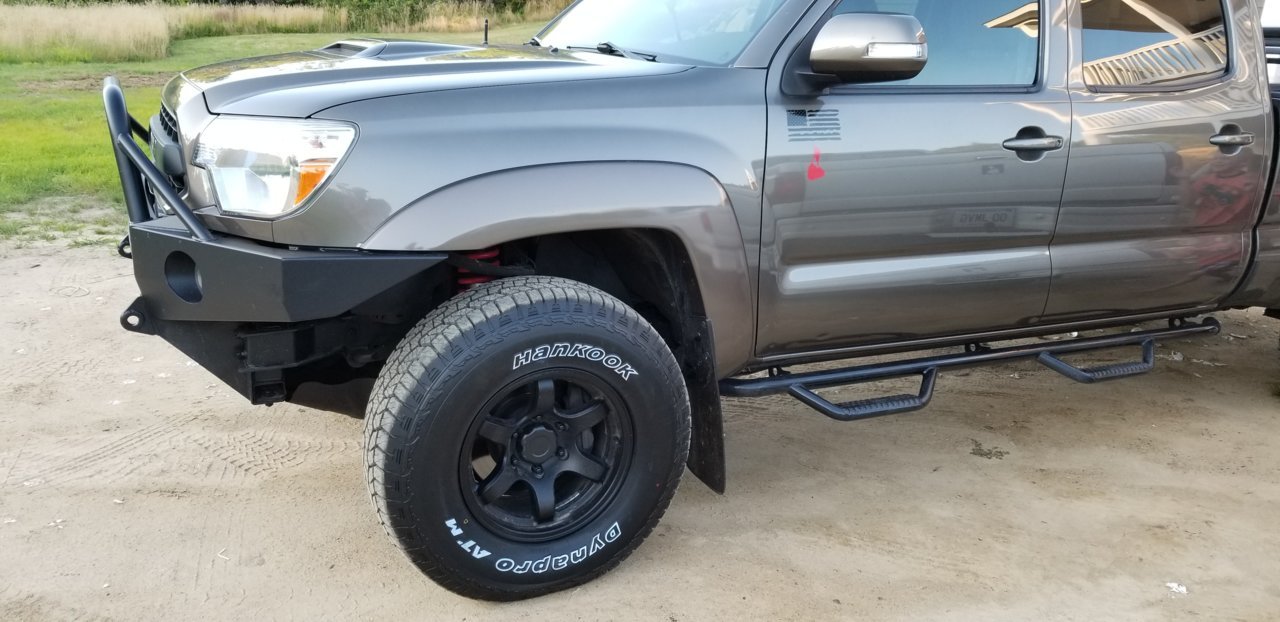

    FN Wheels countersteer offroad 19lbs each
    265/75/16 Hancook Dynapro ATMs C-load 37lbs each
    About as light as you can get....$1017 setup when you line up all available deals
