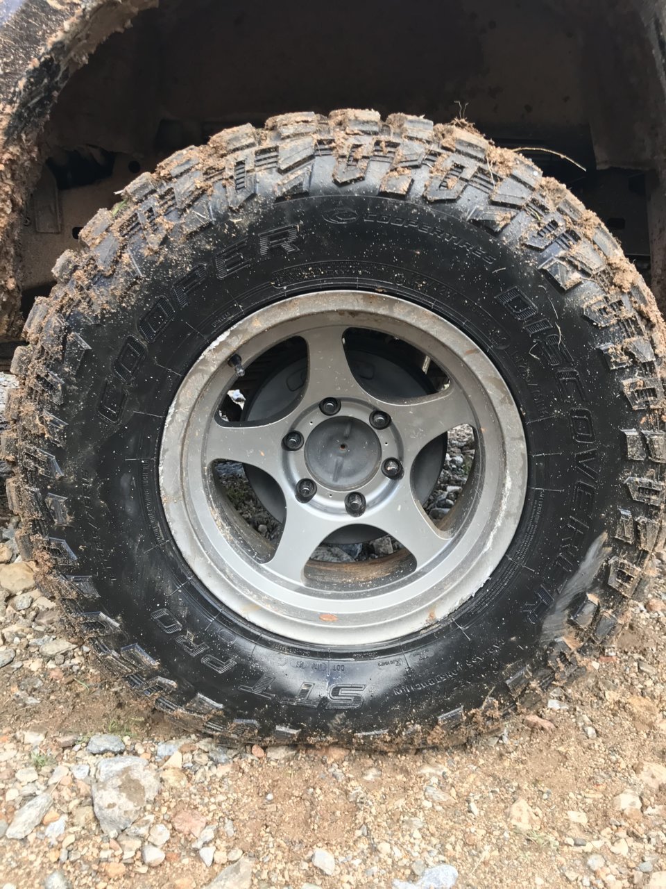

    255/75r17 Cooper STT Pro, C-Load, 51lb
    17x8.5 SCS F5, 22lb
    73lbs total

    Nicely done!

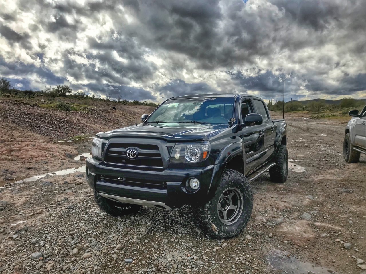

    18lb WHEELS.
    59lbs TIRES for me.
    crashnburn80[OP] likes this.

    Those are some light weight wheels.

    They’re fantastic. FN wheels are legit. They also only cost me $725 including locking lug nuts for five of them (one of them I got for almost free because it was “blemished”). Dustin is the man. At fn wheels.
