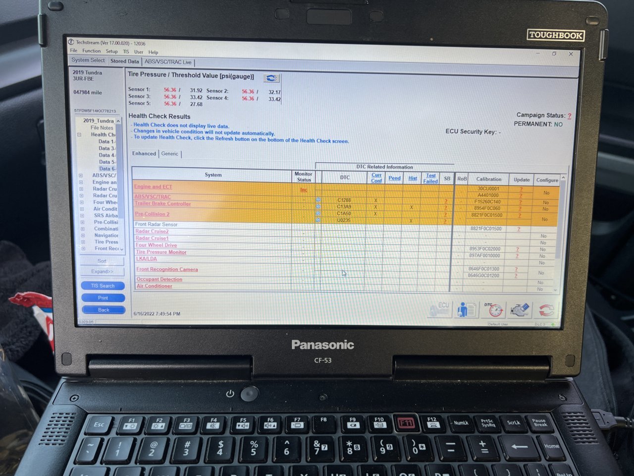

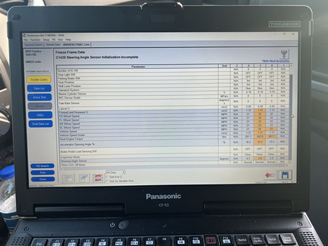

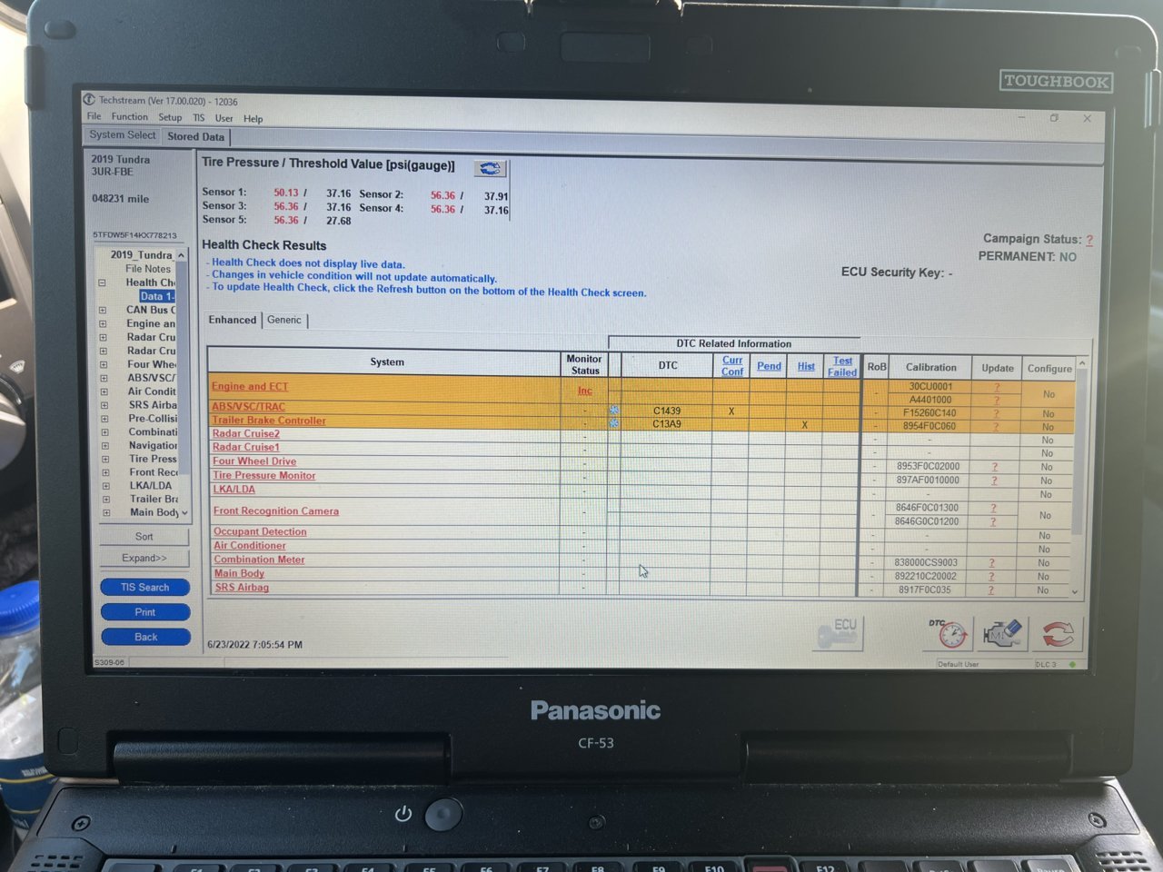

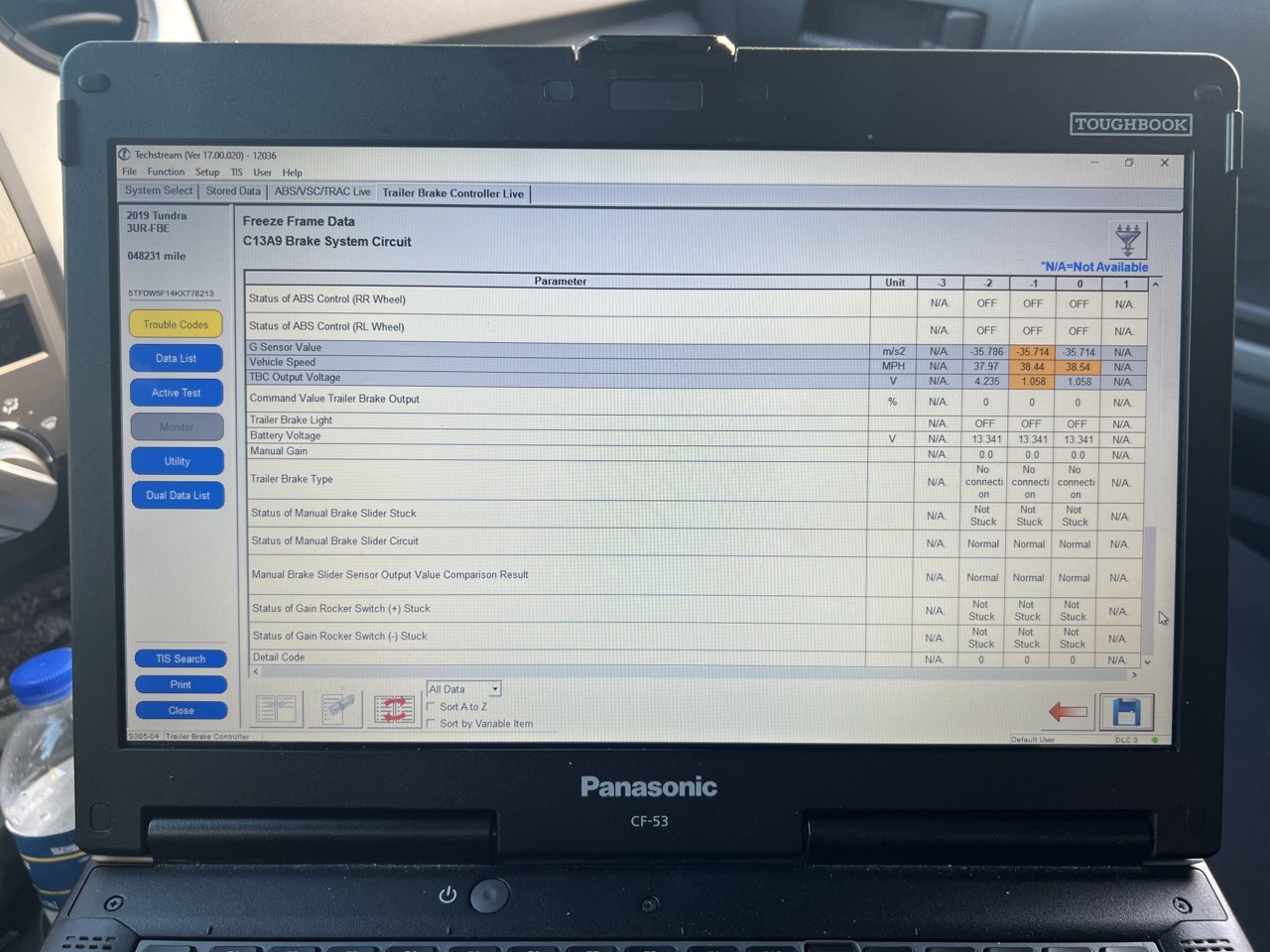

    Here is what I have only these two are coming back..C1439, C13A9
    Please explain once more where i should start. Please provide step by step procedure, I have a couple questions boss..
    3AB73090-B96A-4612-800C-D3725CEAED44.jpg 65612C63-05AB-42E0-A2C6-43570B2F1BA3.jpg
    These parameters highlighted in orange what is the problem exactly..
