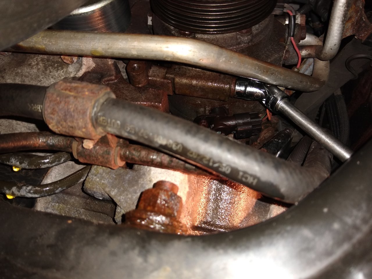

    if you are undertaking this job,and not disconnecting the AC lines, invest in a set of flex sockets... i could not figure out a way to get the bolt out without it. also have a ton of different socket extensions on hand!! the AC bolts are hidden away and you almost have to be a contortionist to get to them. FLEX SOCKETS SAVED THE DAY!!!
    i saw some people using small wrenches in there and while it will fit, i could not get enough leverage to break the ceased bolt... you will need jedi patience.

    Hey Chris, just got my 2006 TRD Sport. Had a shredded belt so did the 3 idler pulleys no problem. Have the tensioner arm and am curious if you have any pointers for replacing the tensioner from the bottom? Really sounds like a pain to do it from up top and might be out of my wheelhouse as I’m no mechanic. Thanks for your time!

    Its not about experience just how to get your hands in to get the 2 bolts which are below the ac compressor and the inner fender well as shown in Goosie0080's pictures a couple post up.

    man thank you for posting this. i am doing this exact process right now. can you please describe in detail how you got those two bottom bolts out? did you use hand tools? impact wrench? im having a hard time even getting a wrench in there
