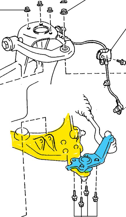

    Phoenix, AZ
    2001 Tacoma SR5 Xtended cab 3.4L 5Spd
    Is the “lower ball joint” the same as the LCA (lower control arm)?
    Thanks.
  9. Jun 29, 2023 at 5:57 AM
    #69
    glwood6
    glwood6 Well-Known Member
    Jul 25, 2008
    #8125
    2,468
    Gary
    Albuquerque, NM
    03 XCab Prerunner
    Bilstein 4600 shocks.
    The lower ball joint connects the lower control arm to the steering knuckle.
  10. Jun 29, 2023 at 8:07 AM
    #70
    Andy01DblCabTacoma
    Andy01DblCabTacoma Well-Known Member
    Mar 12, 2021
    #359086
    3,931
    Andy
    San Diego, CA
    01 Double Cab v6 4x4 TRD
    F: Kings SPC, R: 5100s+J59s. Custom armor.
    The Lower Ball Joint (blue) and Lower Control Arm (yellow) are different components.
    koenbro[QUOTED] likes this.

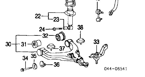

  11. Jun 29, 2023 at 4:17 PM
    #71
    koenbro
    koenbro Well-Known Member
    Feb 7, 2017
    #209951
    285
    Phoenix, AZ
    Super, thank you! Very clear response. In the diagram I use it is item #33:

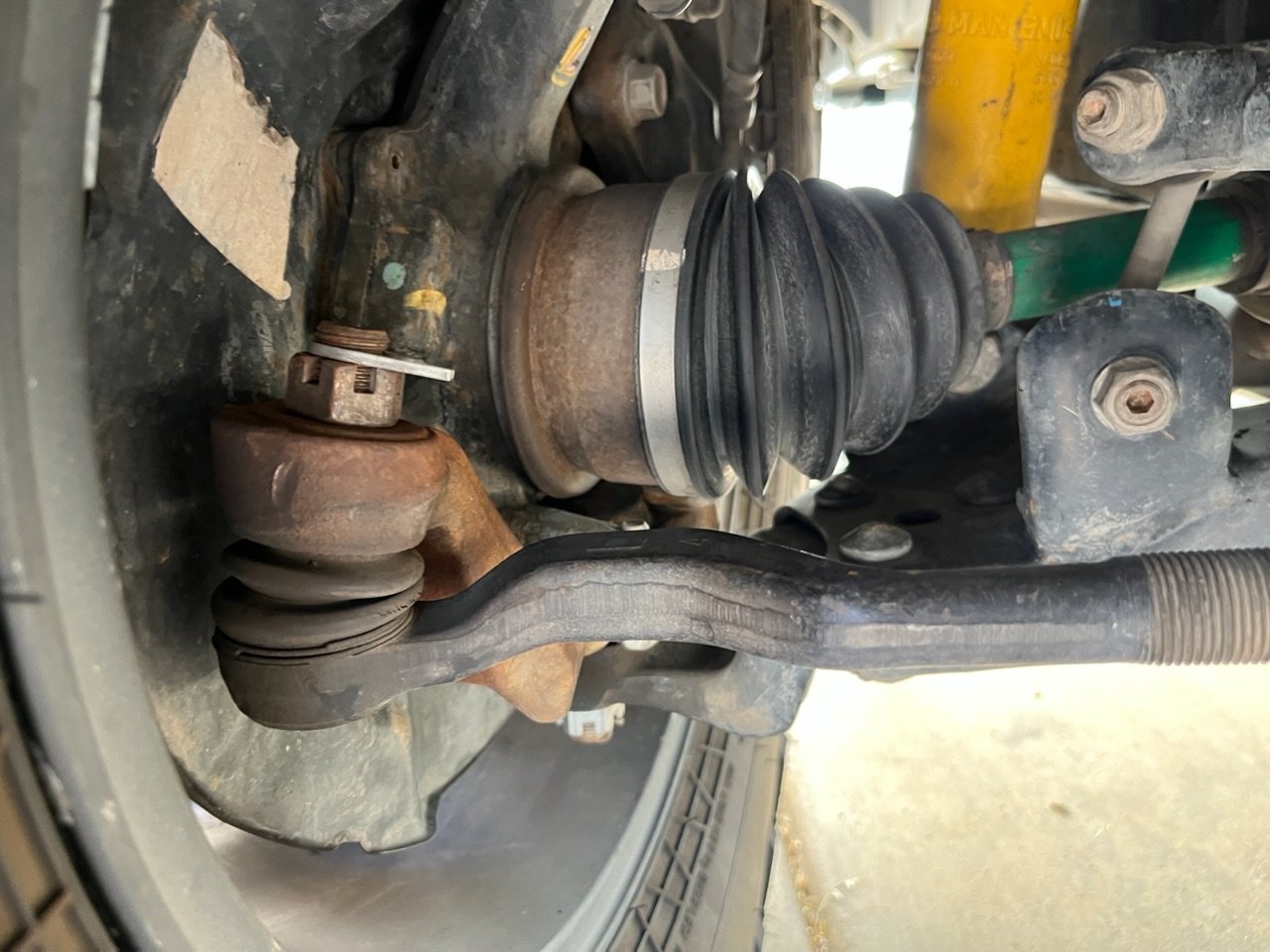

    OK I am searching:
    (Source)
    And this is another:
    (Thread Source)
    Bolts for LBJs.
    Here is Dan's writeup.
    Am I missing smth?

    Do you have the boot protectors on your LBJ?

  16. Jul 1, 2023 at 4:27 PM
    #76
    koenbro
    Feb 7, 2017
    #209951
    285
    Phoenix, AZ
    I do.
  17. Jul 1, 2023 at 5:12 PM
    #77
    Nessal
    Nessal Well-Known Member
    Dec 30, 2012
    #94081
    1,433
    Texas/Bay Area
    2003 V6 4X4 TRD DCAB
    That picture doesn't show the boot protectors. That is your CV axle boot and steering rod end boot. The LBJ boot covers the LBJ. You can google a picture of the LBJ to locate it.
    I suspect you have the boot protectors since in 2001 is when they started to install them. If you have the boot protector, then order these below.
    LBJ 43340-39436 & 43330-39556
    LBJ bolts 8QTY X 90019-10933 torqued to 37fl lb

    Does it have a boot? And if not can I still buy a LBJ with boot and install it or would that be incompatible?

  20. Jul 2, 2023 at 7:39 AM
    #80
    02hilux
    02hilux What do you mean there’s no road, I’m here
    Sep 14, 2016
    #197244
    6,187
    Planet: EARTH
    That picture shows no boot protector. 2001-2004 IIRC came with boot protector from Toyota. The boot is held in place by 2 opposing LBJ bolts. The bolt will be different from those that didn't come with the boot.
