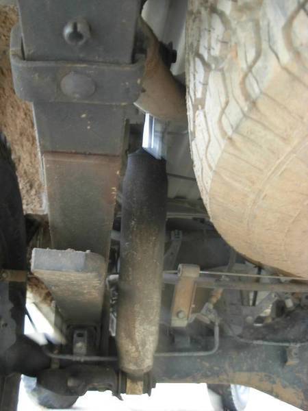

    sorry for the delay
    here are the pics. got the front, the bad ball joint, and the rear.
    hopefully these will help
    i hope y'all can help me out here... Big overhaul starts today
    ps: sorry for the mud, it rained here all weekend... couldn't help myself.

    by the blue coils, i assume it is the Fabtech dirt logics...
    there have been many in the past who had issues with their older generation coilovers...
    the adjustable 5100s are supposed to be pretty good, however, you will need your stock coils (non TRD are the better ride), but since you dont have them anymore, you may have to look into a whole new set of adjustable coilovers...
    if you got the money, Icon, King, Camburg, SAWs, and Fox are great options...
    check out for some good package deals...

    yeah, i remember it said fabtec somewhere in the blue part, and the shocks themselves say fox on them.

    You can check and see if the fabtech dirt logic coilovers you have in front are rebuildable

    i don't think the shocks themselves are fabtec... i haven't had any problems with them as of yet...
    matter of factly... i'm not 100% sure they need replacing... they have a valve on them, i assume it's for filling them? nitro shocks maybe?
    i know the rears are blown... they're leaking from the time i went car crushing and over compressed them. shouldn't i replace all four if i'm doing it at all? i might need new leafs too... they squeak pretty bad.
    like i said though... i do not want to loose any lift. i like my height... 3 inches sus, plus 3 body... i'd love to go full 6 suspension wise, but it's expensive... and i'm a lil worried about things like wheel articulation, and strength... i can be tough on my rig.

    Yeah if you dont see the fronts leaking, id leave them alone, or to make yourself feel better u can go get the fronts serviced(re-filled or charged) and go with some bilstein 5125's for the rear
