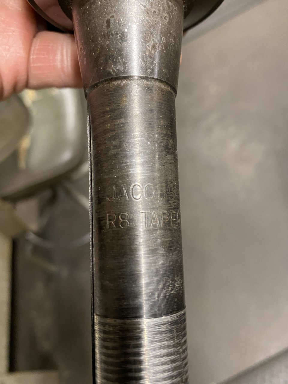

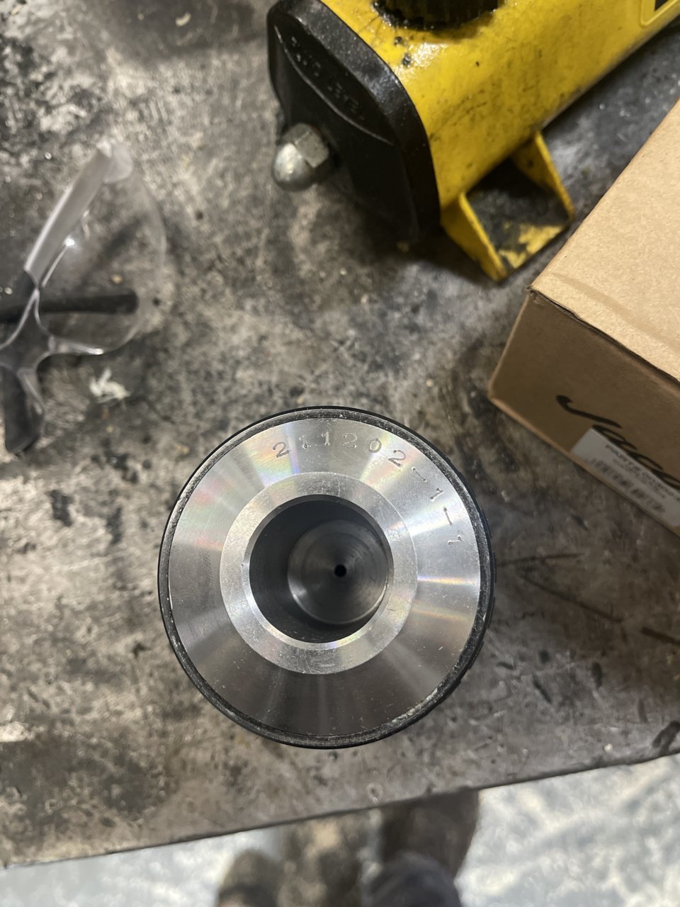

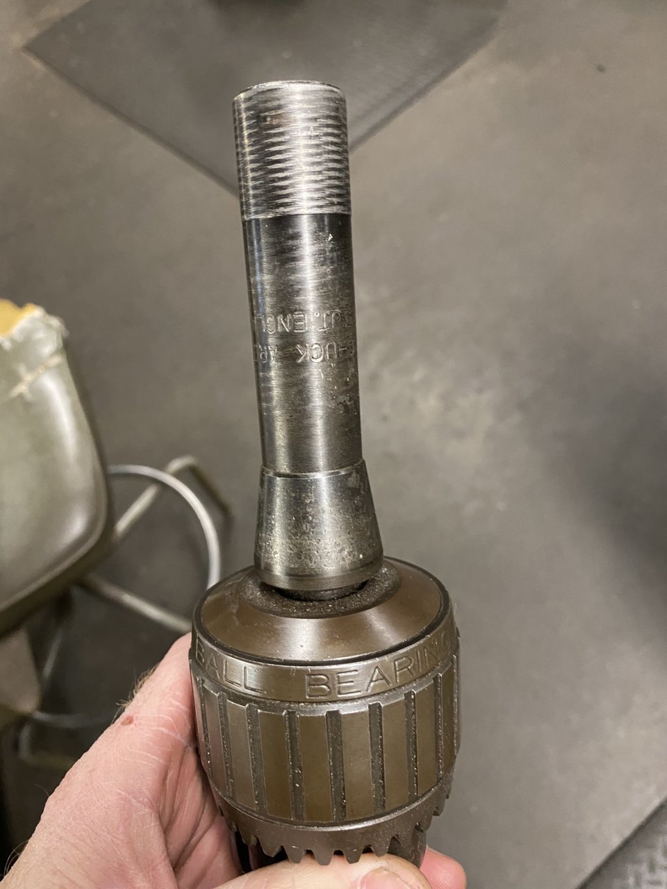

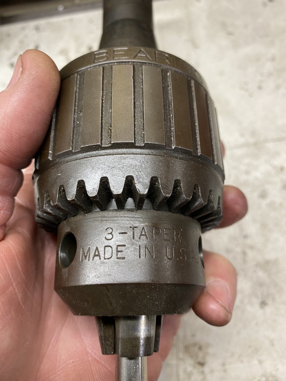

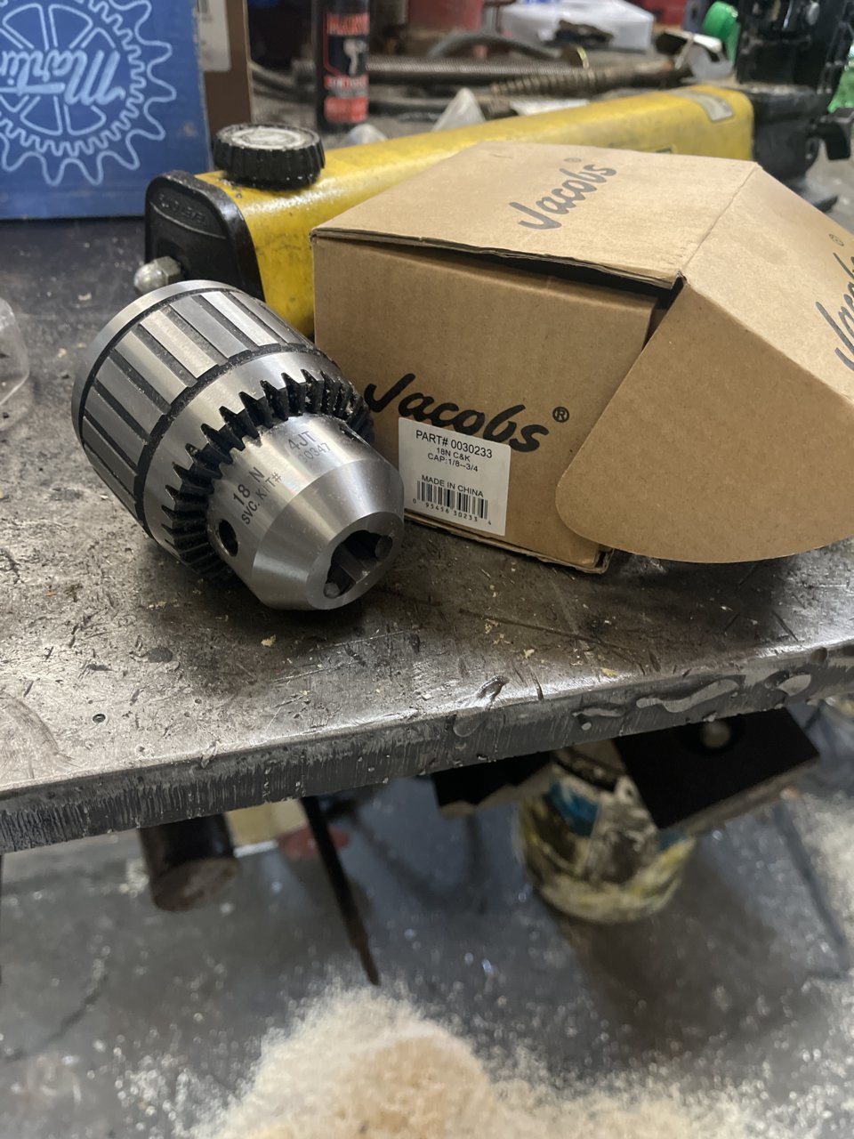

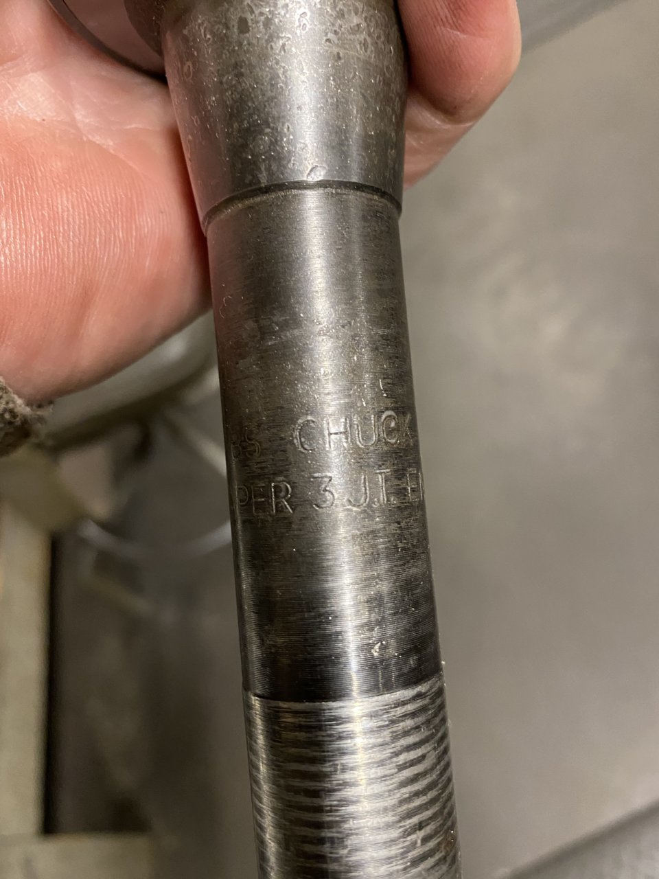

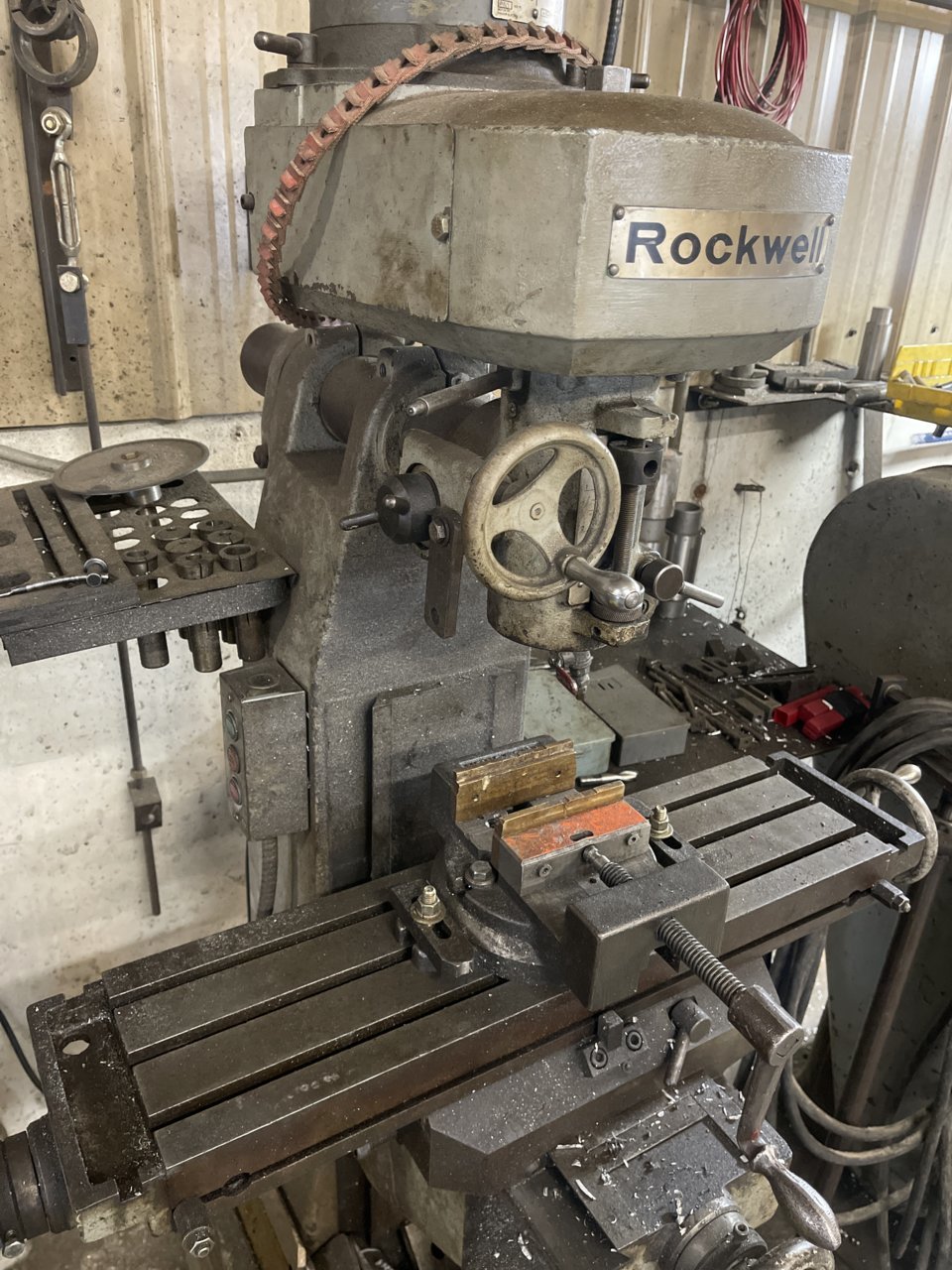

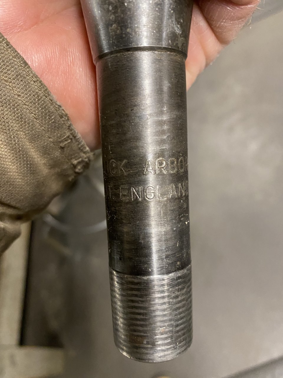

    Your chuck says 4JT which is a 4 Jacobs taper. You need an R8 to 4JT adapter. Ours is a 3T cause the chuck is smaller.

    Big time thank you, I appreciate not having to chase over hell and back to find that info. Now to tell my boss he spent $400 on a chuck that needs another part for us to use... :rolleyes:

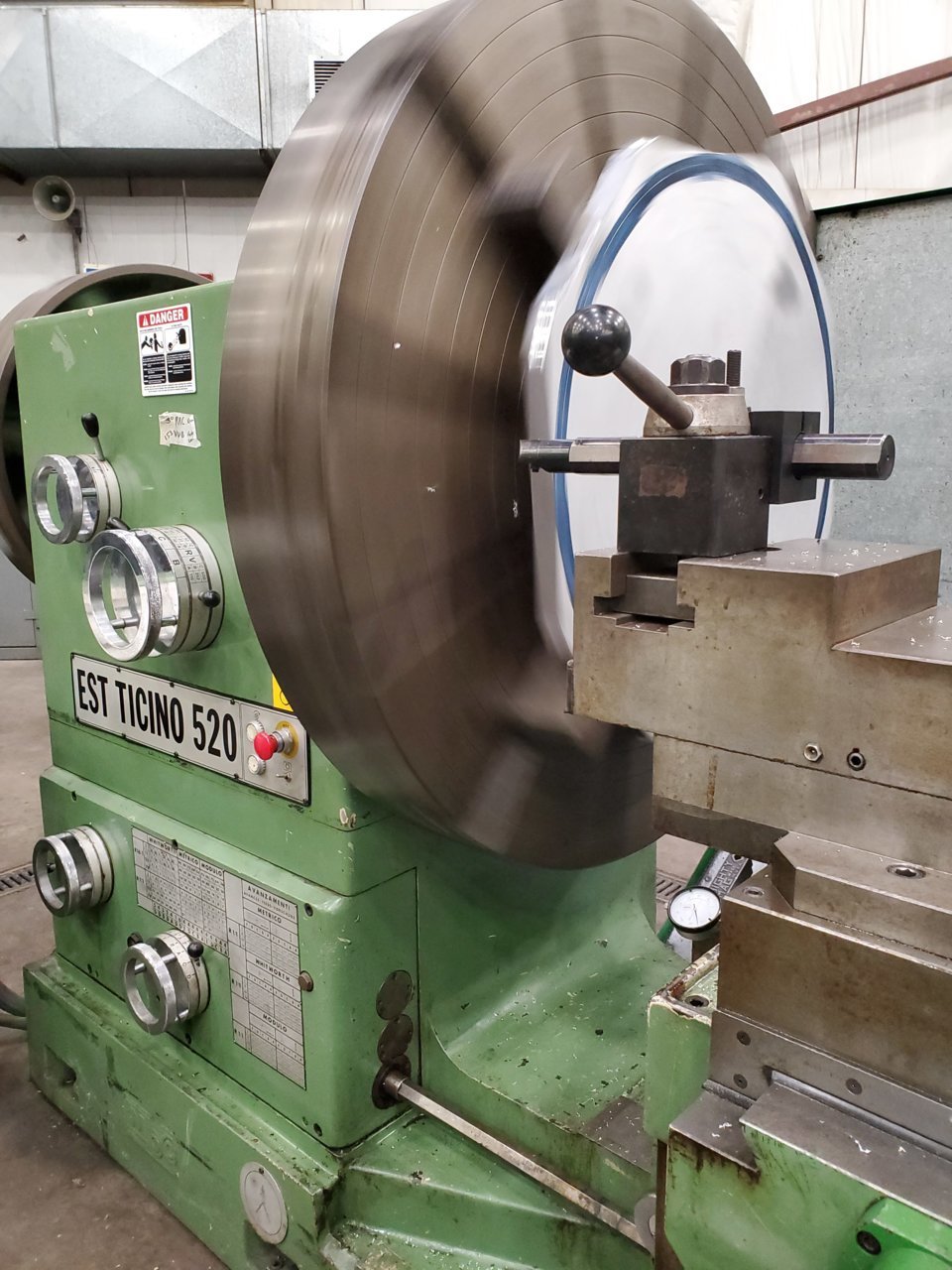

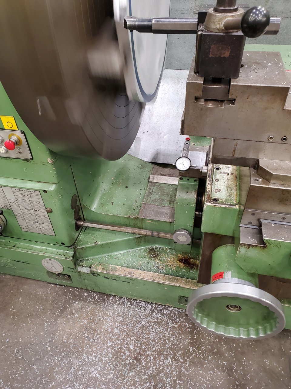

    Ugh, this is going painfully slow. If only I took time to shorten everything up. Close gap between ways and chuck:facepalm:20220113_133321.jpg

    But those cool machine gun sounds from all the interrupted cuts :infantry:
    How big is that chuck, 24"?

    For those learning what I'm talking about is closing up this gap. You've all heard me talk about having everything ridgid as possible. If I closed this gap then everything would be more solid. I wouldn't have that boring bar hanging out there and could have chose a better tool entirely. I even had my wrench on the nuts that lock those ways down....said nah, I'll just do this....:frusty:

    Haha yes is stead of tink tink tink tink I got that times 2 because I cut them corners off!
    It's 47.5 " diameter chuck and little over 9" through bore. Things a beast. If set up properly it would take .150" depth of cut, in steel, and not even break a sweat.

    Ugh. I think going to go grab me a diet Dr pepper. I'm thinking about regroup and set this machine up proper. I'll be time ahead if I do.
