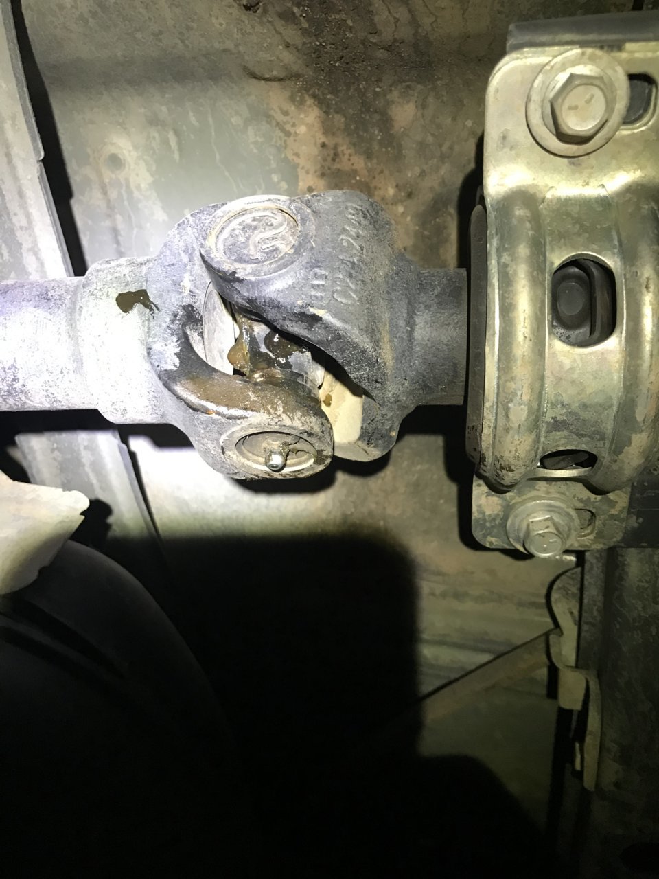

    Any shops in the Seattleish area that would grease my zerks, I have no clue how to do that.

    Just buy a grease gun & do it yourself. It'll be cheaper that paying someone to do just 1 or 2 times. And you'll know if it was done right & with the correct grease. It's really easy. I would never pay a shop to grease zerks.

    Harbor Freight is your friend:
    https://www.harborfreight.com/grease-gun-with-pistol-grip-66664.html
    From the pic, it looks like it might not come with a tip. Check that before you leave.
    https://www.harborfreight.com/14-oz-sta-plex-extreme-pressure-premium-red-grease-40710.html
    One note when lubing spiders, you want more than just the hearing / seeing the first bit of purge. You want to see new grease coming out of all four seals.

    It isn't bad at all. Just something different if you haven't done it before. I definitely learned a lesson after doing it for probably 35yrs. I wasn't getting a purge out of all four caps and had a couple joints fail on my old bike. They weren't high quality units to start with.
    The only tricky one is the front shaft at the t case since you have to pull one small shield / skid.

    I believe users manual recommends NLGI no 2 grease. That is what I bought and did all mine myself. It’s VERY easy & can prevent U-joint failures. I kept pumping until the dirty black old grease stopped coming out and the fresh grease I was pumping started coming out.

    Sweet, I'll get it done asap. I found some pictures online and screenshotted it for referance
