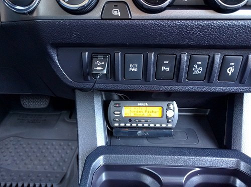

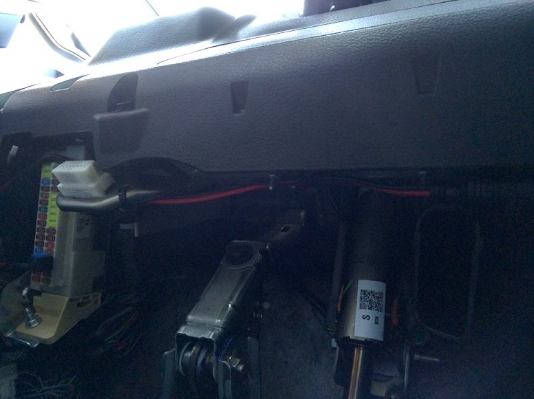

    Added a hidden 12V outlet via add-a-fuse to power my old school SiriusXM player
    Also reorganized the buttons to make the wiring cleaner without having to drill pass-thru holes

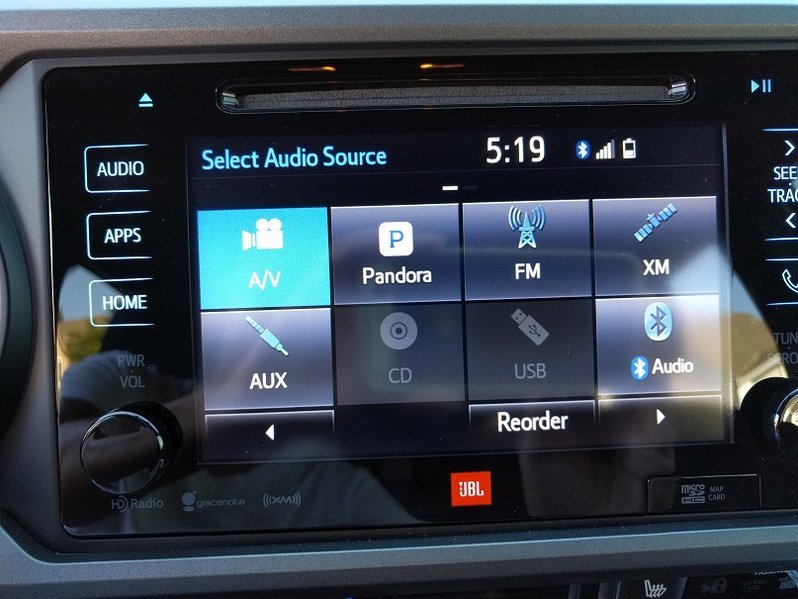

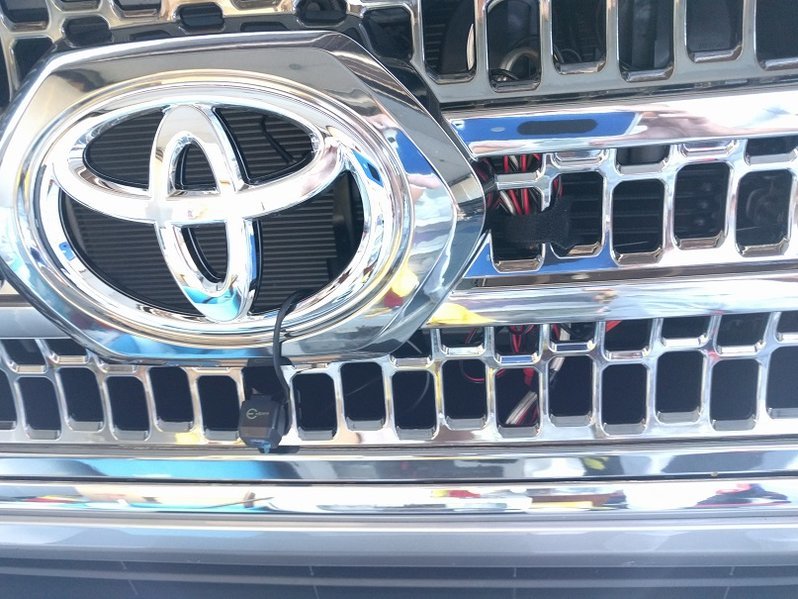

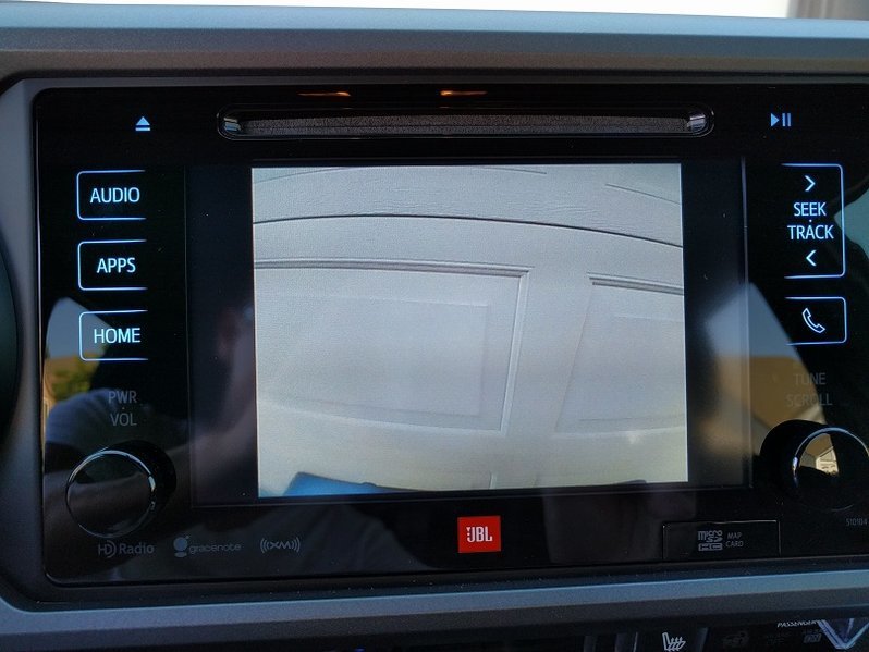

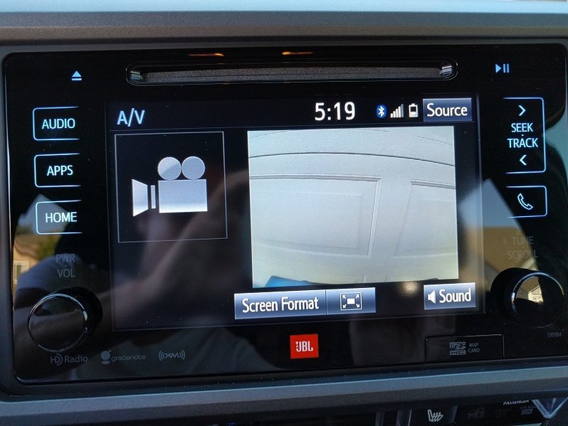

    Used the following camera: https://www.amazon.com/gp/product/B00XTZUHOM/ref=oh_aui_detailpage_o02_s00?ie=UTF8&psc=1
    • First VIMTY had a bad composite connector
      • Bummed out because the bad VIMTY let me listen to the AUX audio source with the camera on. Crux stated that was not intended and couldn't tell me how to make the replacement do it lol....
    • First camera was only B/W after a day's use (be mindful this camera is PAL/NTSC so don't confuse that for a faulty unit)
    • Temporary install location running from from the door panel down the hood and in to the grill (waiting on BAMF)
    • I'll be doing fire roads with some inclines/declines this weekend so will post updates next week
      • the bottom of the plate holder is visible because this is primarily for parking not wheeling
    • Still unsure if I'll use an AOB switch to activate cam or see how long it lasts always powered (Esky CS is pretty good)
    • Self verified as well as from multiple passengers that the feed is real time / lag free

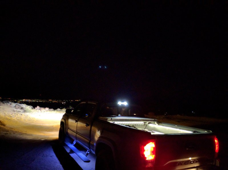

    @OffRd 5TRMTPR I'll try take some other pics but just know they're bright and produce a really clean cutoff. I know Morimoto is supposed to be brighter but I've used XD for all my past projects as well as for people I know. I was willing to try the Morimoto but the alleged bounce issues turned me away. Attached is a pretty true representation of the 5000K bulbs. They match the LED strip below and have a tinge of blue when looking at the light but still produce what I consider a clean white from behind the light.

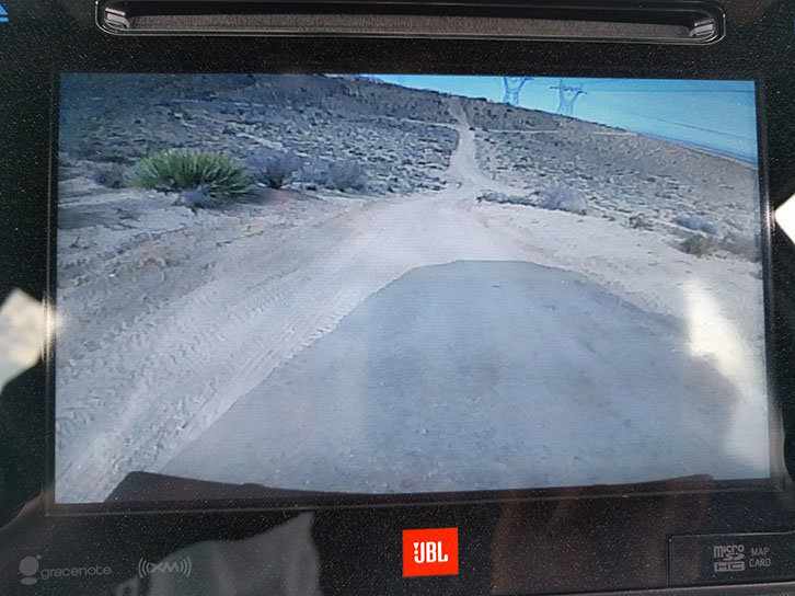

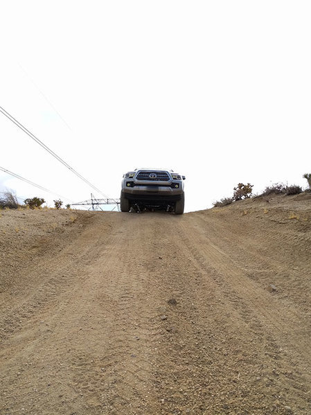

    @Mike330R Happy to report that the Esky is still going strong even though it's running the whole time the truck is on. The Crux VIMTY-05 is worth it, not just for the input but it's VIM properties. I find myself always activating it when I start the car.
    Phone reported this as a 42 degree incline, I just know it was steep enough to make me think twice about getting out of the truck and walking in front of it to take pics!
    Compare the dash view to the camera view (power lines make a good reference point.) Keep in mind placement of my camera was primarily for wife parking duties (hence the bottom of the plate frame being visible) I'm pretty confident that with the VIMTY and this or a dome camera placed on the undercarriage would be a good OR camera solution.2016-08-21 08.53.14.jpg 2016-08-21 08.53.02.jpg 2016-08-21 08.52.22.jpg

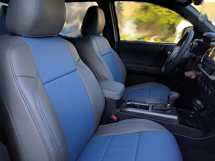

    Clazzio's Installed:

    This?:
    https://www.amazon.com/Crux-Interfacing-VIMTY-05-Activation-Vehicles/dp/B014UOXUG2
    and which camera?
    How do you activate the front camera?
    All plug and play?

    @Mike330R Yes, make sure it's one that's programmed for the 2016 Tacoma / Entune JBL
    @HalfWayThere Nope, the only mod needed is if you want to wire a hard switch for activation
    Default Config = PNP then press and hold the up button on the left side steering control for 3 seconds to activate. Even cooler, if you press for longer than 3 but less than 6 it actually switches to the CRUX A/V source..not sure it's intentional but for a bumper cam it works great and eliminated the need for me to wire a cam switch.
