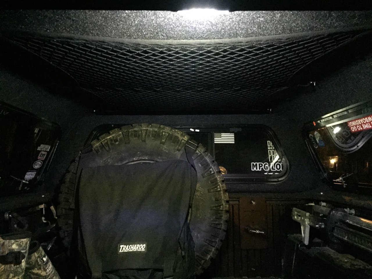

    This is awesome! I've been wanting to do this exact thing to mine to put smaller items up there or even clip a few carribiner to, but I didn't want to drill any new holes. Which net is this and will you please share how you secured it to the roof?

    I used these d-rings:
    http://www.cargogear.com/OneItemInfo.aspx?partnum=SGDRING
    Here's the netting:
    http://www.amazon.com/gp/product/B0093XPC94?psc=1&redirect=true&ref_=oh_aui_detailpage_o00_s00
    I bought some extra clips to support the middle of the netting as there are only clips on 4 corners of the net.
    http://www.amazon.com/gp/product/B00E011L3A?psc=1&redirect=true&ref_=oh_aui_detailpage_o00_s01
    I simply in bolted the bolts holding the track down one at a time and slipped the d ring on the end and bolted it back together. Clipped the netting on and you're good to go. Worked perfectly

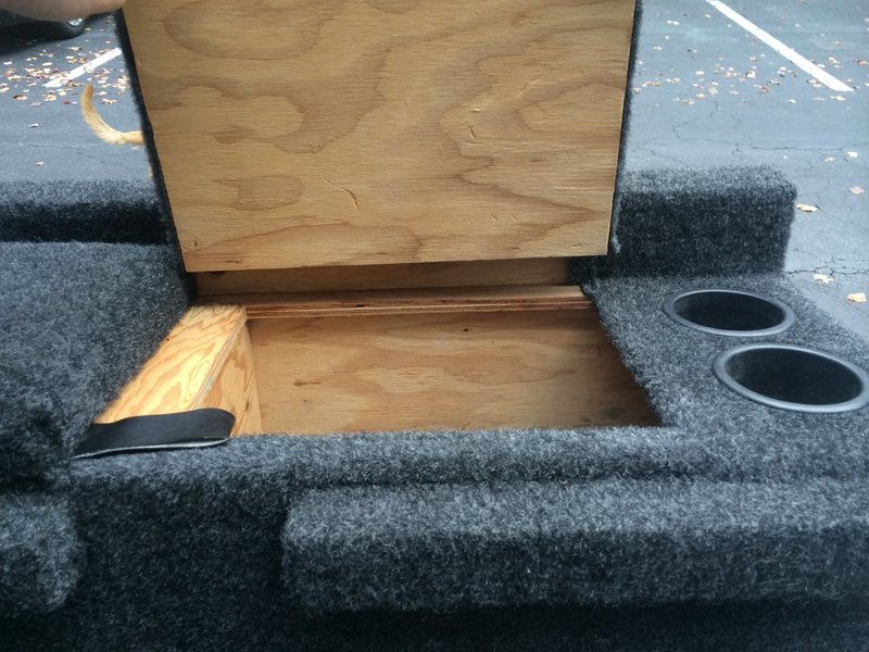

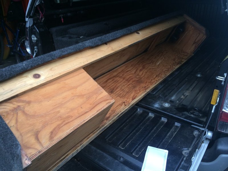

    Wow took a bit longer than I expected. I made some measurements and left the paper in the garage. Sorry for the delay. Here are a few close ups.

    Thank you! I've been thinking about that every single time someone reaches into the back. I've probably asked a half-dozen people in the past month to "watch your belt buckles!"

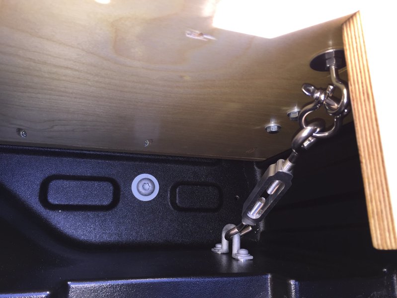

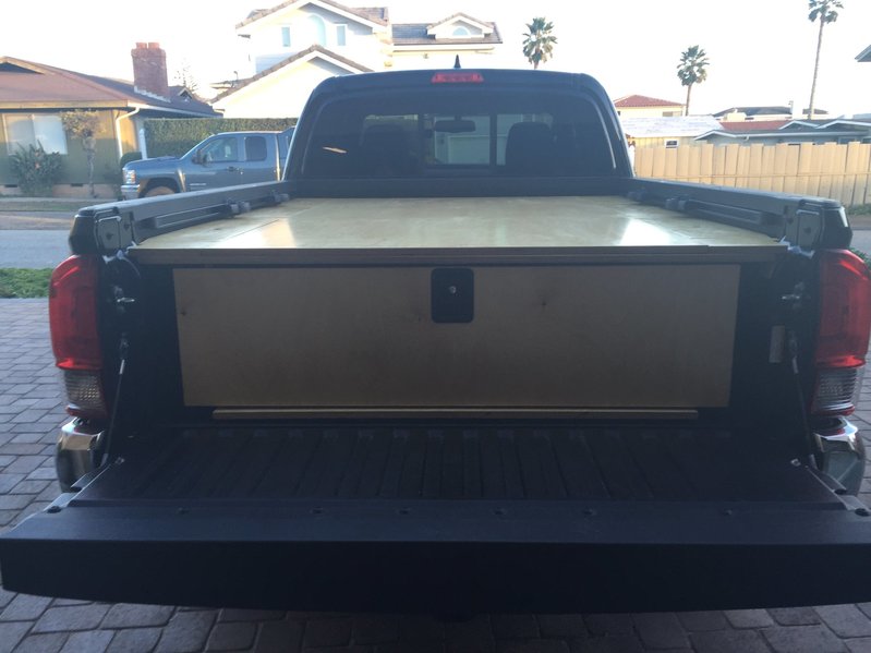

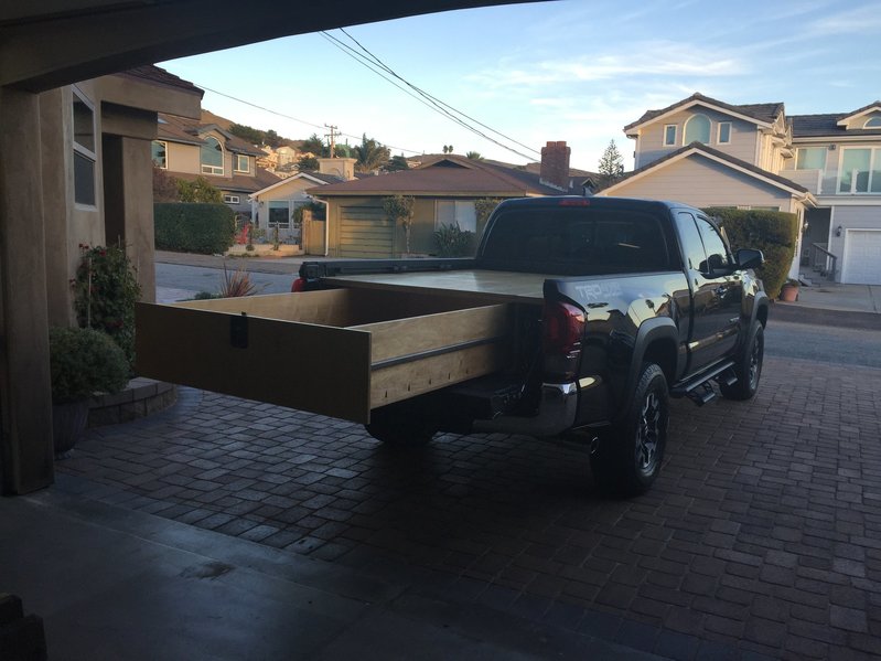

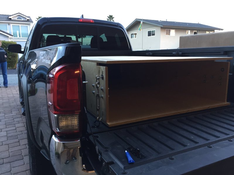

    Still waiting on my ARE MX series, should be in late January. Here is what I built for sleeping and gear/surfboard storage.

    I have a leer cap and was wondering if I can add a cargo net or does it need to been done on order. I have the thule rack already. thanks.

    Anymore build pics? Or build sheet list? This is some niiiiice work!

    This was added after the fact. It is a cheaper, DIY alternative to having Thule spend a couple hundred of your dollars to add this option.

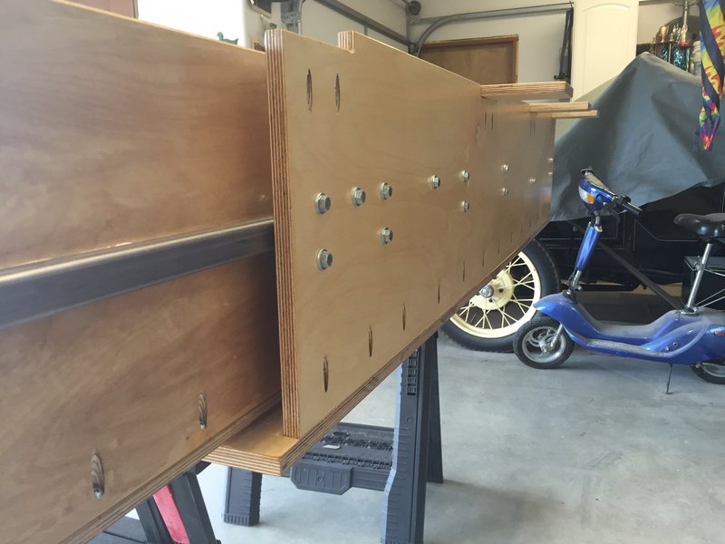

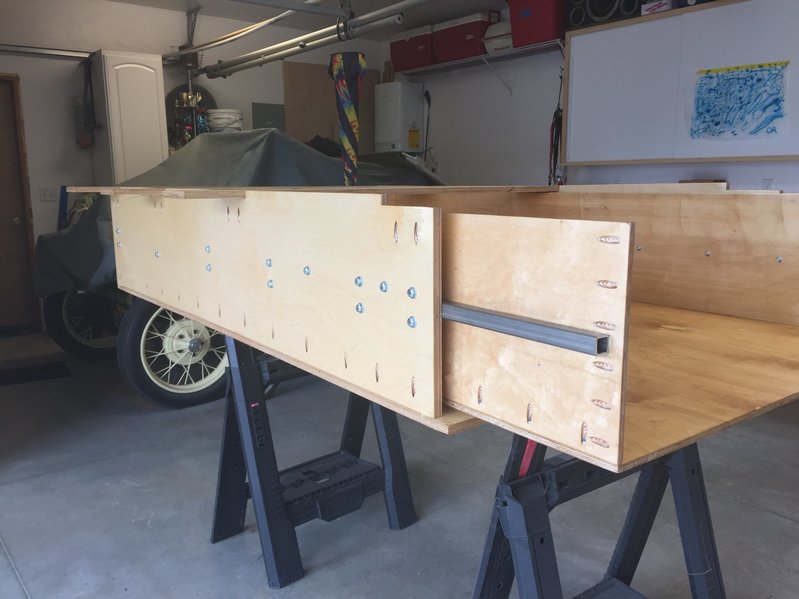

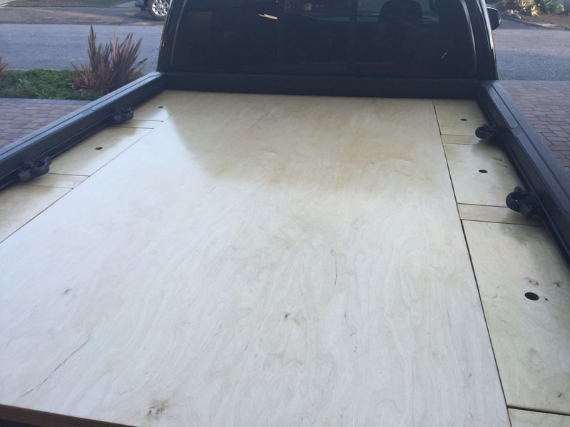

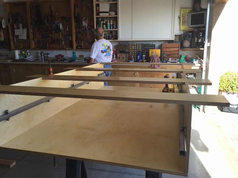

    Don't have a build sheet, but here are some more build pics. I'm happy to answer any questions you have.
