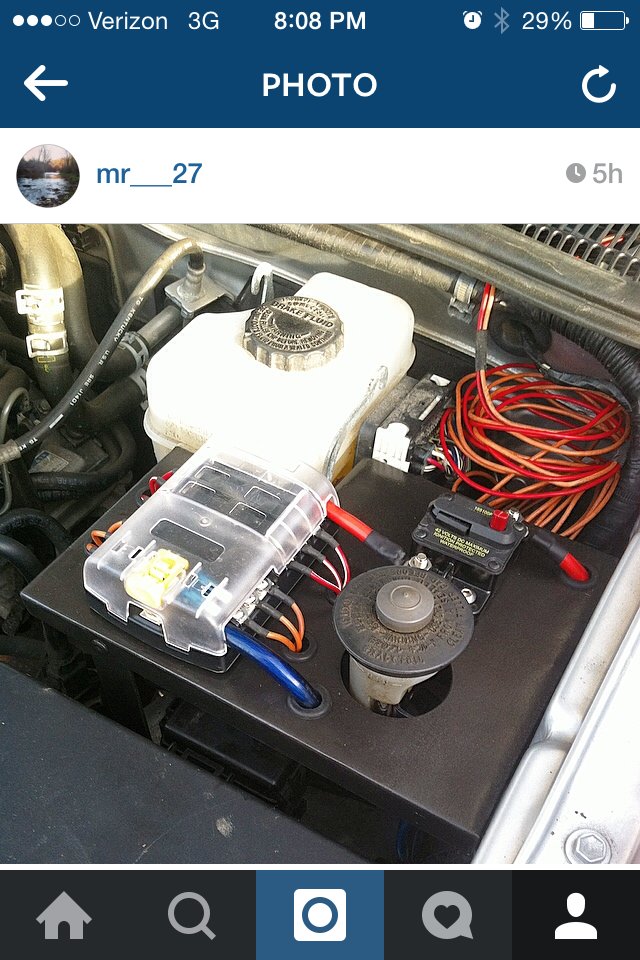

    Just finished up my mounting plate today. I'll get it wired up tomorrow or Saturday.

    Great Job! This install came out nice! I can only imagine what a PIA it was getting those bolts to match.:woot:

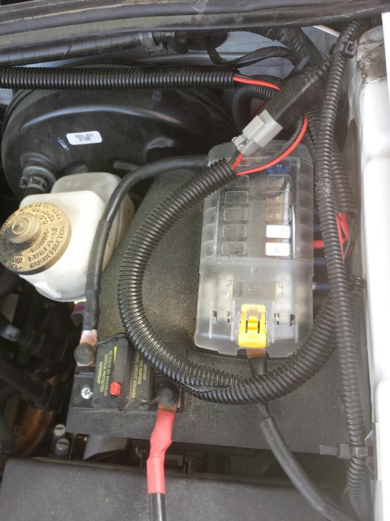

    Many hour of work!!! 6 pin waterproof connection and 2 pin waterproof connections. 100amp breaker and a remote switch for rock lights. Everything is quick disconnect. 12 circuit positive and negative buss box. More to come:)

    Very well done FJ

    thank you for being one of the ONLY people that mounted the box properly recessing it in the plate.

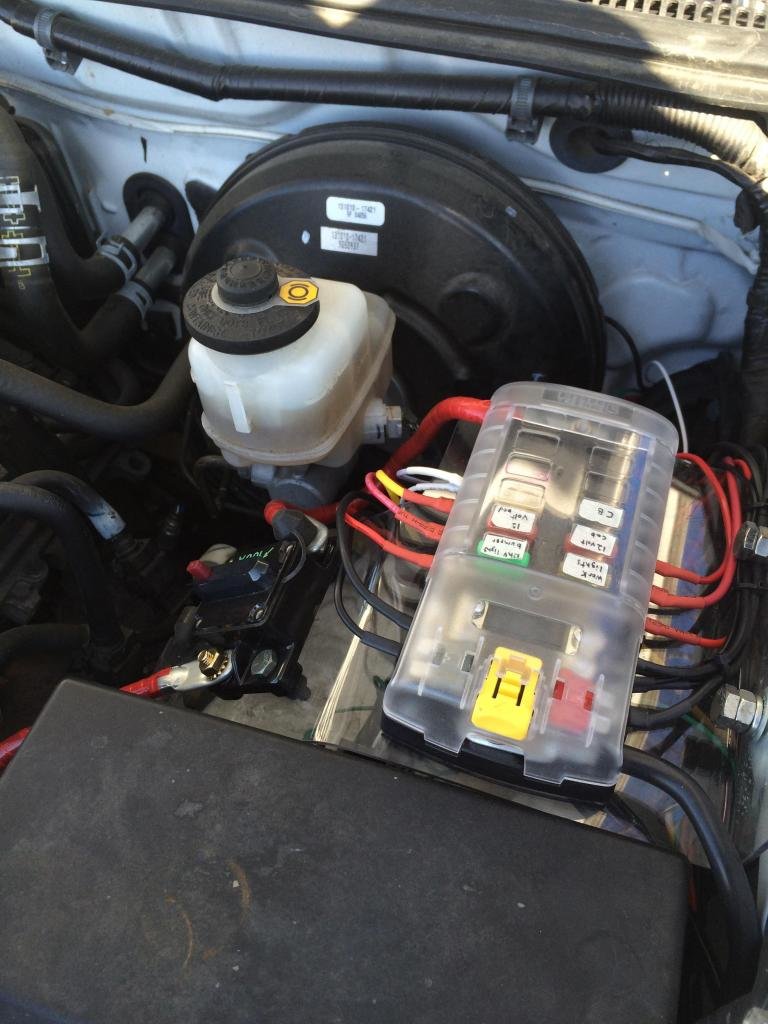

    Made from some scrap metal I had laying around. Simple Blue Sea set up. Easy. Added Relays on the side.

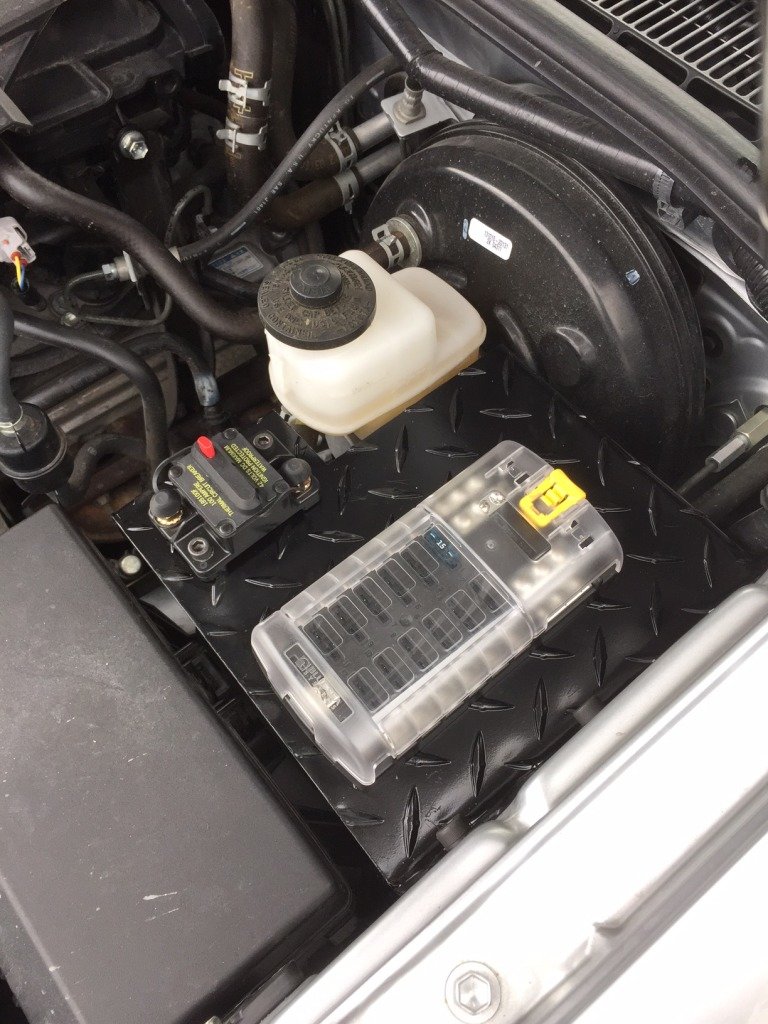

    I dont think I ever posted a picture of mine -
    D6BB2D35-D7DD-4141-97F0-9249D083A7A0_zps_d7b35fafc0c3d63335bd030dee6b8b3010208f45.jpg
    Dont mind the extra wiring sitting there.
