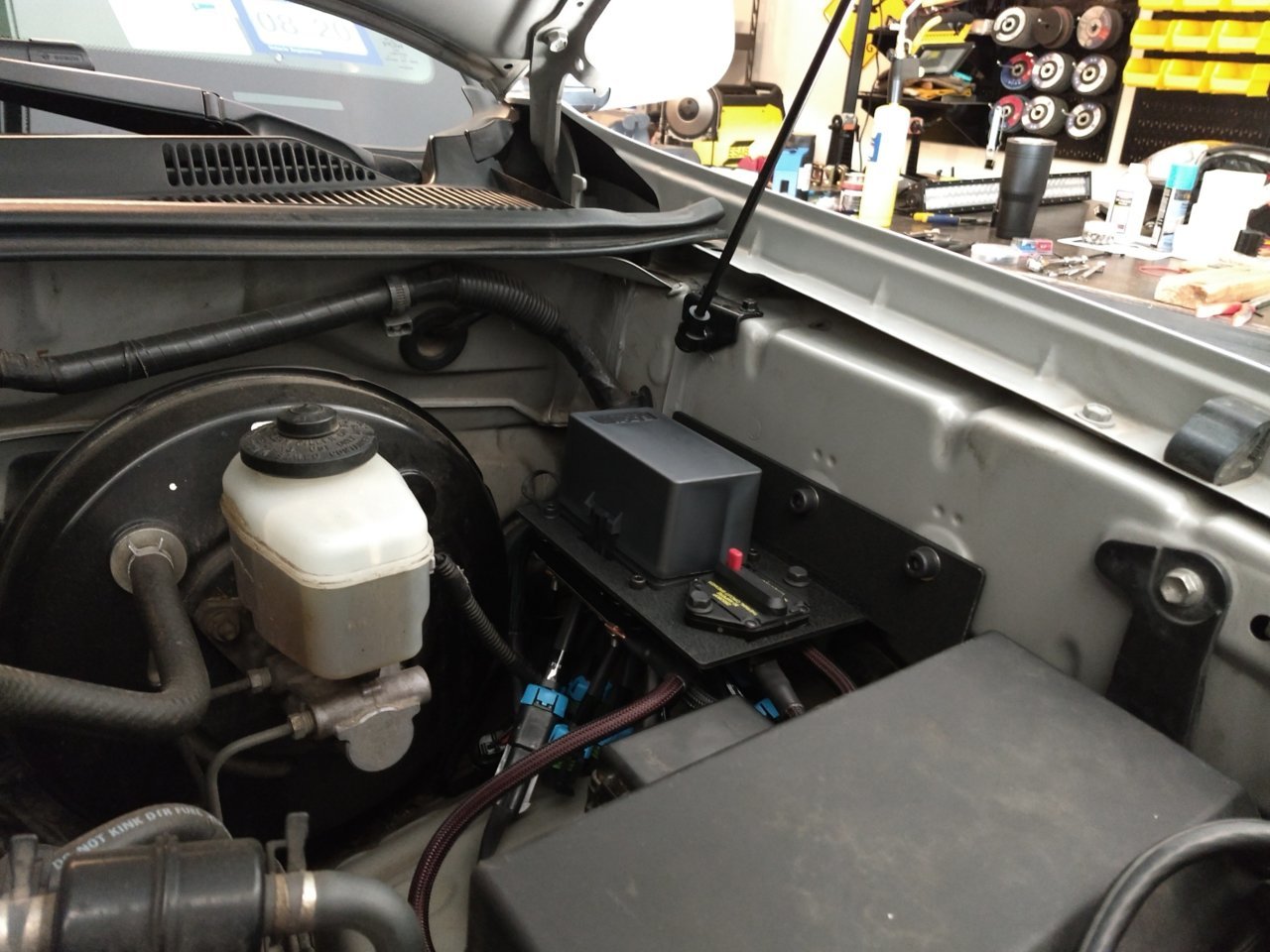

    I just realized I never posted it in here:
    I picked up an older style tray from a member on here, and it fit very well.
    Older Paranoid tray, fits a 2017 Sport MT.
    I wrapped my hose coming out of the clutch/master cylinder in some conduit (red) that I had for added protection and used a zip tie to keep it below the tray.
    I was able to fit a 6 circuit Blue Sea fuse block, a negative terminal buss, and 4 relay holder

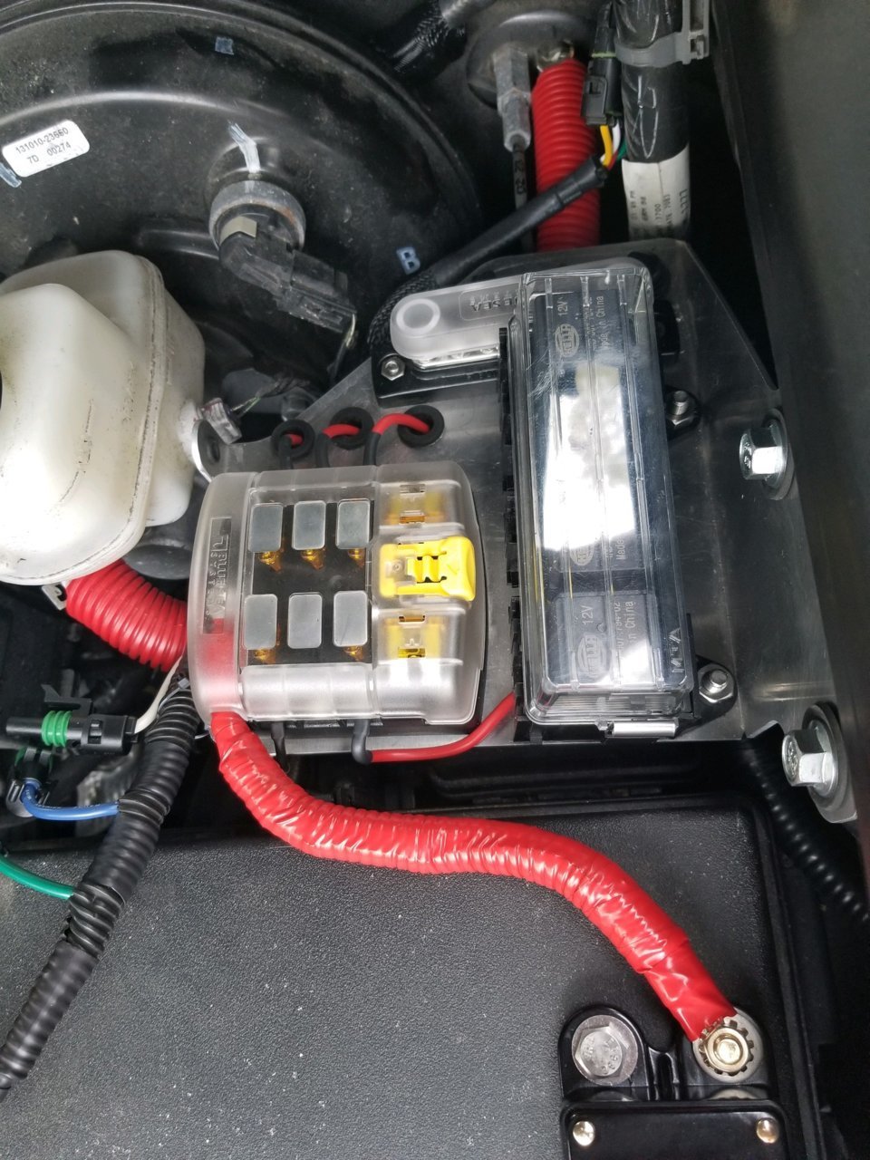

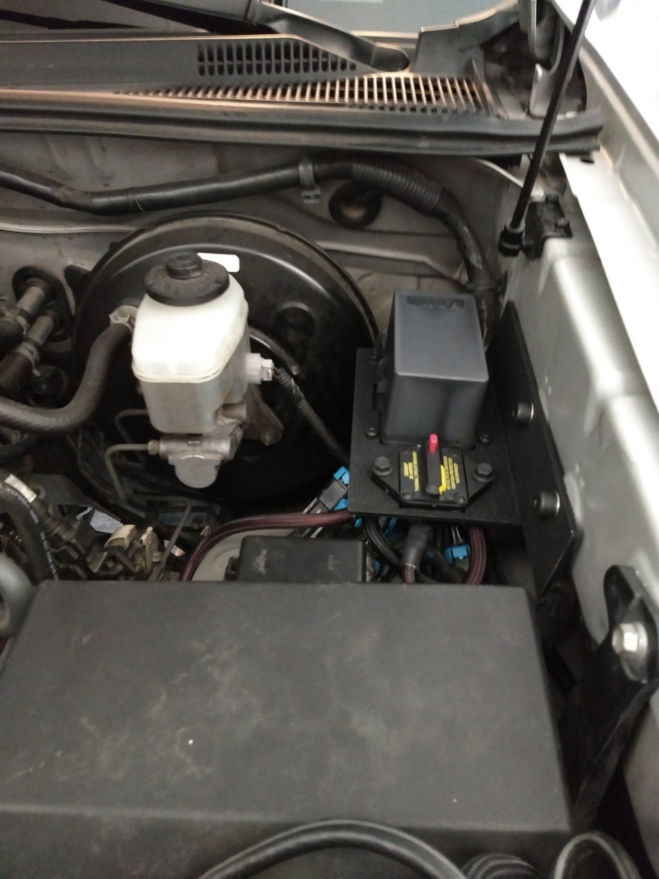

    Just finished this morning.

    Hella also sells a 7 micro relay version that is the same size as the 4 mini relay holder. Part number HELLA H84988011.
    Also Del City has the same ones for like half the price. Hella just re-sells the MTA products, (notice how its stamped MTA on the lid). Here are the Del City links to the 4 mini relay and 7 micro relay holders.
    https://www.delcity.net/store/Mini-Relay-Holder-Kit/p_821853.h_821854
    https://www.delcity.net/store/Mini-...eFNGIcL1Si_k270Mqbfez0XZdWFK6wUwaAuUSEALw_wcB

    No exposed terminals on top, I like that.

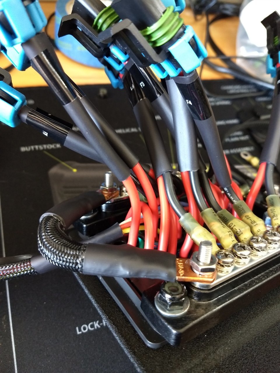

    Thanks! Here's where the magic happens. :D

    Very well done!

    Super clean! That is a creative location for the buss bars. Nice work :thumbsup:
